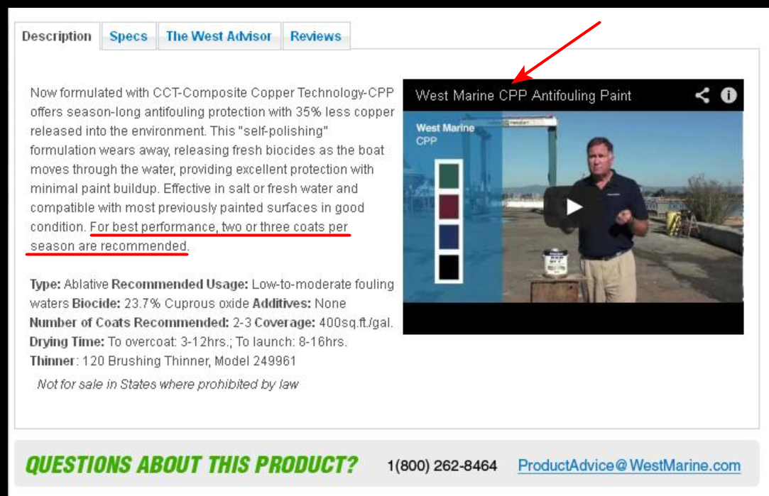

@thinwater , I was far too thin on backfilling in any info in my comments about people getting extended life for botom paint. I thought (and was mistaken) that reference had been made earlier to people in the PNW getting up to eight years of ablative life on a single coating.
It is my unwavering belief that there exist in the marketplace, certain bottom paints which, when exposed to PNW waters, have exceptionally long life expectancies. In all likelihood limited to ablatives.
It's either that or too many people are going along with the crap that sales groups are concocting to slap on the sides of antifouling paints :
The West Marine CPP which is shown above is what I am now getting 7 years out of two coats applied in one session of painting as opposed to their advice of every season.
If you :
  • do not have any barnacles adhering to the bottom of your painted hull.
  • do not have any sign of the tracer coat showing through.
  • and slime is easily removed by power washing.
................ then DO NOT TOUCH.
Wait for the next year's haulout and reapply this check list.

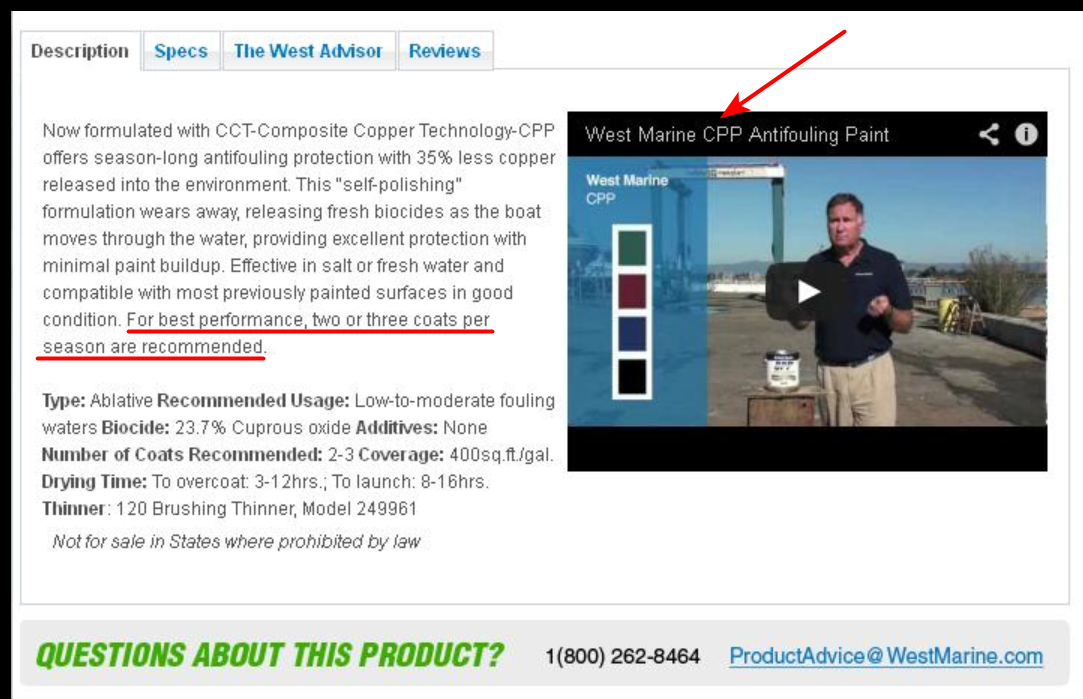

If you :

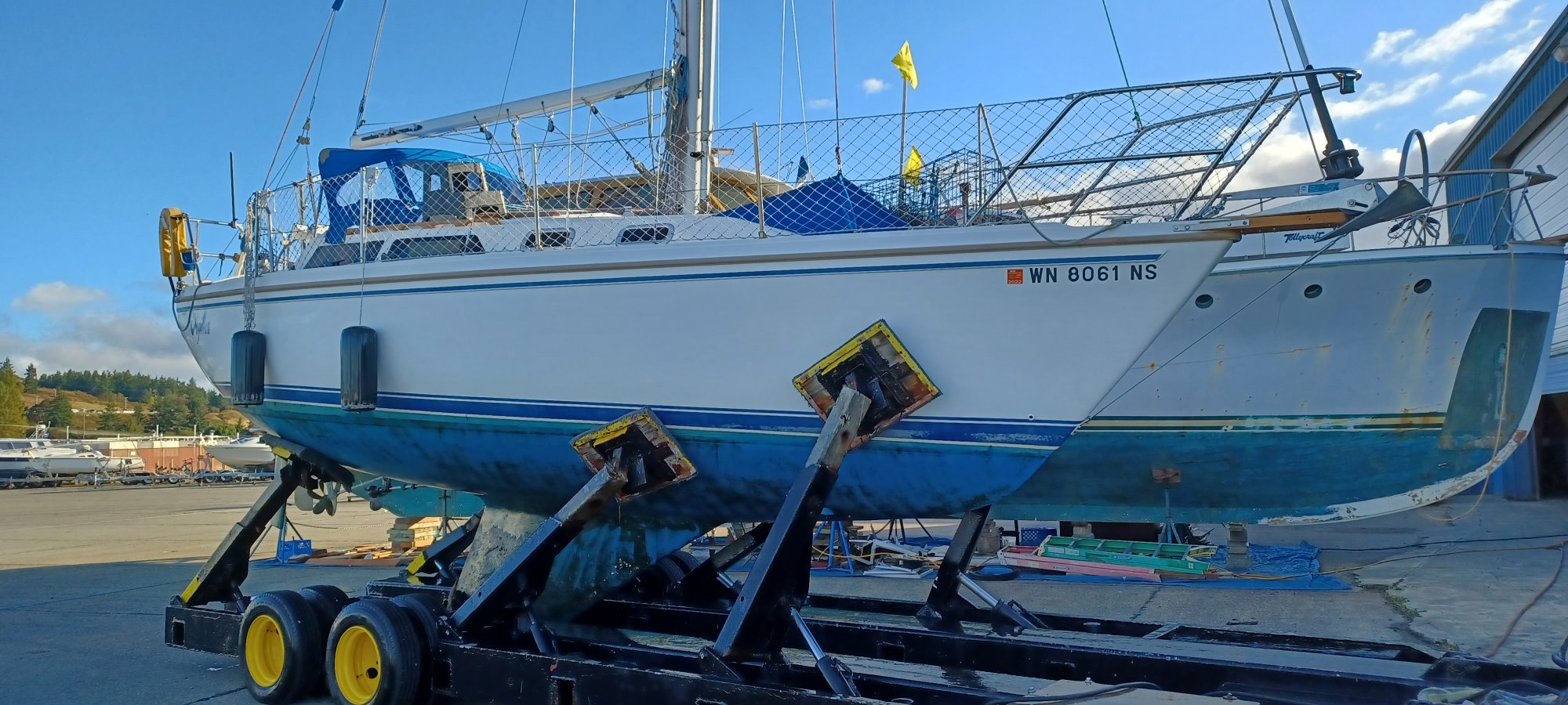

I think you may have been thinking of my post but I don't use an ablative. I use Trinidad Pro which is a hard modified epoxy and get 9 years in Oak Harbor, WA. I dive the boat spring and fall to clean the bottom and replace zincs. In that time, I get no hard growth on anything except for the uncoated prop and shaft and a few rough spots on the lead keel. This is a photo of Papillon fresh from the water. It had been 6 months since the last cleaning and 9 years from the last haulout.
