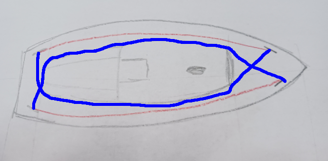

Something like this, using Gary's first drawing and his existing cleats. If the lines can't cross in the stern because they would cut into the cockpit, then a hard attachment point would be installed close to the coaming. Ideally, there would also be a hard attachment point on the forward end of the cabin above the deck to keep the jackline raised off the deck. If the tether didn't allow you to reach the foredeck, then there would be a separate system up there that you clip into.
Mark

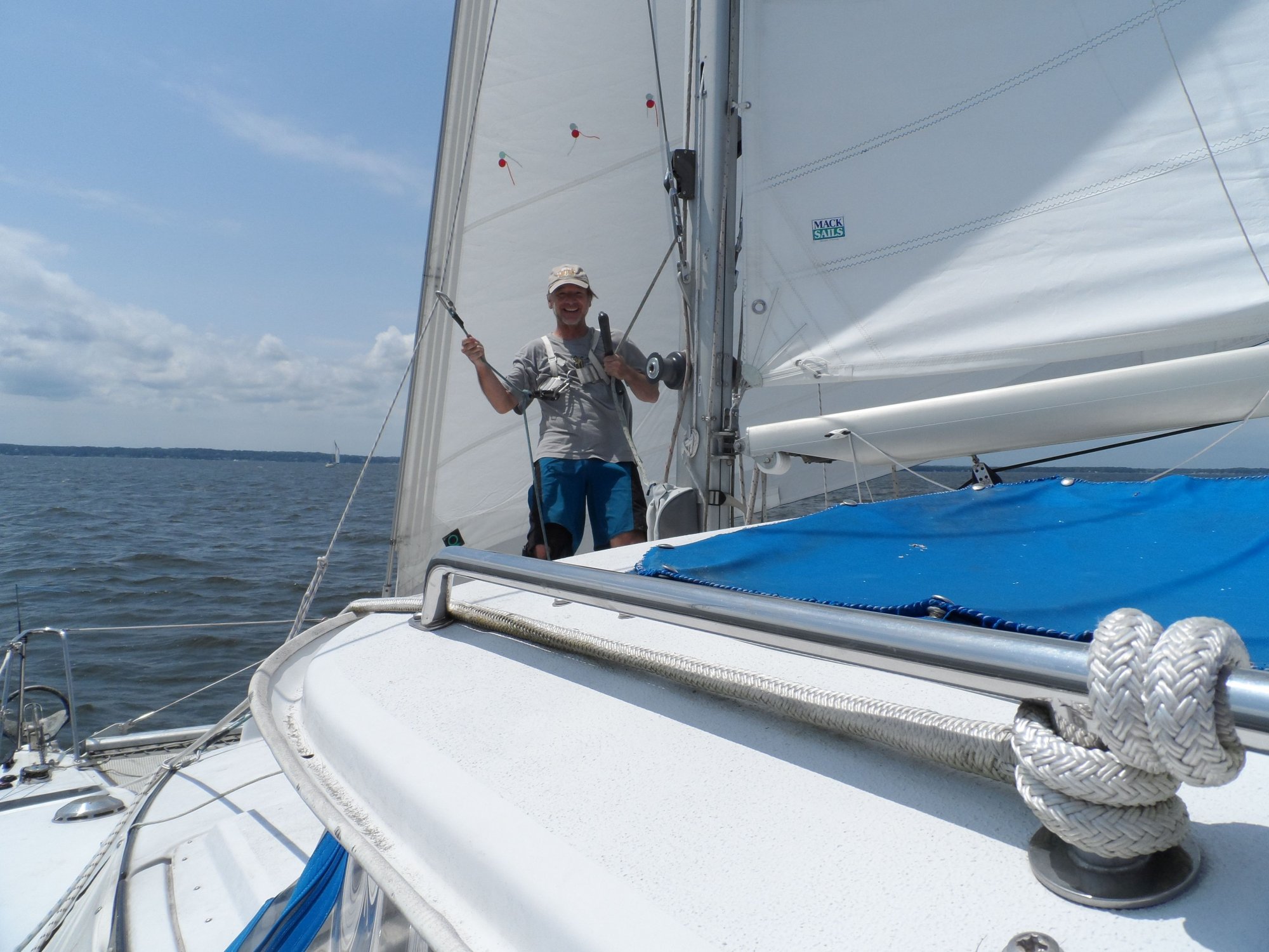

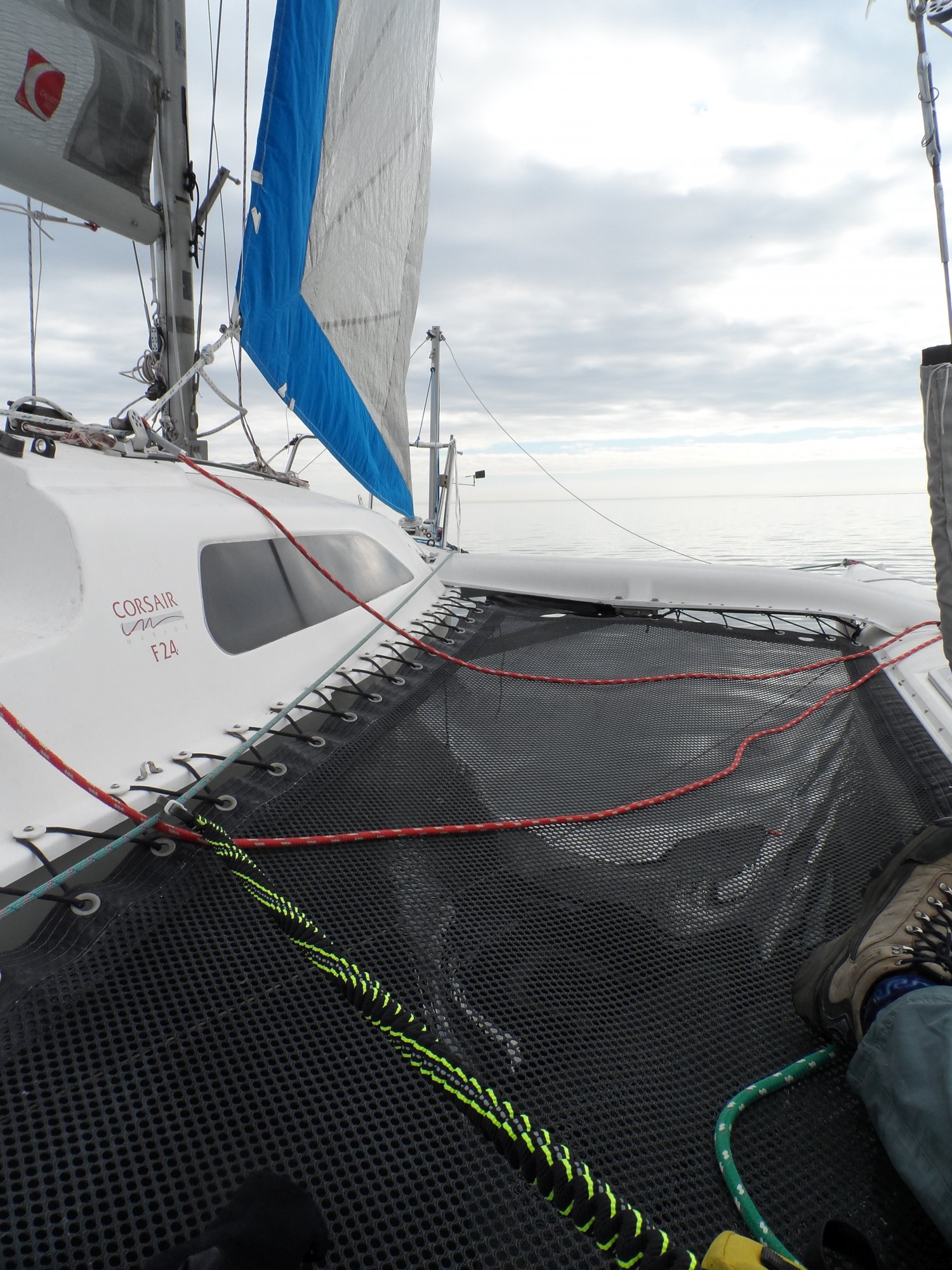

The cabin top can be a problem, but along the edge is usually safe. Tight along the sides works on some boats, depending on shroud locations.
Not anywhere I would put my foot. (You never walk on lacings.) Yes, it is under an outhauler, but when on the windward side, that is completely slack and just slides out of the way with you. The jackline ends just forward of the forward beam; The long tether will reach the bow from there. Out of sight, forward of the beam, is a 6' x 6' safety net that protects that area. I can clip short to the pulpit. Why would I be in that area? The bow sprit folds, and it's not that unusual to be up there folding/unfolding the sprit and removing/setting the reacher in big waves. This set-up protects the bow work area. Clip the jackline, walk forward, clip the pulpit with the short tether, and do what needs done. No fussing, no un-clipping and re-clipping, nothing to trip over. Easy peasy.
One is next to a handhold, and from there forward it is off the deck in a non-traffic area. Not underfoot and much better than side-deck. The other is vertical (and also keeps sheets off the mast winches--that is the real purpose). I can lean snug against it when winching in a reef.
It's all about figuring out what works on your boat.
