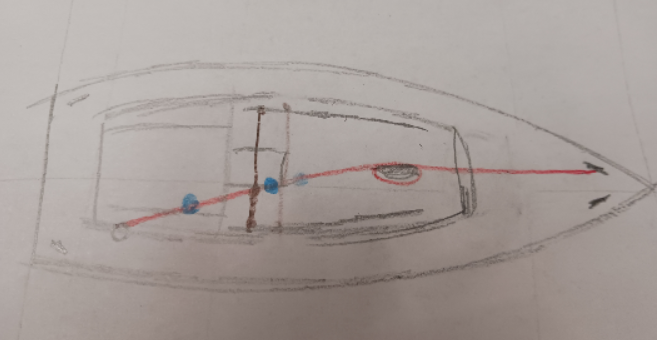

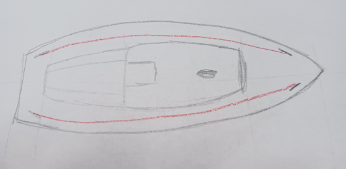

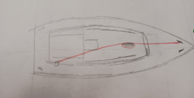

More important is to make a jackline system where the line is never underfoot to begin with. Then that aspect is no longer relevant, and one can use anything appropriate. It isn't difficult with many boats to have the jackline running along a cabin top a bit off the deck. Webbing could be used for the area of the foredeck where the line may have to run.

Jacklines with line never underfoot: I find the concept is quite a good one, but in reality is hard if not impossible to implement.
Why?
Because if you put the jackline up off the deck, up on the cabintop, then when you do go up on the cabintop you end up standing on it with your foot! On my C25 I used to have to go to the mast to reef the mainsail and if there was a jackline up there where it would be in the right place to clip on to, I'd end up stepping on it! I didn't have a dodger on that boat which made it theoretically easier to rig one. With a dodger, centerline jacklines are much more difficult to design or rig, aren't they?
Gary's sketches in Reply #7 on page one of this thread are the best one could so. Good work, Gary.
Mark
colemj
Jul 13, 2004
1,119
Dolphin Catamaran Dolphin 460 Mystic, CT
Why?
I was thinking about them running alongside the cabin top, not over the top of it. Perhaps the term cabin top was bad and I should have used cabin side or something.
Mark

Something like this, using Gary's first drawing and his existing cleats. If the lines can't cross in the stern because they would cut into the cockpit, then a hard attachment point would be installed close to the coaming. Ideally, there would also be a hard attachment point on the forward end of the cabin above the deck to keep the jackline raised off the deck. If the tether didn't allow you to reach the foredeck, then there would be a separate system up there that you clip into.
Mark
Mar 26, 2011
3,999
Corsair F-24 MK I Deale, MD
The cabin top can be a problem, but along the edge is usually safe. Tight along the sides works on some boats, depending on shroud locations.
Not anywhere I would put my foot. (You never walk on lacings.) Yes, it is under an outhauler, but when on the windward side, that is completely slack and just slides out of the way with you. The jackline ends just forward of the forward beam; The long tether will reach the bow from there. Out of sight, forward of the beam, is a 6' x 6' safety net that protects that area. I can clip short to the pulpit. Why would I be in that area? The bow sprit folds, and it's not that unusual to be up there folding/unfolding the sprit and removing/setting the reacher in big waves. This set-up protects the bow work area. Clip the jackline, walk forward, clip the pulpit with the short tether, and do what needs done. No fussing, no un-clipping and re-clipping, nothing to trip over. Easy peasy.
One is next to a handhold, and from there forward it is off the deck in a non-traffic area. Not underfoot and much better than side-deck. The other is vertical (and also keeps sheets off the mast winches--that is the real purpose). I can lean snug against it when winching in a reef.
It's all about figuring out what works on your boat.
