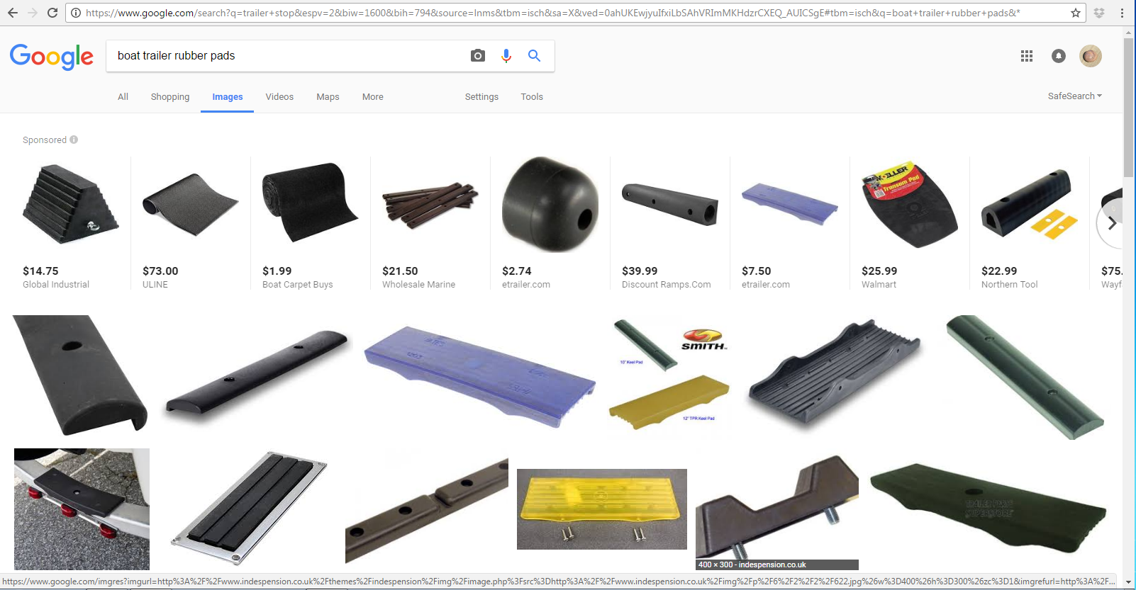

If you are worried about hitting your bow on the trailer, you could cover the questionable spots with rubber bumpers like this....
BTW: CD told me you were trailering to his place for some repairs. How'd that go?
13,019
Did a google for "boat trailer rubber pads" and got this...
