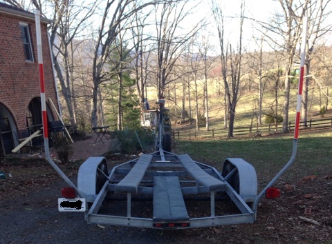

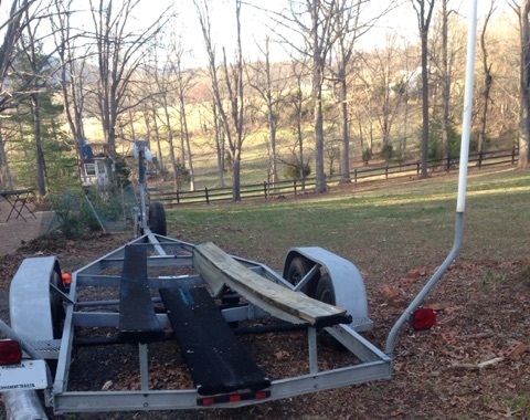

I spent a little under $100 on my trailer this weekend. Replaced and recovered the skids, put a little of Rustoleum's Galvanizing compound on a few rusty spots and added reflective tape to my goal posts. Looks almost new again.
All of the wood was tired but the keel boards were shot. They had been made out of exterior grade plywood and the ply had delaminated over time. I replaced the carpet with silver/gray instead of the original black because the gray was $0.12 less per square foot and I figure it went nice with the galvanized color of the trailer. The red/white reflectors on the goal posts go all the way around and are very bright. I went out last night and just with the light on my cell phone, they lit up.
Come-On-Spring!!!!!!!!!

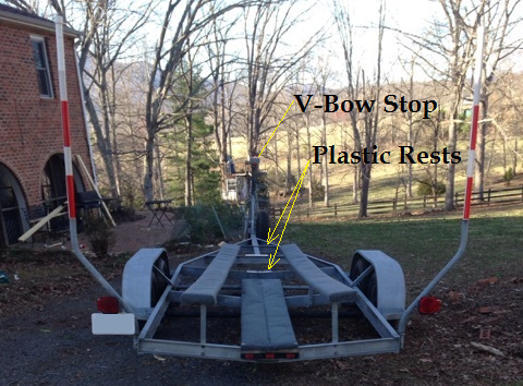

Rranger I noticed that there's no roller on the front of the trailer that the front of the hull rests on. I assume this trailer is for your H26. Did you just remove it to work on? I've got an H260 and there's a roller there. It's really a pain b/c it gets in the way when loading the boat. Granted I could get the trailer deeper in the water but that would require extending the tongue.
10,536
-na -NA Anywhere USA
JW I kept telling hunter to take that darn thing off as it hampered launching and retrieving. The biggest thing is to keep the bow from hitting the forward cross brace on the trailer. Other remedies was to remove and put delrin on the leading edge about a foot wide or put a long roller on the front brace. I found it did not really help to support the bow anyway which also rubbed paint and epoxy barrier coating off as well.

Thanks CD. I agree that it doesn't appear to really support any weight once the boat is on the trailer. I had my the lower part of my bow get gouged/scrapped one time will loading. It hit the gap between the roller and support post. Very annoying but got it fixed. With it removed, it seems that the boat would be able to be more "smoothly" retrieved. I've got rope tied along each side of my trailer to the guideposts. Acts a bit like guides themselves but really helps in a cross wind situation. You can get the boat about halfway in, shutdown and grab the upwind rope to pull yourself on up to the bow roller. Again though, that stupid roller on the bottom can hinder that once you get close.
I'm going to give some serious consideration in removing it before this season.

Yes it is an H26 trailer.... Does this diagram help?
I can get some better photos if it will help in your redesign.

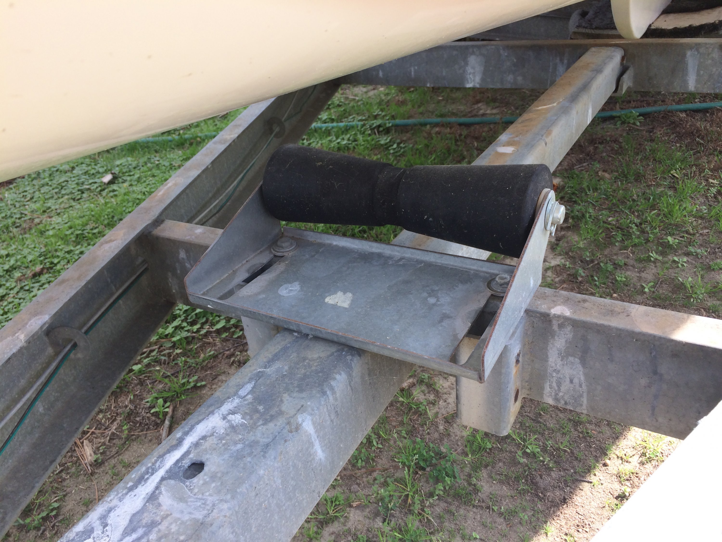

I replaced that God-forsaken roller and boat-destroying stem with this. It works well but maybe I don't need it at all. Great tip on lines from the goal posts to the trailer.

I've had those on other trailers I have owned. Do they really work? All of my experience with trailer sailboats is that I back up far enough to float the boat off of the trailer... likewise when I dock, I am deep enough that the bow enters the stop and then I drive the boat out and it sets down on the roller..... in your case it is not sitting on the roller so.... does your boat ever actually touch the roller?
Just asking.... not trying to be critical.
