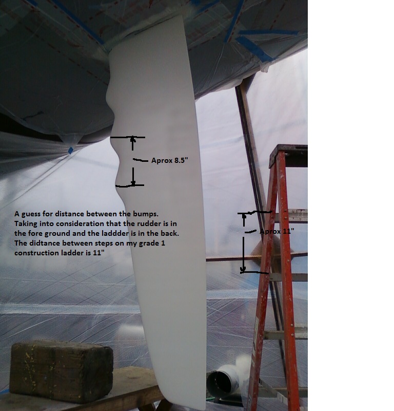

The bumps (tubercles) on the front slow/stop cavitation of the rudder when you turn or change the angle of attack of the rudder. (Cavitation= the air bubble that forms around the rudder. It creates more drag and the rudder stalls earlier.) Why? The humpback whales know.

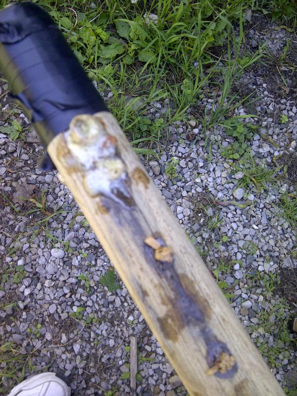

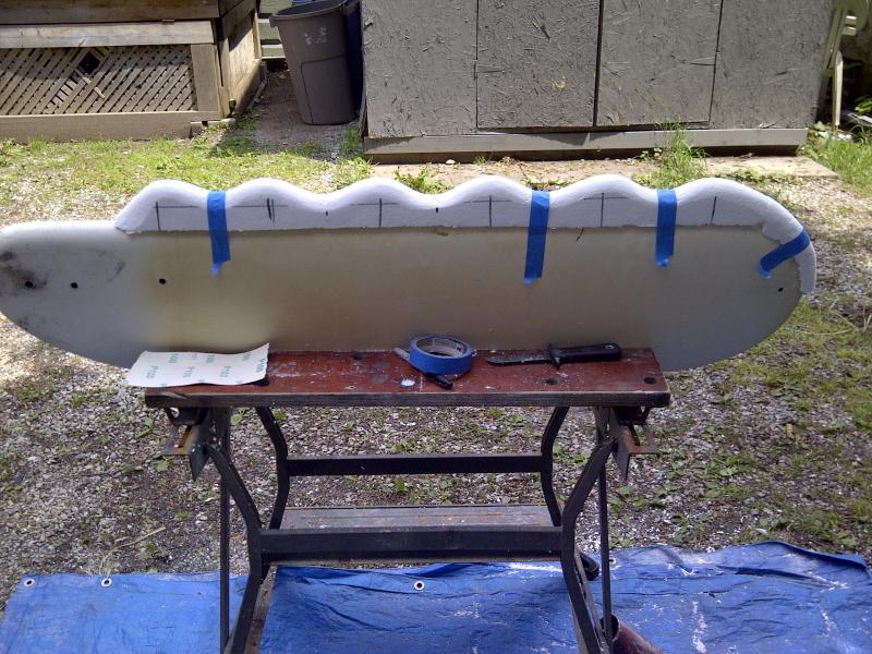

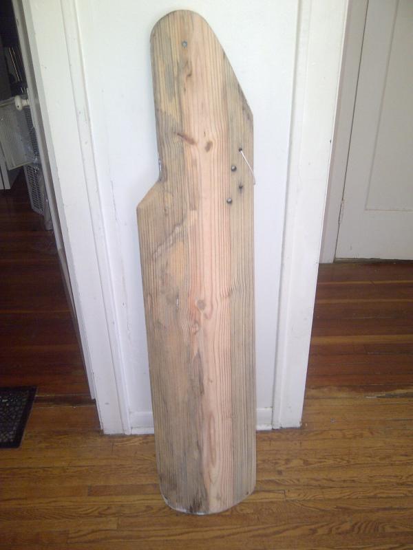

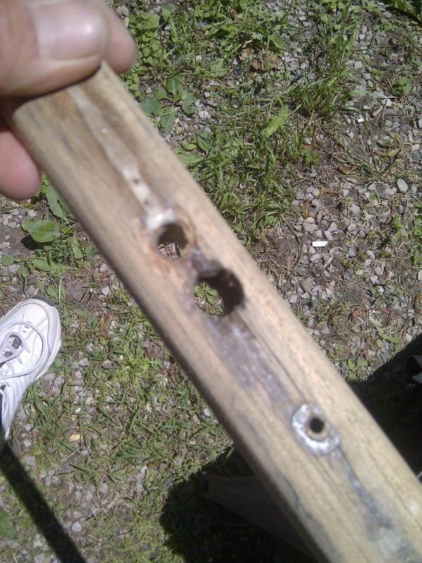

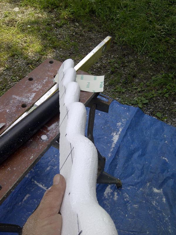

I have decided to do this modification to the stock rudder for my MacGregor 26D. If I Like it I may redo the other rudder as well. (The one I modified last year has continued to rot and fall apart. Don't make a rudder out of oak wrapped in fiberglass.) If these are to my liking I will make a dagger board with the tubercles.

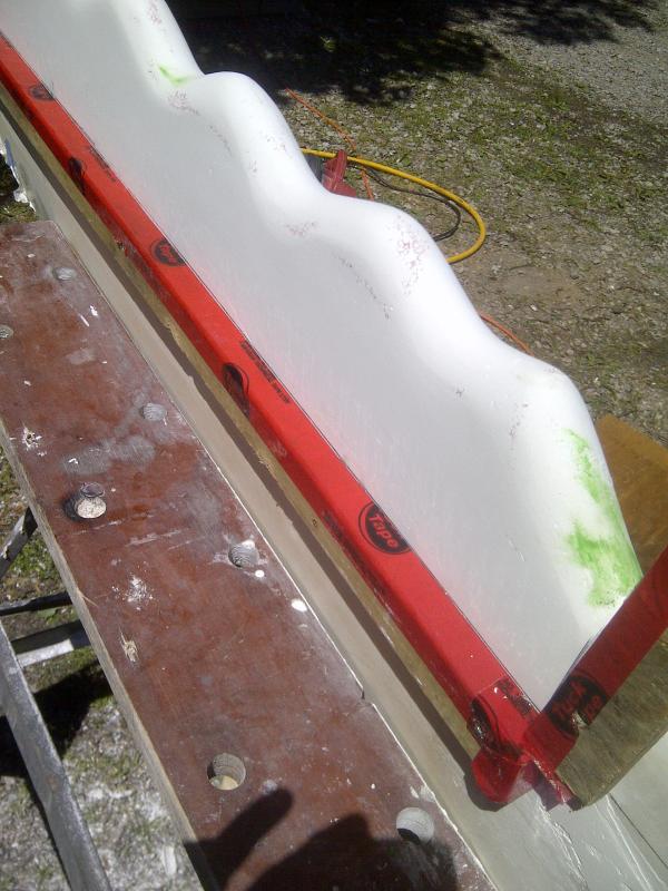

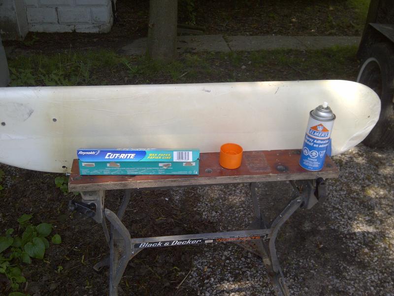

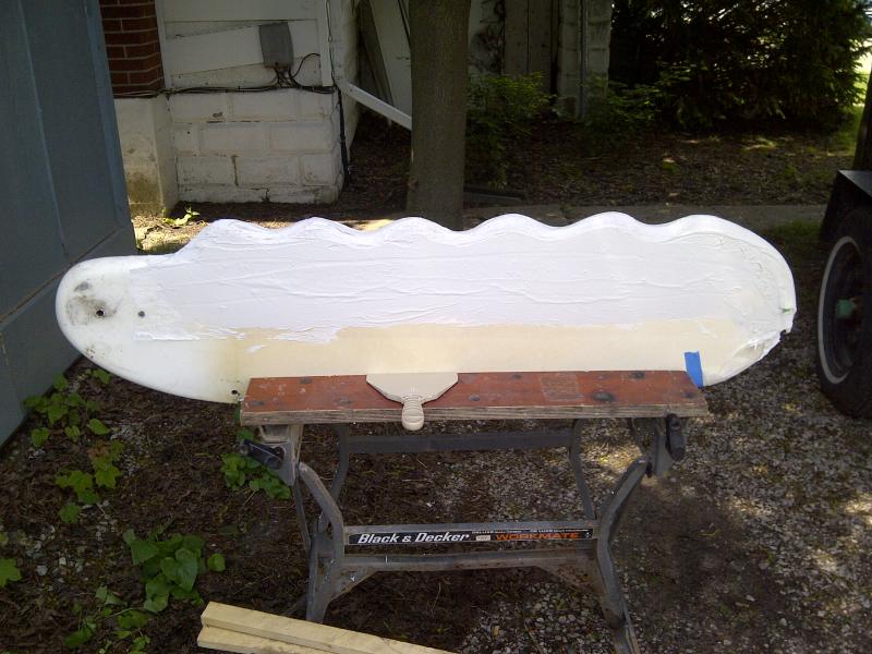

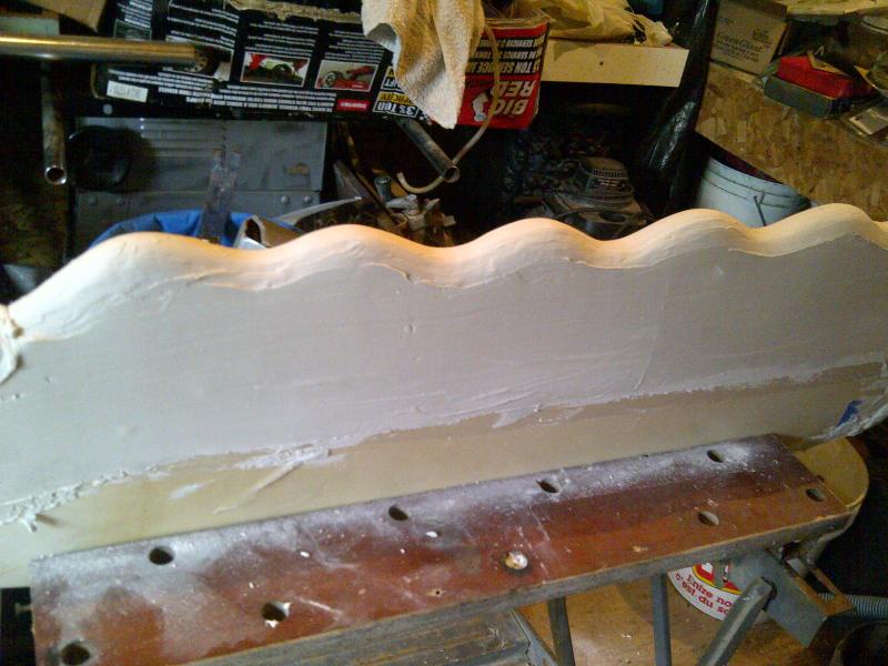

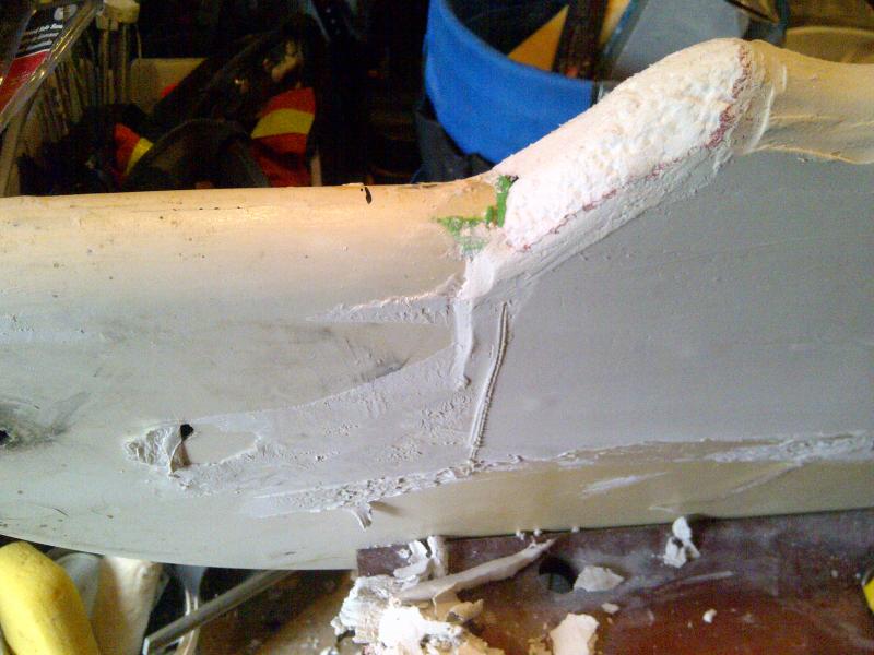

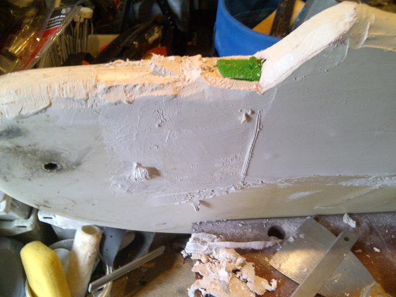

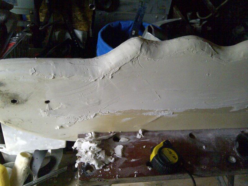

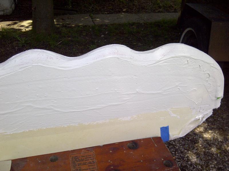

I have decided to make a fiberglass mold of the modification so I can make a few copies.

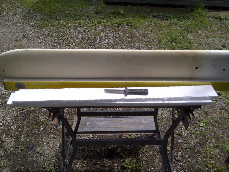

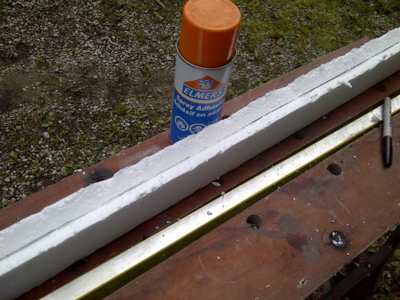

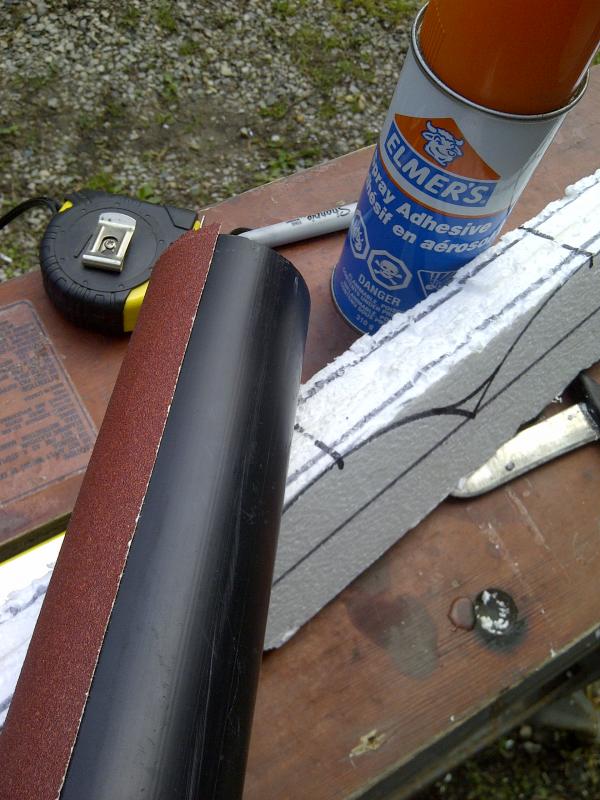

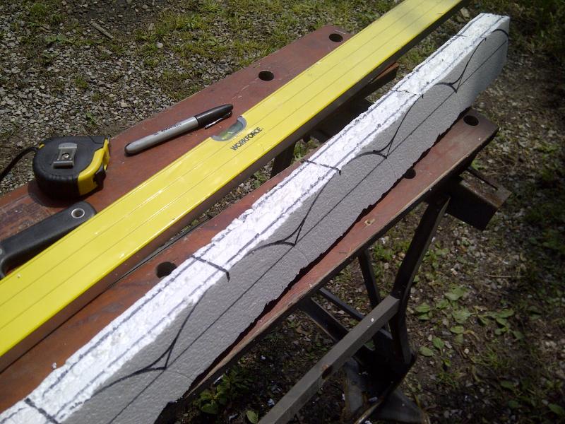

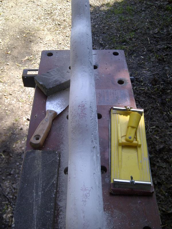

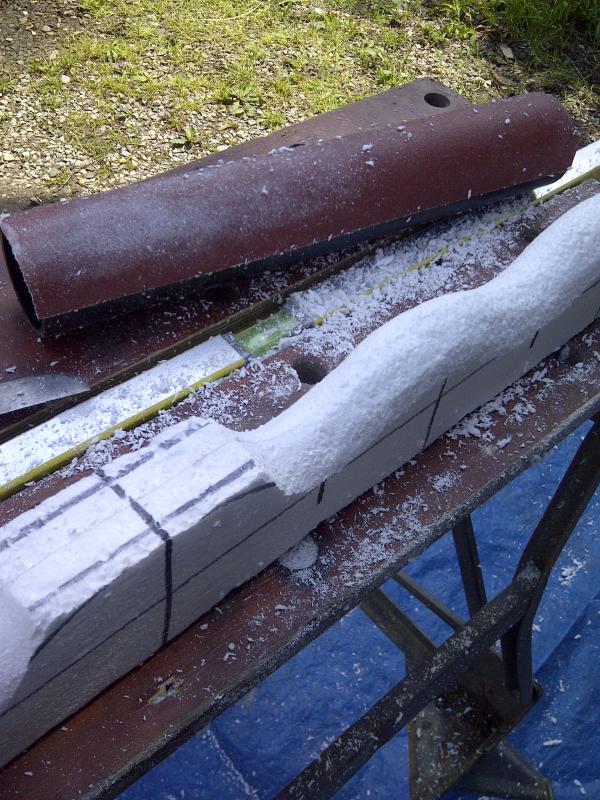

Materials so far: 3/4" open cell white Styrofoam (2- 3x36" pieces), spray glue, 100 grit sandpaper, 2" pvc pipe for sanding.

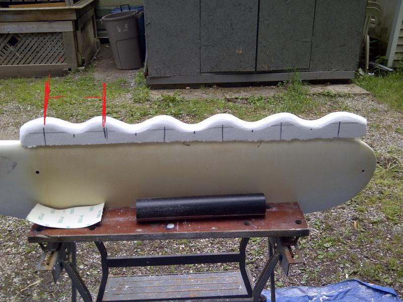

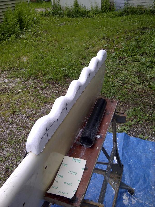

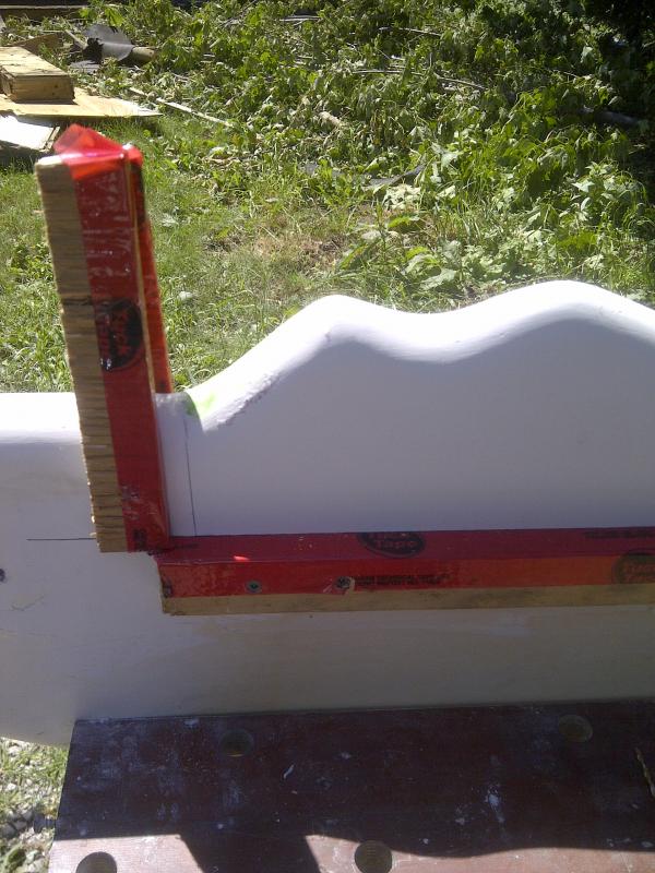

I cut the foam in 3" pieces and then cut a 45% angle along one of the 3' x 3/4" edges of each so when I glue them together they will form a V that will sit on the leading edge of the stock rudder.

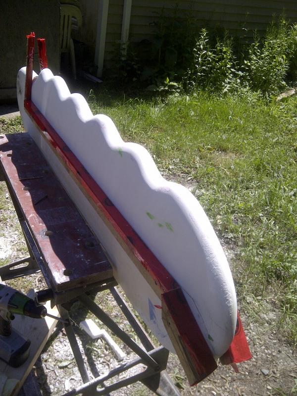

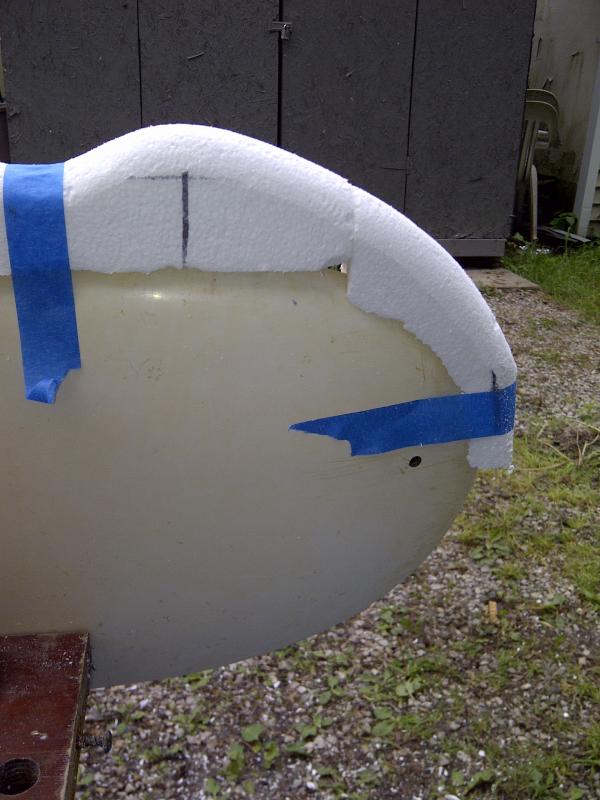

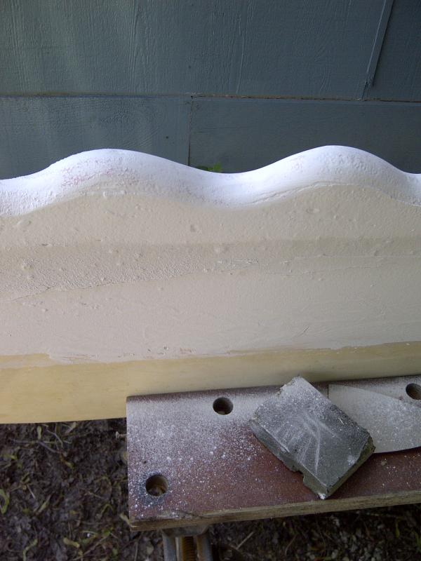

Here are some photos of how I'm making this mold.
