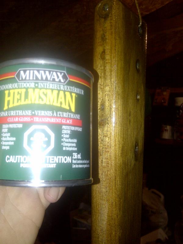

Picture is the tiller handle with 1 coat of this stuff. I gave up on the old can of Spar varnish. It finally did dry. 3 days later.
I put the 2nd coat on tonight.

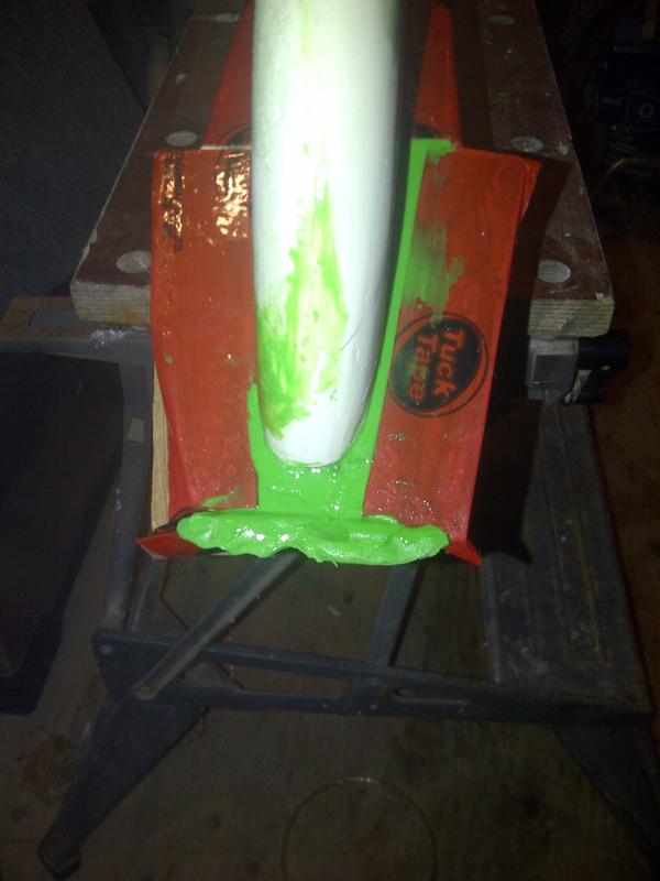

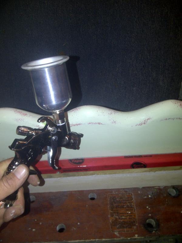

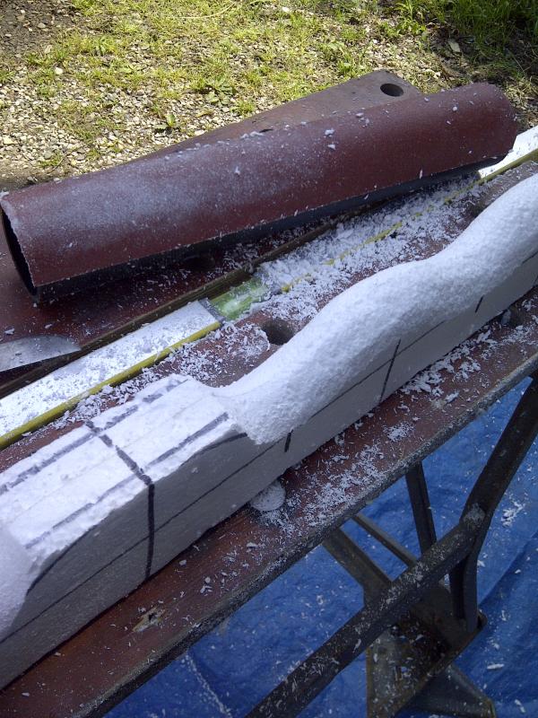

Here is a few pictures of the rudder.The last PVA shot has about 20 thin sprayed coats. Very thin coats. That stuff is like water to spray.
The last picture, I started cutting my glass before hand. I figure 3 layers should do it. It is a heavy weave. I've no idea how the weight is calculated with fiberglass.

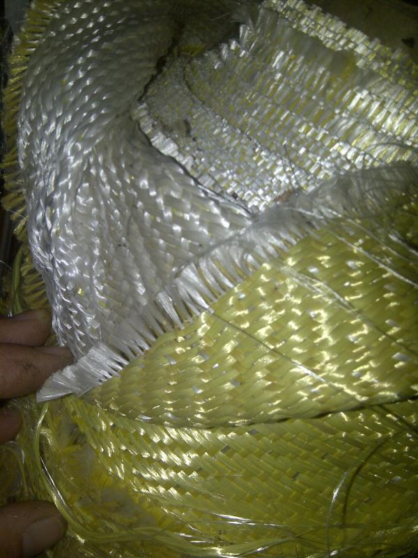

That is some thick weave. I would suggest a fine weave if you can take the time to find it. Heavier weave is not as strong as multiple layers of a tighter, lighter weave. This is a neat project.
Nov 23, 2011
2,023
MacGregor 26D London Ontario Canada
I have some thinner weave stuff but was planning to use it on the part not the mold. I plan to use 2 layers of thin weave and a layer of thicker kevlar and glass. Ill get a picture of the kevlar stuff tonight.
I'm hoping to use a vacuum type process to get allot of the resin out for more strength.

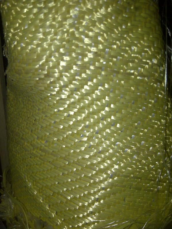

Here is a picture of the Kevlar and glass weave stuff I have. It is kind of neat as it has the glass on one side and the Kevlar on the other. So I imagine it is triple thick. It is hard stuff to cut with scissors!
I put 3 more cats of PVA on tonight. I'm calling it good enough. I'll spray on the first few coats of black gelcoat and wax. Then give it a brush coat and off to laying up glass. Hopefully tomorrow....

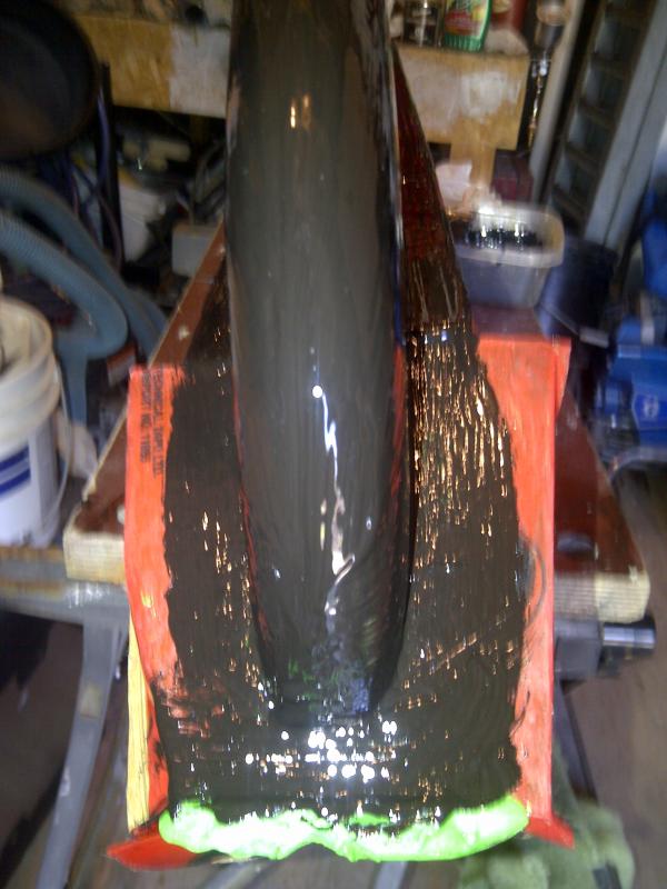

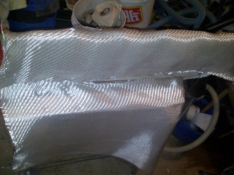

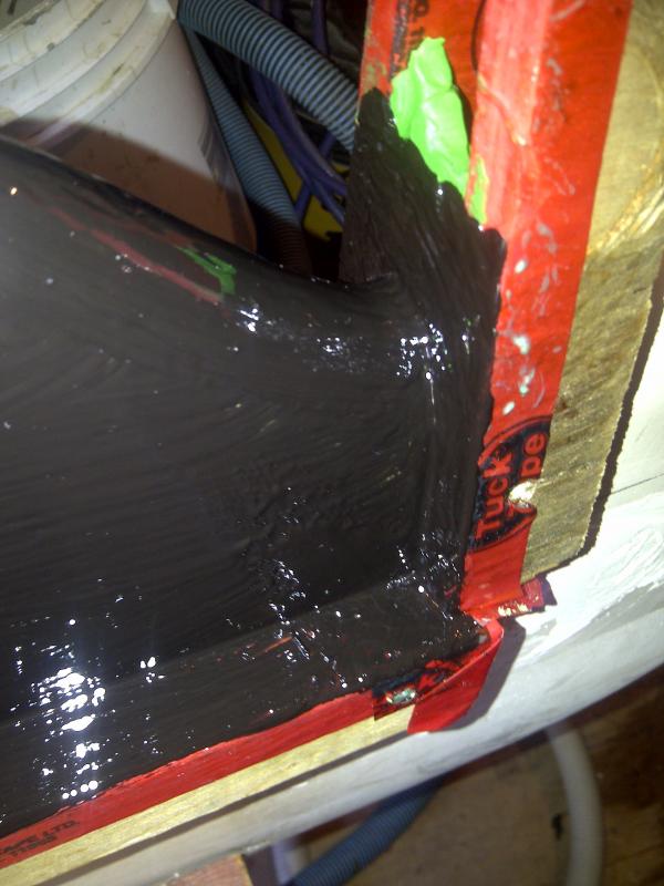

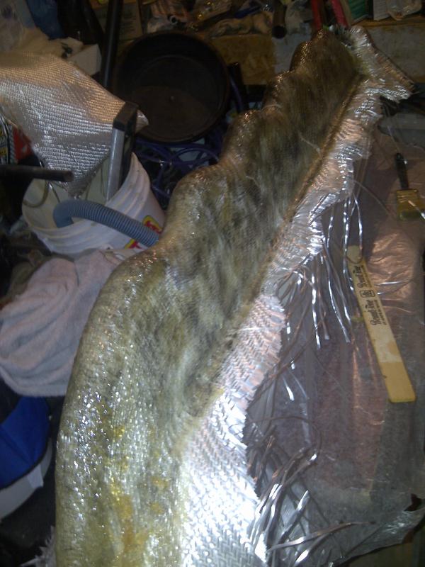

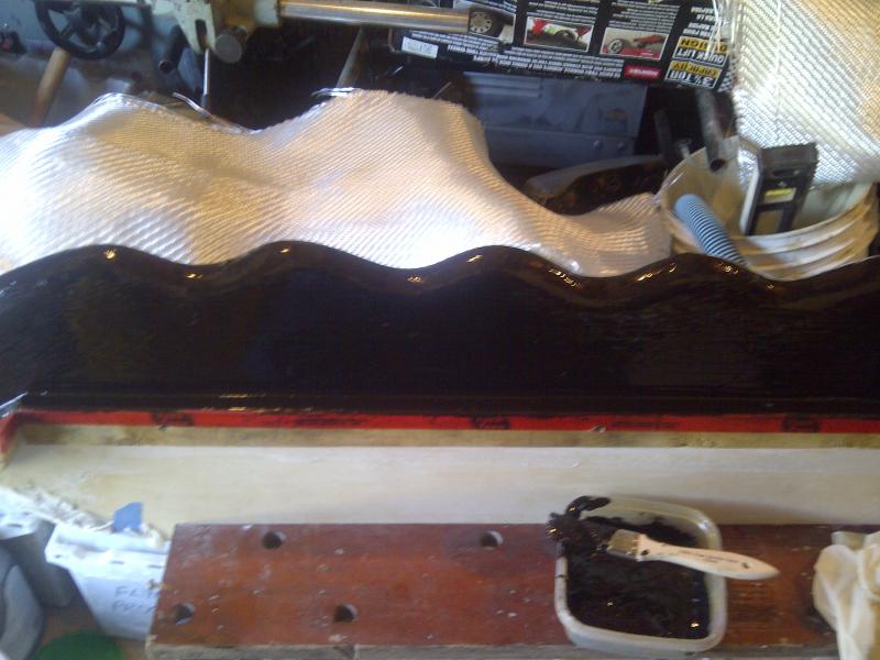

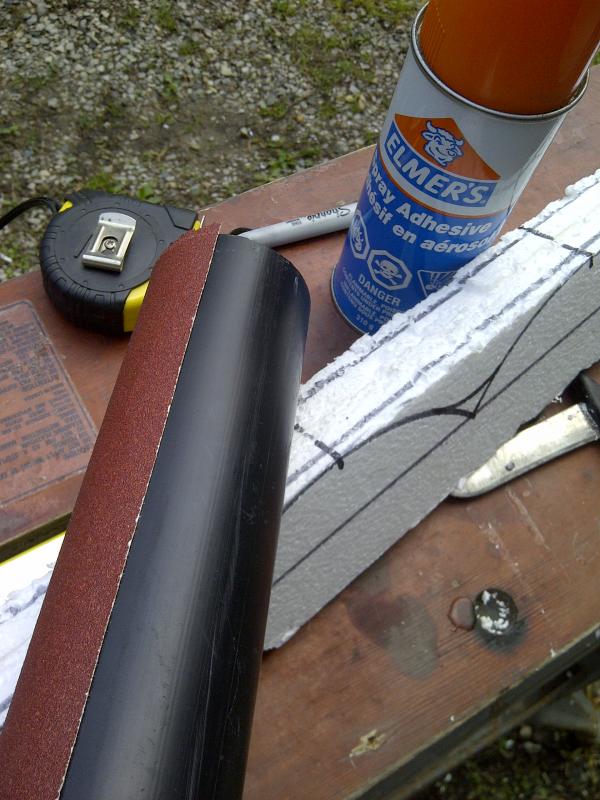

Got some time this afternoon to fiberglass the rudder plug. I used Black gelcoat because I have a bunch of it and planed to make the molds with it. I mixed liquid wax into the black when I mixed the hardener in. I decided to brush it on instead of cleaning my spray gun for an hour after each sprayed coat.
The cloth didn't go as well as I had hoped. In tests before hand it fit very nicely on the rudder plug and didn't look like it would be a problem with fitting to the bumpy shape. In practice the first layer went on well. The second layer was a pain in the but! It didn't want to sit in the hollows like the first... I did use one big sheet for each layup. In hind-sight I probably should have let the first layer dry then attempt the second. I did let the gelcaot kick before I went at it with the cloth.
Here are some pictures of the process. I forgot to take one when I finished...

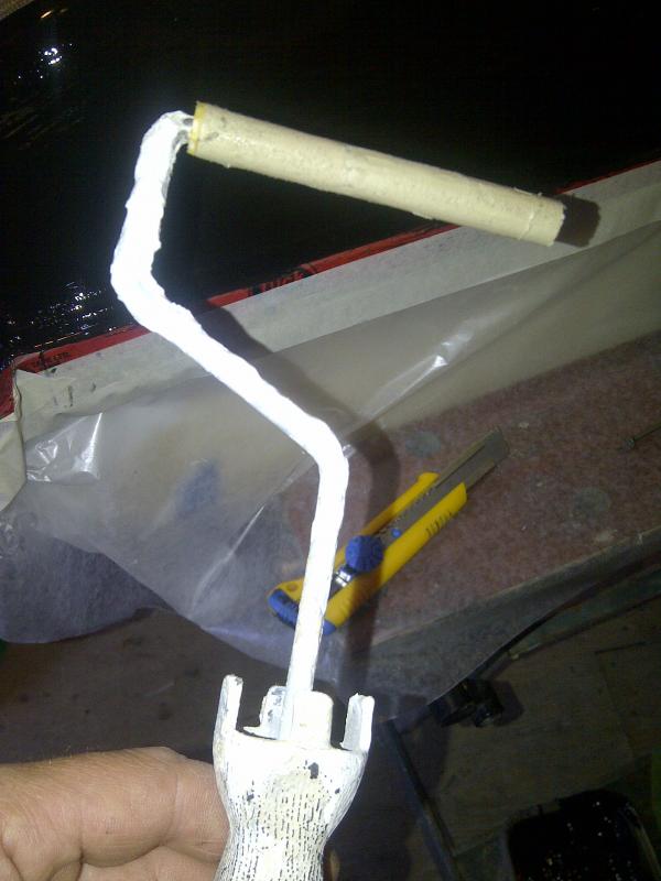

Last picture is a tool I made.... I just cut the foam off a wheene roller refill to use to squish the air out of the cloth.

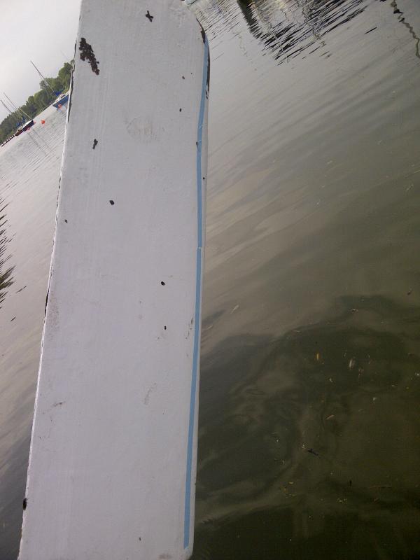

Chris I tried this on Wed night for the race. (1st)
It removed the vibration from my rudder! I used 3/4" painters tape.... along the curve of the foil. It was very light sailing conditions. About 1-2k and that was pushing it.
I will try this again with a plastic tape that wont get soggy and fall off like painters tape.
Here is a picture. Not to perfect in my attempt to get it on strait. I was hanging off the back and I didn't want to fall in. Not enough time to get a club tender boat to apply it before the race.

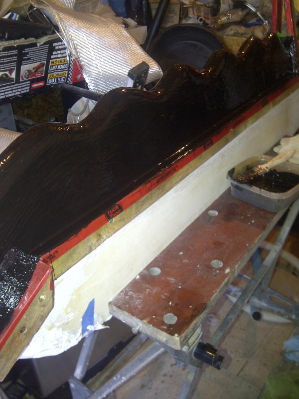

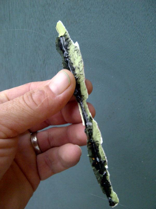

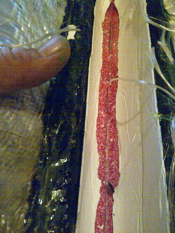

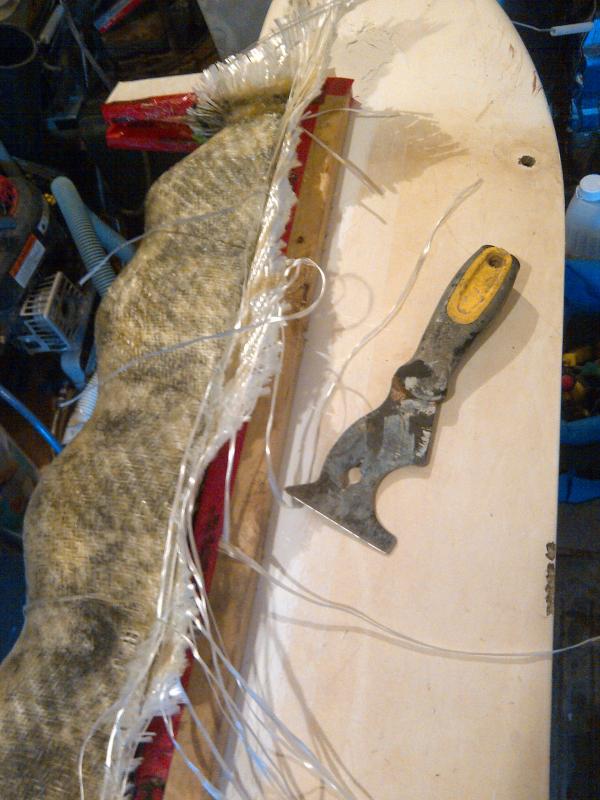

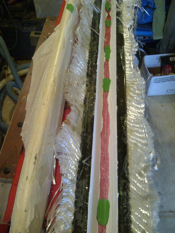

I got it off. Kind of. The plaster and foam remained in the mold. So I picked out a bunch of foam and filled the mold with water and rags to moisten the plaster. I'll spray it clean with the hose tomorrow.
I couldn't find the plastic wedges I have to pop the mold off so I used a 9 in 1 tool to get it started and a plastic putty knife to get it the rest of the way.

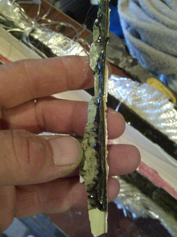

I'm not too happy with my job on the edges. They didn't turn out right. (I think I went at the fiberglass mat part too early after the gelcoat was done. About 20 min...? Or I played around too much at the edges trying to get the glass to sit in there nice...)
The green in the pictures is plasticine and the red is the foam. I painted the foam red to be able to see the edge of it when I was sanding the plaster and removing it. I kind of expected it to stick in the mold.
The chunk I am holding is supposed to be a 90* edge! Fail! It's not too important.

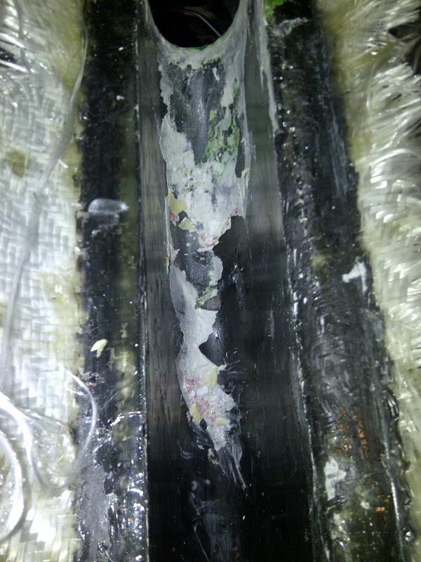

I'm not sure how it's going to come out... I cleaned a bunch of the plaster out today. (I only had about 15 min to work on it.)
The edges are not what I wanted but that's ok. (Learned something there! Don't touch the gelcoat until the next day. Or until its very dry. I tested it on the side of the rudder... It was thicker at the bottom....)
The edge is just there to act as a lip. It will be cut off anyway. I'll just have to make it smaller or do some fancy gelcoating to fill and sand...
I can't tell yet what the rest looks like. I couldn't get all the plaster or PVA out yet. So it is soaking with rags and water again. Here are some pictures.

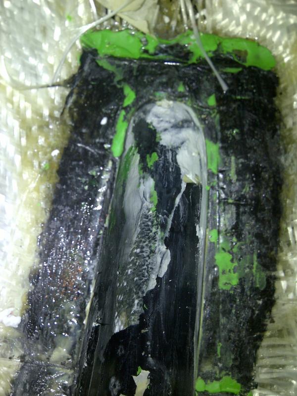

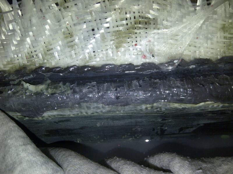

Well I tried to get the PVA and plaster out tonight. I got most of it out.
Unfortunately I don't think the mold is useable. I really made a mess of the gelcoat when I added the fiberglass. Too soon! There are spots that are rough and uneven. I may be able to sand them down and fill the low spots.
I'm not sure it's worth it at this point.
I can probably knock off another faster.
I have a busy week and plan to do some gelcoat work on Topiary.
I have a laz hatch to make (copy) and a bunch of gelcoat and hole filling to do on the topside.

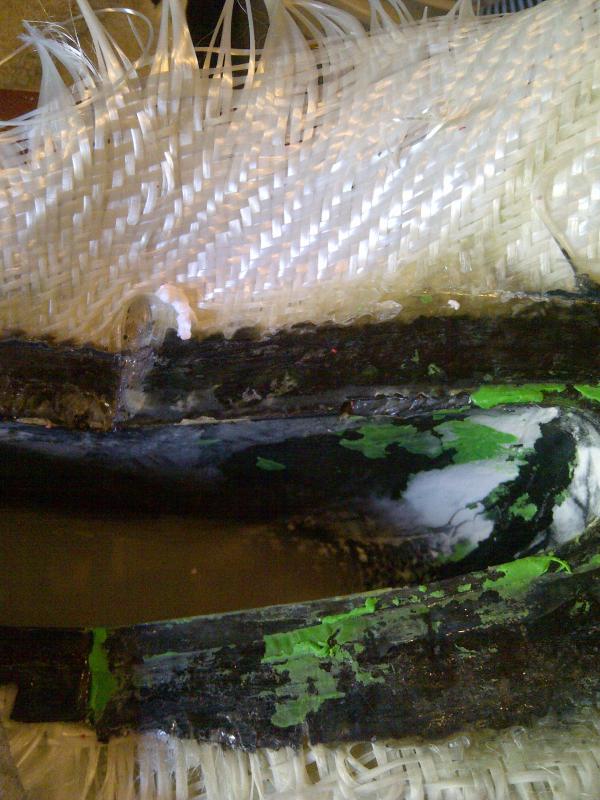

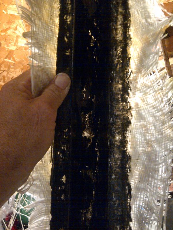

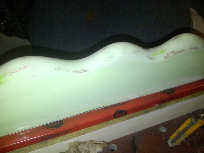

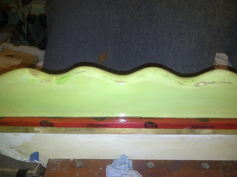

Here are some pictures of the light coming through the mold ware I was a "little too aggressive" when I was adding the glass. (They are smooth but you shouldn't see through it. I did put the gelcoat on pretty thick.) A couple of shots of the PVA stuck on very well.
I might lube the mold up with Vaseline and make a plaster cast to work from again. That way I can make the new mold a bit thinner and more hydrodynamic. Or just less blunt.
So all is not lost.

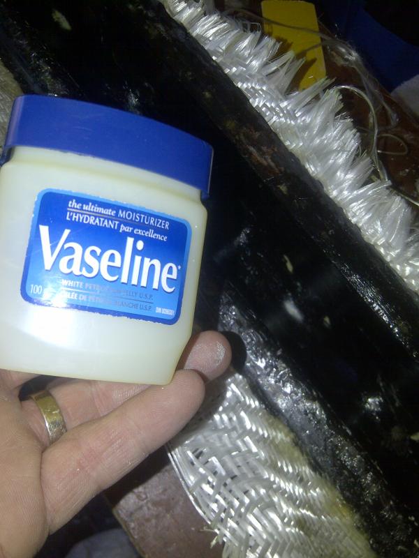

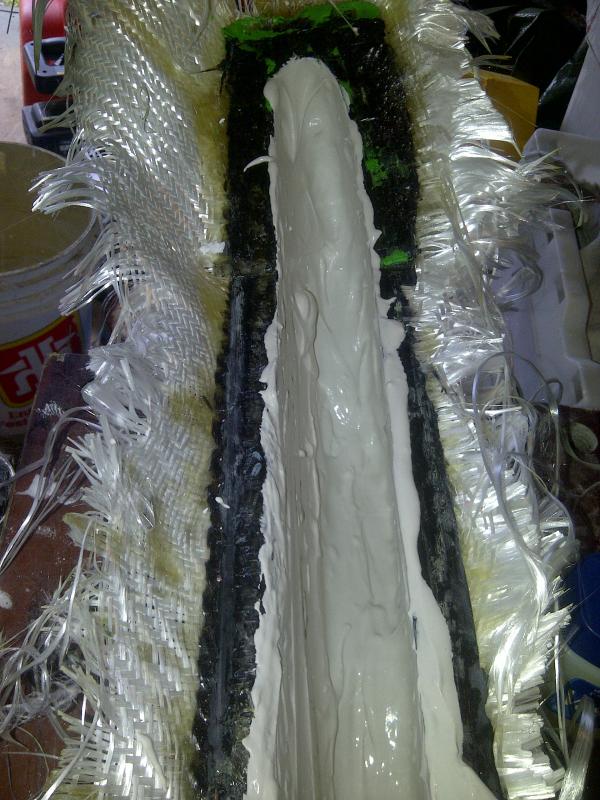

I decided to give the mold a go at making a plaster male that I can re-shape and start again from.
So I got out the Vaseline and gave it a good lube up. Then mixed plaster (CCG 45 drywall mud. Very hard stuff to sand.) I mixed a thinner than usual batch and coated the sides and the bumps of the mold. This thin coat is thin so it doesn't have bubbles close to the surface.
I will add more plaster and add some burlap to it to help hold it together. Probably fill the mold in 3 pours so it doesn't crack. The plaster shrinks a bit when it drys.
I mentioned before I want to make the mold thinner or less blunt. I will add to the male plug after I get it out of the mold.
Nov 23, 2011
2,023

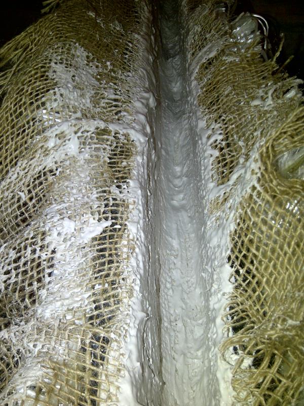

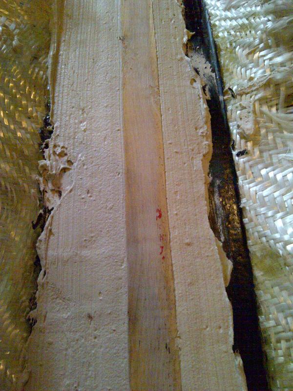

Mmm Vaseline... Messy stuff. I forgot to put gloves on too.

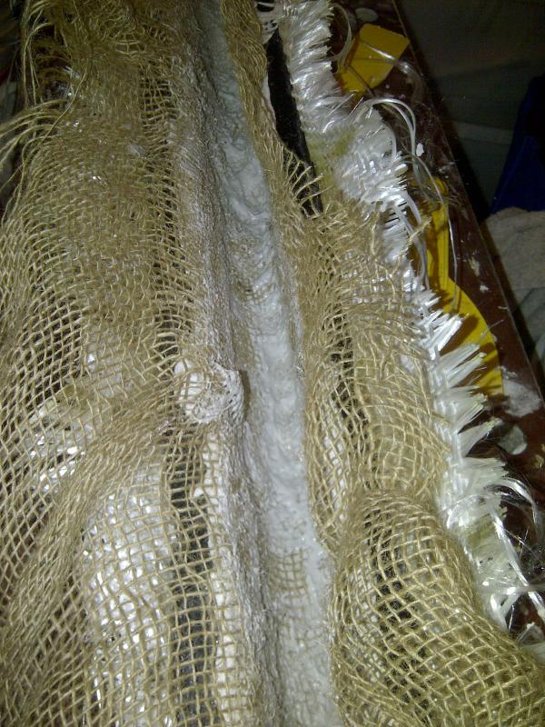

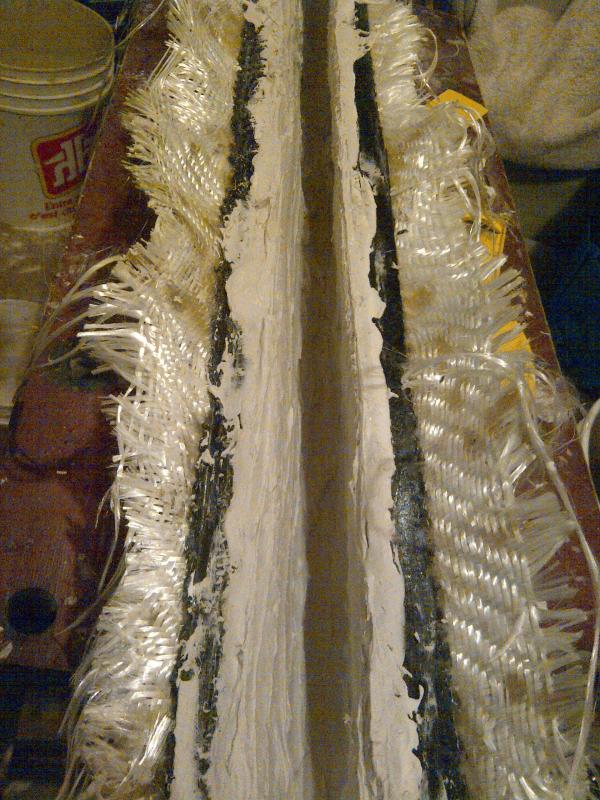

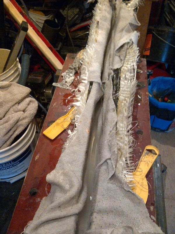

Well not for the plaster. Here are some pictures of how it is going.

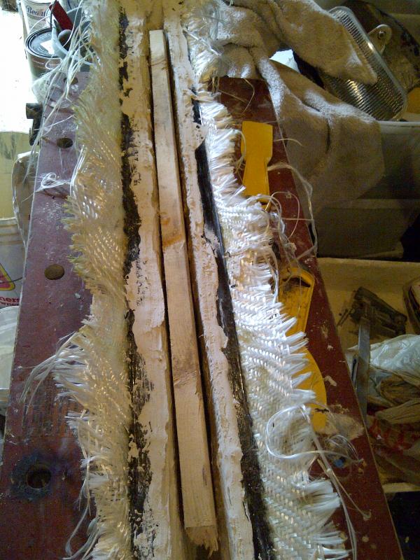

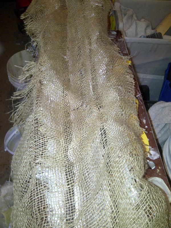

I coated the sides and let it dry. (thin coat0 Next I mixed more plaster and cut my burlap. I coated the sides and inserted the burlap, then re-coated inside and folded the burlap in on it's self. Then re-coated again to get all the air out and the burlap evenly distributed along the sides with a gap in the center.
next step is fill the gap. ( I may put a piece of wood (1x) in so I can screw it down to work on instead of clamping it like the last one.) Probably add a few screw heads sticking out inside the plaster to get an extra grip.

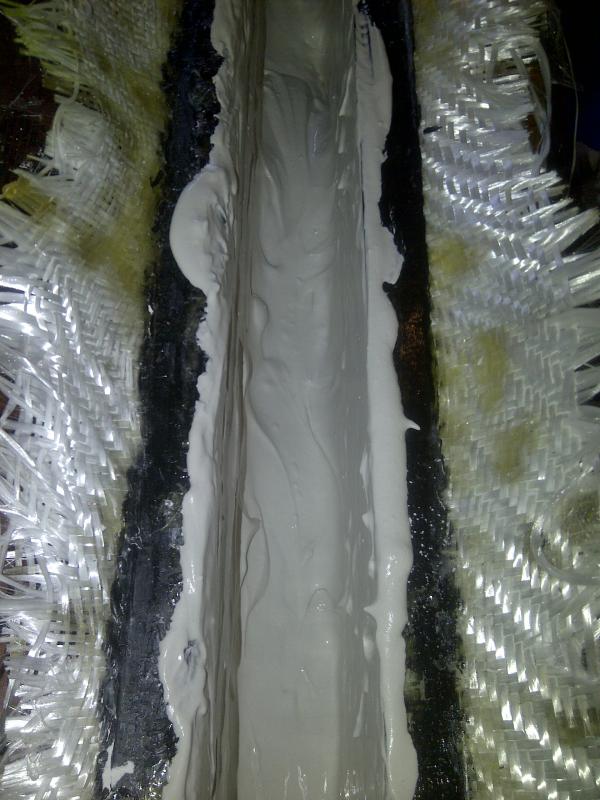

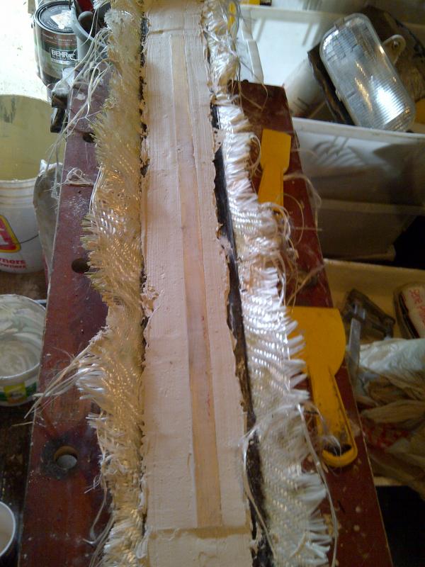

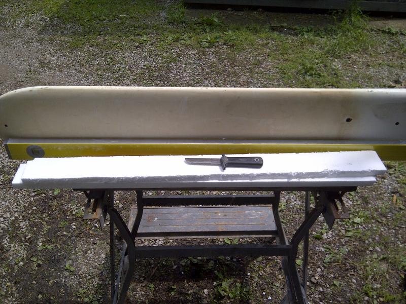

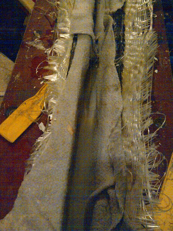

This thread is on the second page. I'm working too slow!
Here is what I did today.
I used a 1x2 to act as a attachment point when the piece comes out of the mold.
I will screw blocks to it and be able to pull on the blocks to help get it out of the mold too.
This will also give me something to attach the plaster piece to the work bench so I don't need to clamp it and risk breaking it. I'll just screw up through the bottom of one of my workmate benches.
