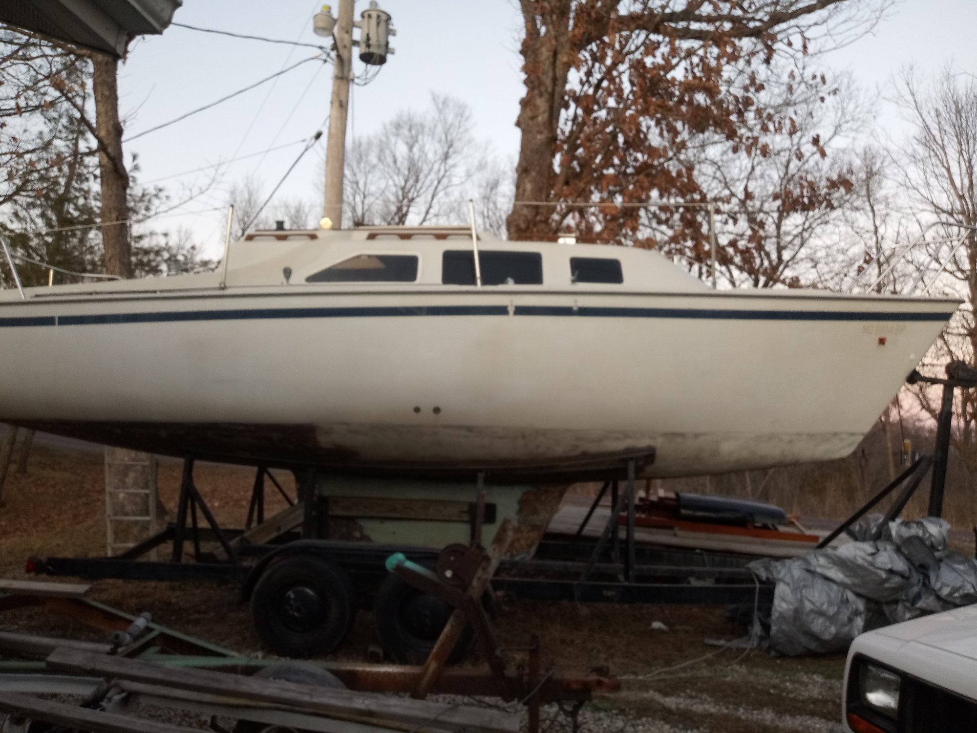

We put a pen and paper to it. I have just under $1200 in this project including purchasing it (boat, motor, and trailer) sales tax, reg, and materials. I can't wait to get it on the water this spring. It's a massive upgrade from my sc22. The S2 we've been discussing goes under the knife next!

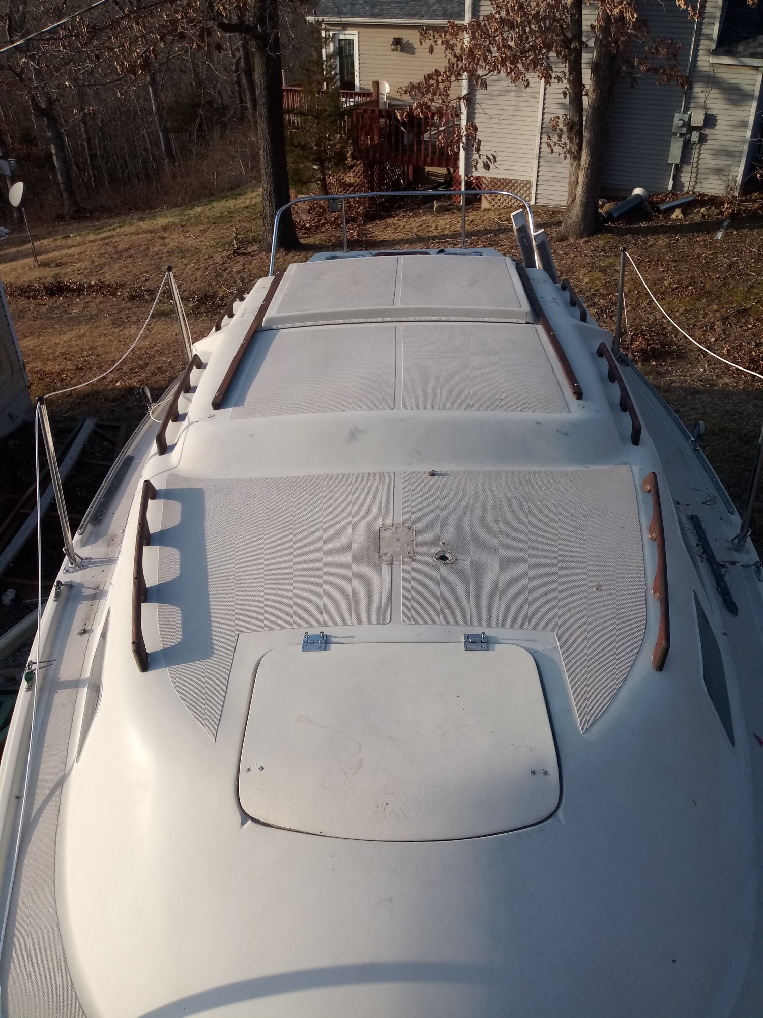

I got my wood bits back on the deck this afternoon. I removed the mast completely yesterday to service the mast head, clean, and rewire it.
I still have some small bits to finish in the cabin. I have to wire it still as well. Other than nav lights there will be couple interior LEDs , I am keeping it quite simple.

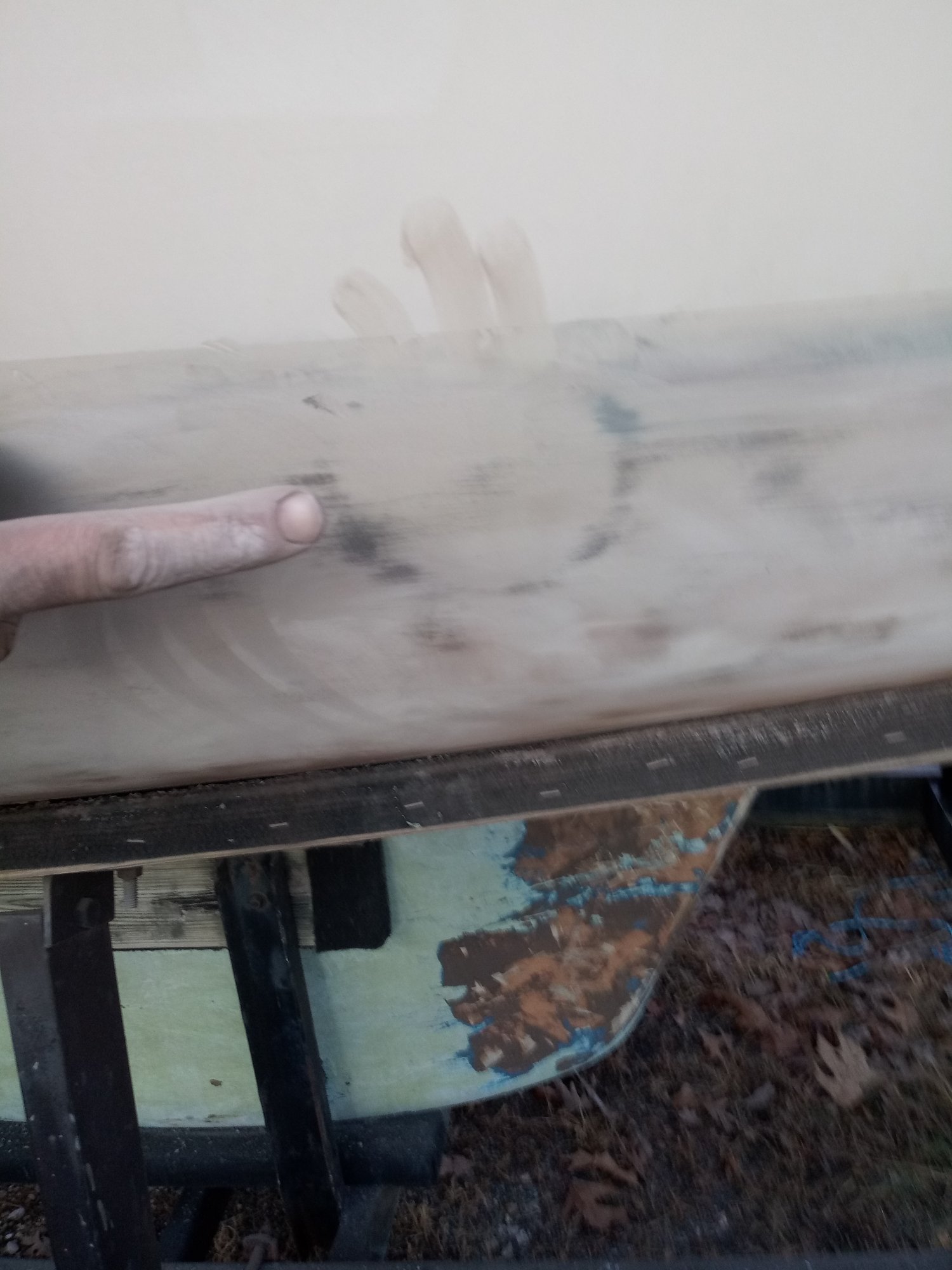

Bottom is mostly scraped off. I started sanding and made it about 20% of the way this evening. Found a blister.... But that's to be expected.

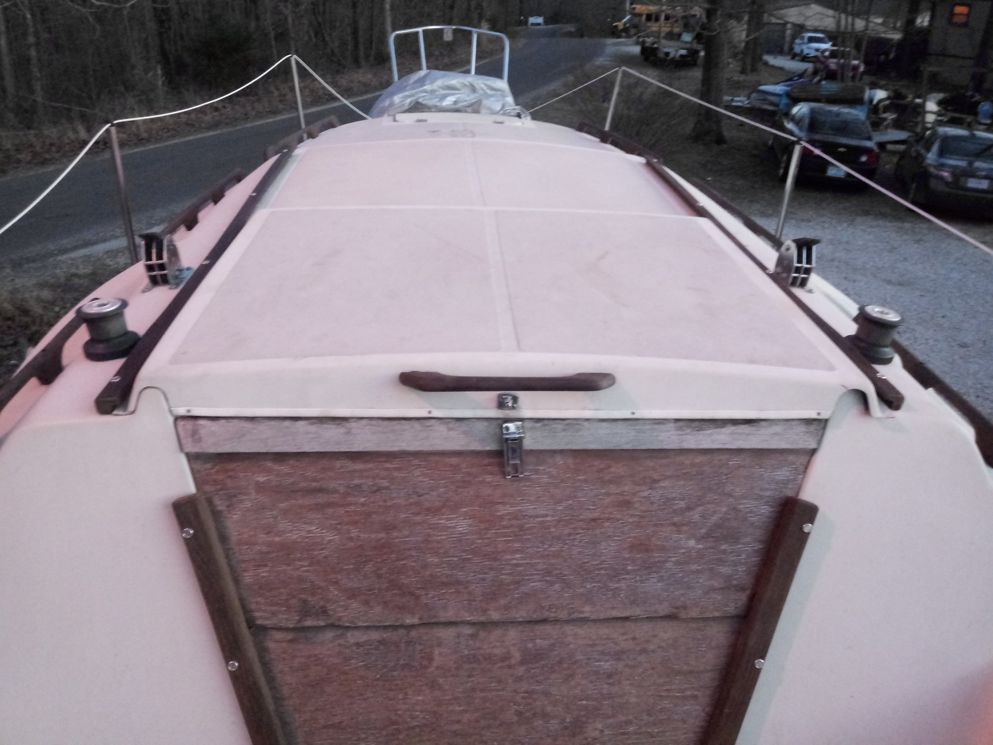

The interior is assembled other than a few small bits and cushions. All deck hardware other than 2 tracks and 2 deck organizers have installed. Wire, lights and bulkhead connector came in last week. Engine is off and at my shop to clean up and service.
I still need to order a few bits and it needs a ton more labor invested. Progress as planned though.

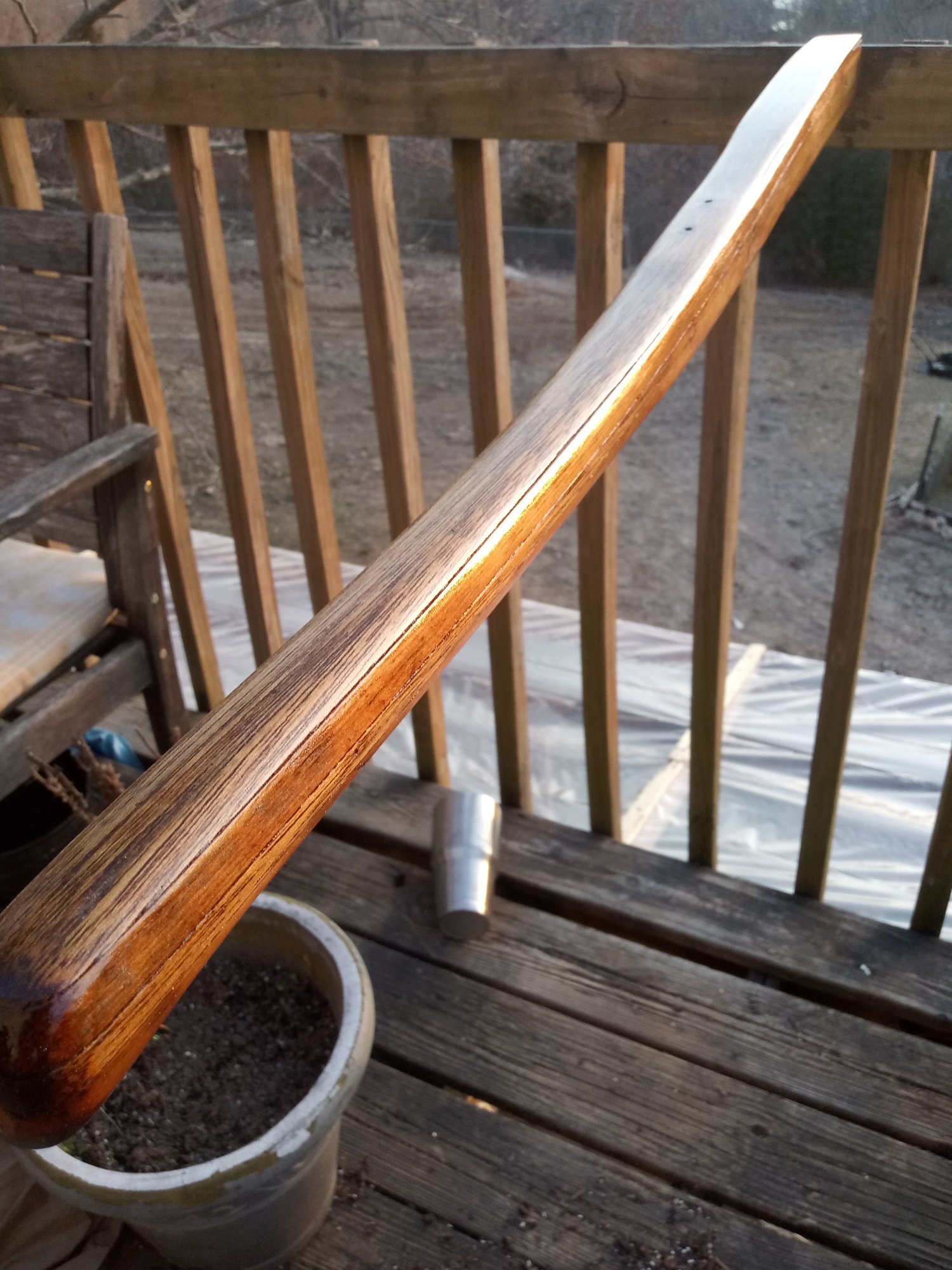

Aug 10, 2020
545
Catalina C25 3559 Rocky Mount
Looks great! :beer:

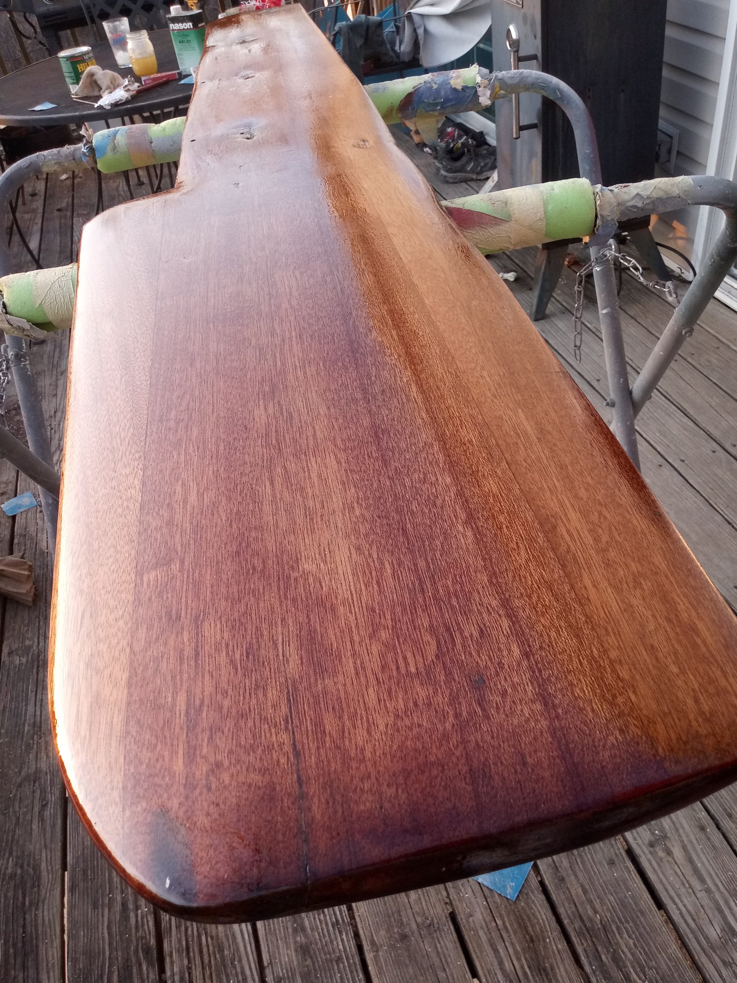

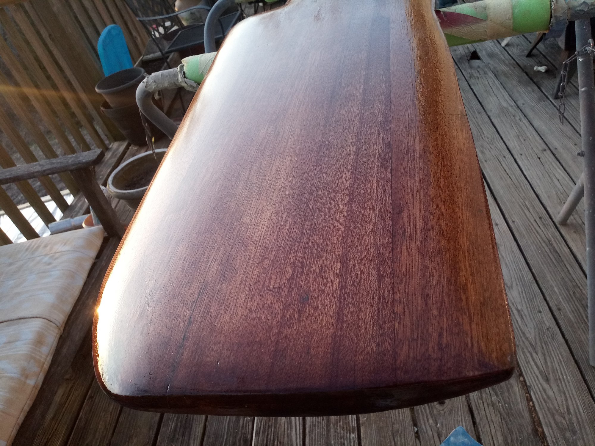

Thank you sir. Varnish isn't my thing, but it is satisfying when it does it's thing. On coat 3 right now and it's starting to look good , fill grain and lay more smoothly. If the weather cooperates I will get it sanded and recoated again this morning.
