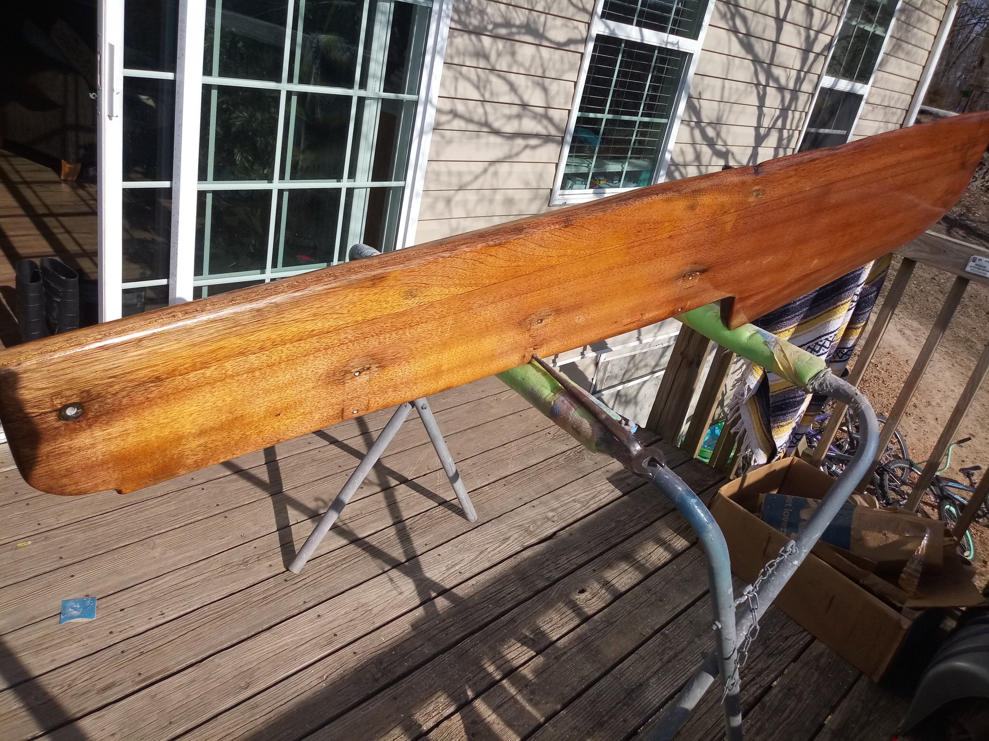

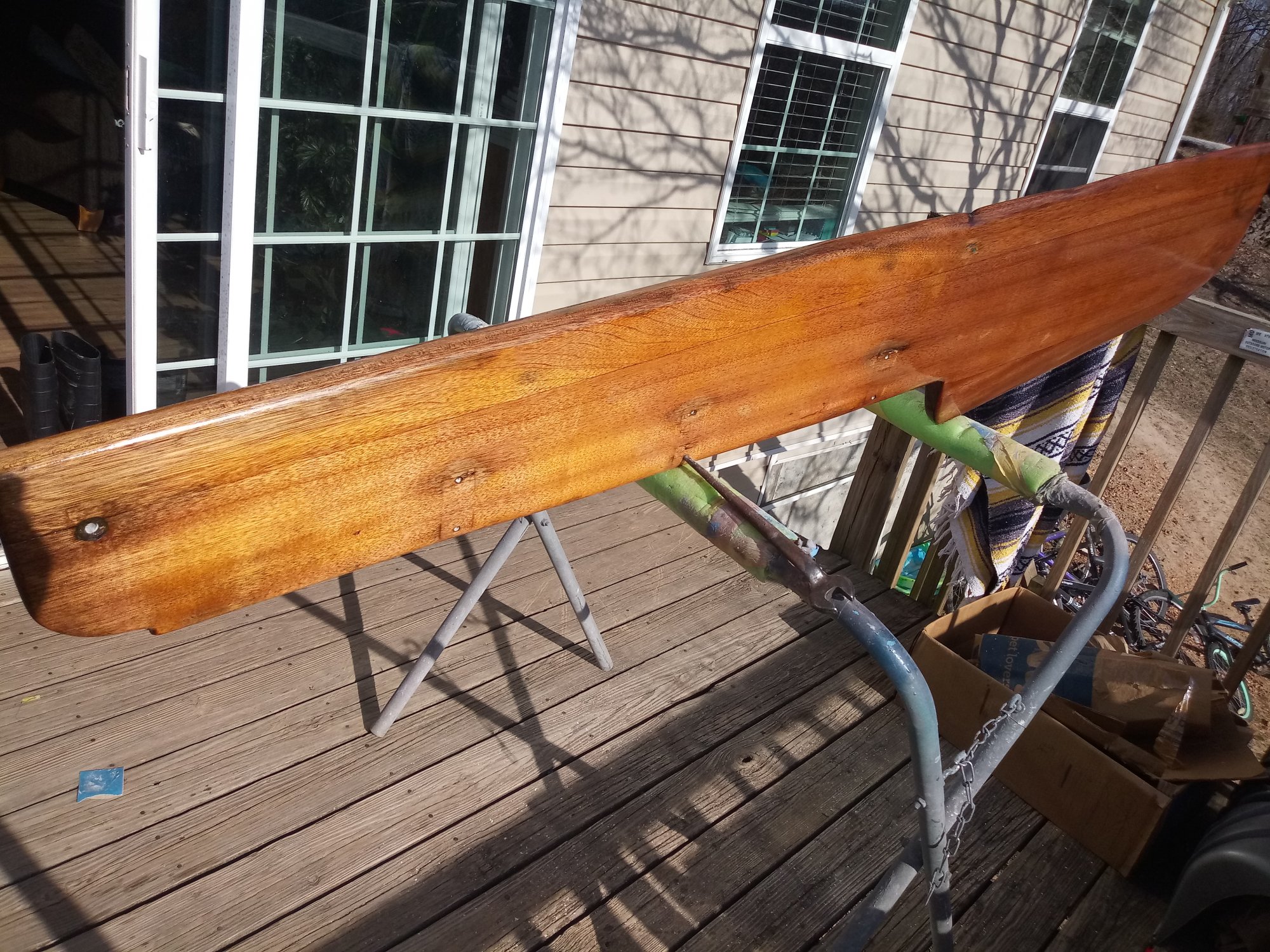

Those pieces look gorgeous! What type of varnish are you coating them with?
Just cheap minwax helmsman spar varnish I had sitting around from another project. The PO had stripped the rudder and tiller to bare wood. I sanded them further with 80-180-220 on a block to flatten things out from him power sanding it. I've been giving it 8 hours to dry,block sanding it with 220, recoat, repeat. I think I will leave it to dry thoroughly for a few days before I sand and recoat again.
