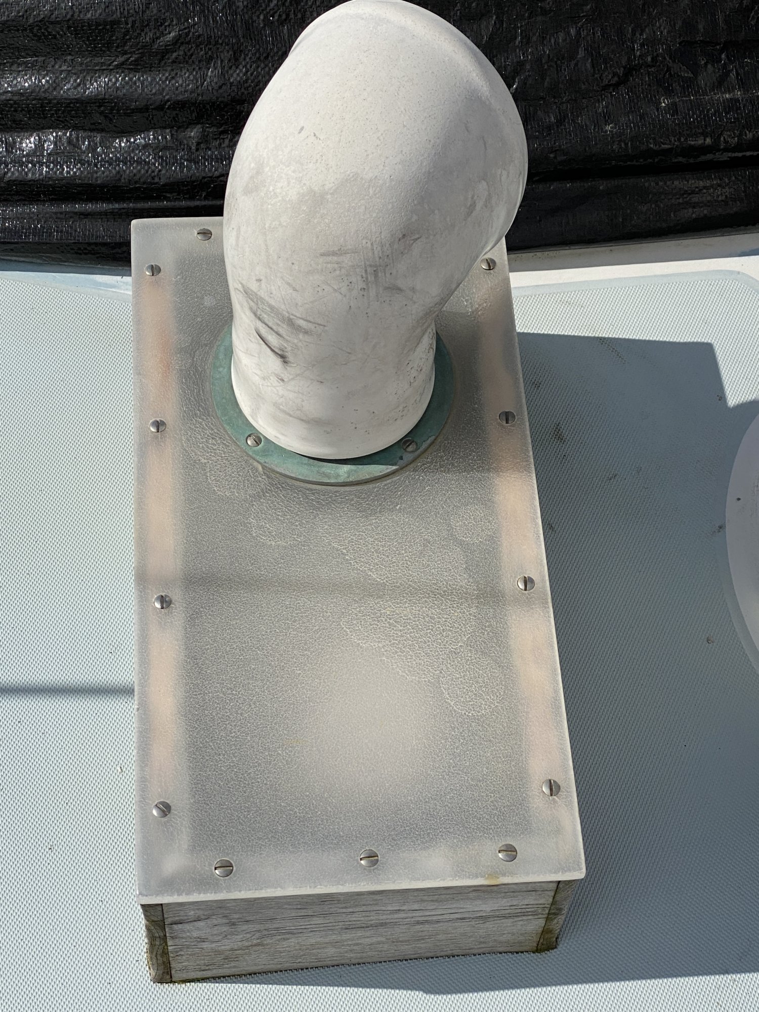

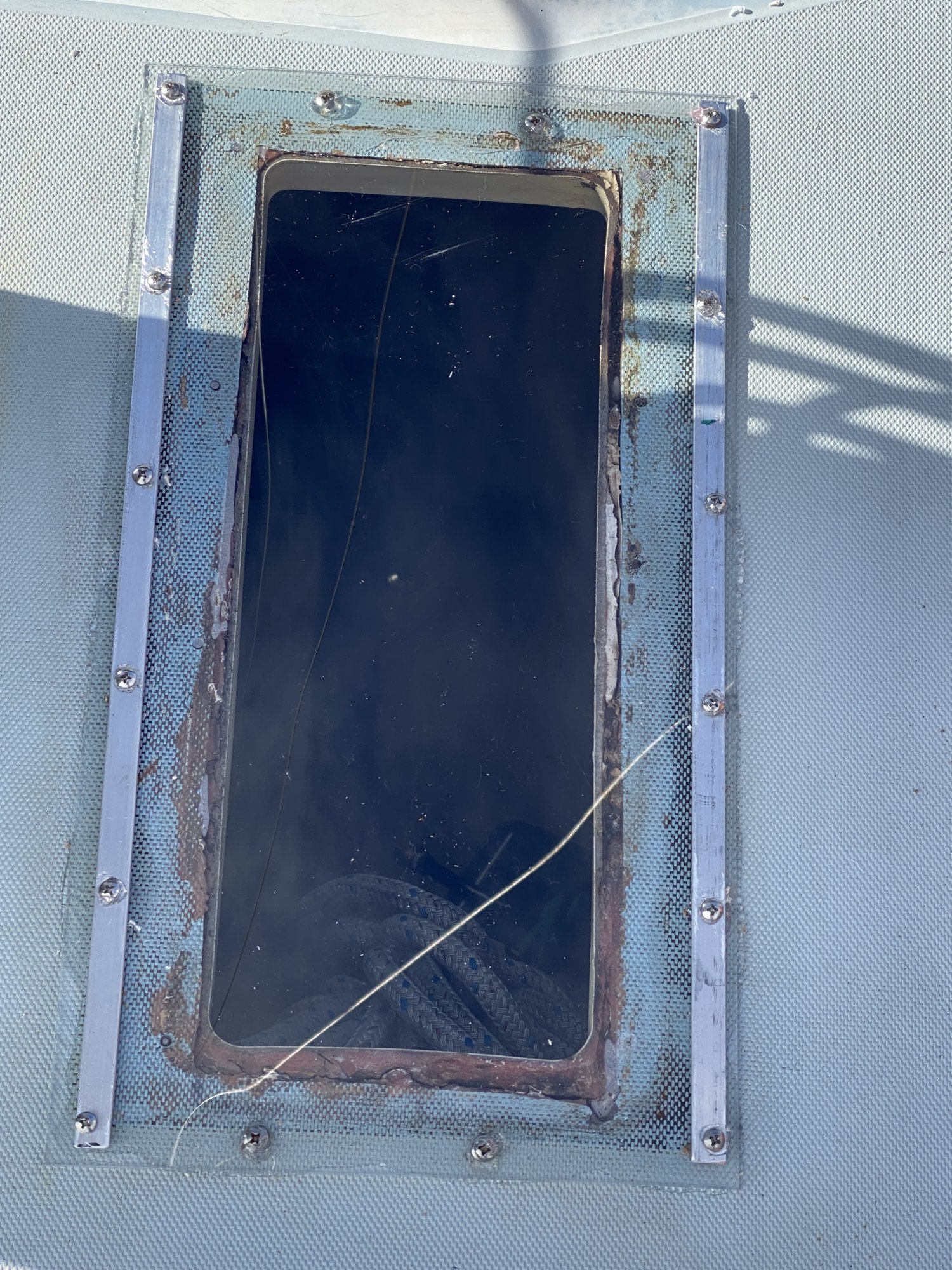

My boat looks nothing like that today. The past week has been a series of partially finished projects.
First up, I arrived just after a rain storm. There was a pint of water on the head deck. I tracked it down to a leaking dorade. Removed the dorade for repair and added a quick patch to keep the rain out.
1/4” piece of plexiglass, some polyurethane caulk, and 2 aluminum strips for hold down.

John, why is there such a big hole in your deck for that dorade box? I'm used to seeing just a 3" or so round hole with a raised lip. That looks more like a vent than a dorade box.

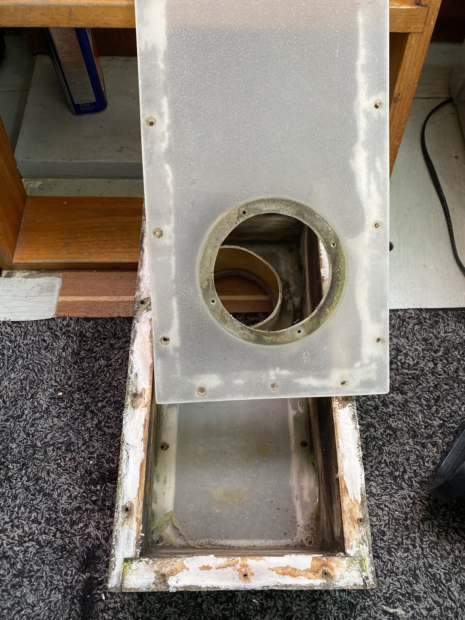

My thought was it looks like an opening for a hatch. The design has 2 layers of plexiglass on a dorade wood frame. This provides a constant source of air and light into the head. Here is an image of the parts.
The PO failed to caulk and properly install the dorade to prevent leaks/moisture getting beneath the deck. That will be corrected. One option would be to ignore the dorade and install a decent hatch. I’m not sure of the solution till I get the dorade home and into the shop.

That makes more sense, trying to get light into the head. If you can find a hatch to fit that would be better. Or put a plate over it with a solar vent which will move more air than the dorade.
