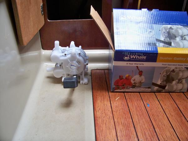

I installed a foot operated whale pump underneath my galley seek and really liked it a lot.u can research that under Jamestown distributors or defender marine.

...I installed a foot operated whale pump underneath my galley seek and really liked it a lot.u can research that under Jamestown distributors or defender marine.
- That looks like a good possible solution. Did you mount the floor foot pump inside the cabinet or outside?

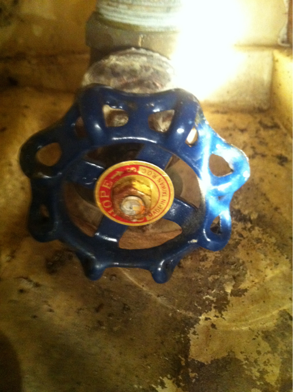

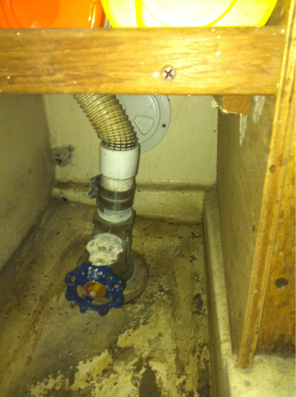

Here is my valve, is it just a quarter turn?
<img src="http://forums.sbo.sailboatowners.com/attachment.php?attachmentid=66001"/>
<img src="http://forums.sbo.sailboatowners.com/attachment.php?attachmentid=66002"/>

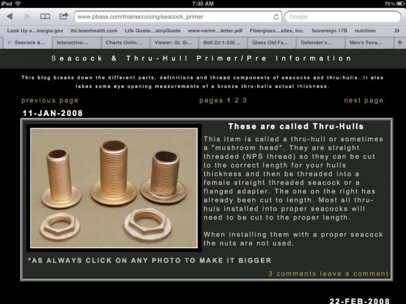

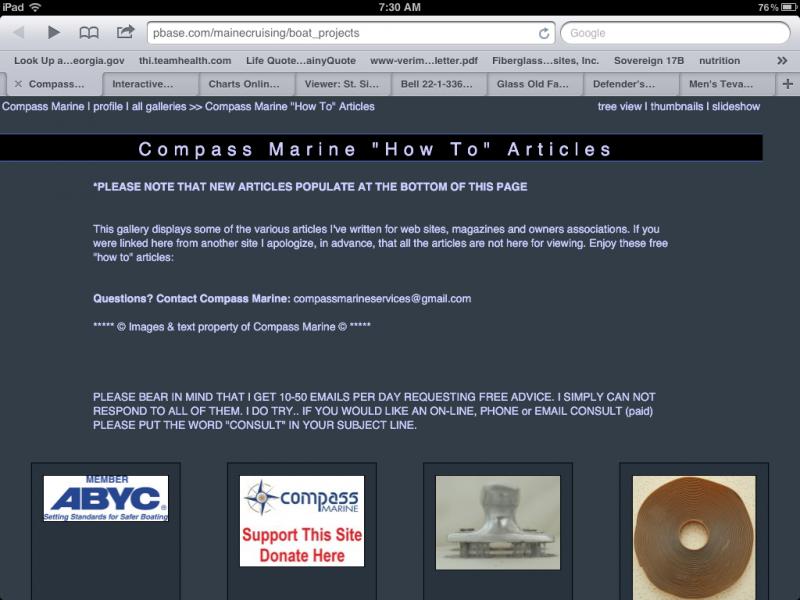

Crap! I wouldn't touch it with the boat in the water. Please review these links to our websites host, Maine Sail's how to page on through hulls. Just follow the link and scroll down to the article on "sea cock and thru hulls, pre information and primer"
http://pbase.com/mainecruising/boat_projects
I put it just inside the cabinet and cut a little slot for the "handle" to stick out, the put the foot pad on the handle, fit well, installed easy, and worked great. We loved it. I never felt that I had a good place for it under the sink in the head though.

Yikes, that wasn't the reaction I was hoping for. Unfortunately I'm slipped, and don't have a trailer option unless I find someone at the marina who has one to borrow.
If your reaction was due to the condition it appears to be in...it's not that bad. It had a dirt dobber nest on the top of it, so it just needs to be cleaned. Almost to that side of the boat.

What's behind that inspection plate. I don't think I have one on mine. Does it go back to the engine compartment?
