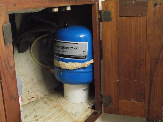

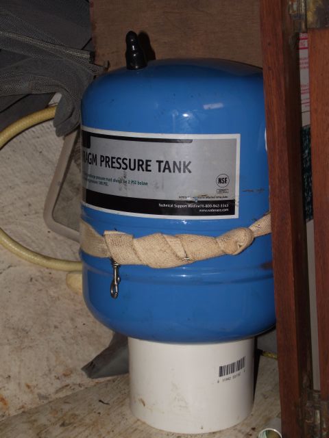

While you are redoing your water system you may want to consider an expansion, accumulator tank. I put in a two gallon one from Lowes. It makes the pressure system run much better. I located it under the head sink under the two drawers out of the way.
I used a large diameter pvc pipe cut about 4" long as a base it works very well.

Here are some pictures of the accumulator tank installation. It is a simple device. It has a diaphragm inside to keep pressure on the water in the system. The pump will run less as the accumulator holds water. You may even turn the pump off until the pressure is low. Works well at night no pump noise. All there is to the installation is too attach it to any part of the water system after the pump and it keeps pressure in the system.

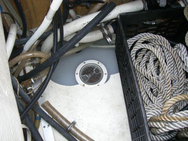

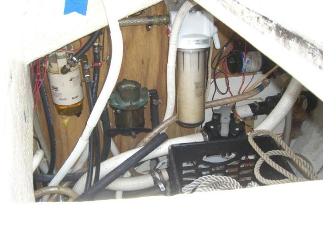

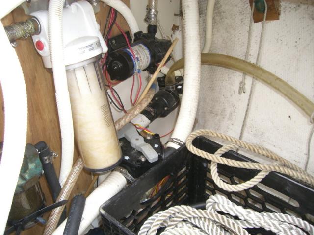

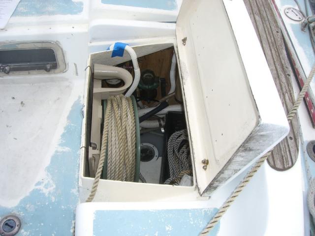

I moved my water pump years ago. The space it occupied now houses black water, which is all it is good for. The pump is on the head aft wall, that is the wall that separates the head from the sail locker where it originaly resided. I screwed in a piece of 1/2" plywood and mounted all sorts of stuff there. Water pump, water filter, engine raw water strainer, electric fuel pump, mascerator. Parts are probably still available from the manufacturer to rebuild that pump. I did mine years ago and it was fine. I'll try to post pictures later. I know you like pictures.

Sam, your first three pictures make it look like an engine room. Then we see that you have to go in through a small locker opening. So it seems that "accessible" is a relative term. Has something to do with age, weight, and flexibility. "Double-jointedness" would be a bonus. We can develop a formula. :)

The sticky stinky Wilcox-Crittenden bladder is long gone. I had a tank made which is in the useless area where the water pump was below the floor of the locker. I have posted about it several times. You can see the top of the tank in the middle picture of the top row. That Beckson screw cap port provides access to the tank for rinsing and foreign object retrieval. And yes, I have.
Ed;
I'm closing in on 62 years, although I'm told I look more like 38. Well, maybe 58. While I seem to be holding up better than I have any right to I do have my share of creaks, crunches and bad neck. Only about 10 pounds overweight. Despite that I have no problem stepping into and settling down in there to work on the systems. The locker in question is what I refer to as the "sail locker" under the starboard cockpit seat of the 33. There's actually plenty of room. Might be you're seeing the hose reel that holds my anchor rode as an obstruction. (I deploy and retrieve the anchor from behind the wheel using the sheet winch as a windless.) The reel pops right out and provides reasonable entry. I step in, bend the knees as I turn, settling down into the hole. Not so bad at all.
