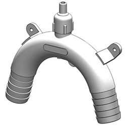

A siphon is a "dynamic" thing.
Simple shutting the sea water valve will STOP it. After a few minutes, you can reopen the sea cock.
From your picture, the black disc is your check valve.
It SETS closed on pressure
When pressure is stopped {engine stops] the disc should open air flow through your vent to stop the siphon.
Jim...
JamesG161
Feb 14, 2014
8,111
Hunter 430 Waveland, MS
How do I verify this is the causal part?
I think I now see how yours works.
The curved copper piece is the vent pipe.
That black disc should be cleaned, and check the seating surface of the fitting.
The disc must be free moving in its fitting.
Jim...

Ordered a new high point Vented Loop from Defender. Arrives tomorrow. Hopefully that's the fix. Ruled out water pump as the seal is outside the engine. If it's not the vented loop I'll disassemble the exhaust elbow.

Your new high point vent looks like mine. Each spring I take off the top, make sure the disc check valve is clean and reassemble it.
Your sea water pump looks newly installed. Mine is still original OEM painted.:confused:
Really not much to go wrong with our sea water pump.
After you get your new High Point vent [siphon breaker], run your engine for maybe 30 minutes. Shut down and later check your oil for water.;)
Jim...

@S.V. Windshadow didn't respond to my PM. Perhaps he is new to SBO to know how. Note his post#28 use of a tag to me.
Charles and I have been in a PM speculating the cause. Result of our PM discussion prompted my Post#29.
The engine run would without water in oil, would pinpoint the vent was the cause.;)
One added piece of info...
The pictures of his vent are really the OEM type vent.
http://www.marinepartseurope.com/en/volvo-penta-explodedview-7746710-26-357.aspx
It surprised me, since mine is like the Defender one he bought in his post#25.
Perhaps my previous owner had similar problems and changed mine to the Defender type.

Also @S.V. Windshadow is now shutting his sea cock after engine use, as I do.
Tip: Hang your engine key on the sea cock valve handle. Psssst don't tell pirates.;)
The failure of the Water pump seal components is very rare. [;) to Charles]
It would take a failure of 2 lips seal components [part# 16] in my post#15.
or
As I noted before. his pump appears new, mine is still OEM painted.
Perhaps the bearings were not properly pressed on the shaft, which would not allow the O-Ring to compress and set/seal the other parts.

In port I always close mine too. Underway under sail I keep that seacock open as I would expect Windshadow and most of us would so we can start the engine from the cockpit if needed without a trip down below. If Windshadow keeps the seacock closed now, as you said in your #21 post any testing for water in the oil is not meaningful re: either the leak path from the loop/exhaust riser/cylinder or the more direct plugged loop/water pump seal path - no raw water supply, no water to the oil pan. Until the boat gets underway again and the seacock remains open. I suggest the seacock be left open for testing the effectiveness of the repair.
JamesG161
Feb 14, 2014
8,111
:plus::plus:
After thinking a bit more on a valid test...
Always close the sea cock after any engine use.
This will focus the testing on his Water Pump Seal.
No water ever again, then by process of elimination...
It was his vent.;)
_____
Then much later engine use, still no water, he can confirm his vent for convenient transit anchoring or sails up.
Leaving his seacock open.
Jim...
PS: Closing the sea cock prevents a siphon too.:)

Thanks Gents for all the info. I have been back cruising for over a week. 1st day 7 hours motoring down the St. Mary's river. No water in oil (not burning any ether). After a week motoring and sailing, still no water in the oil. I am closing raw water seacock after engine shut down. Rebuild kit for old anti siphon valve arrived. Still have defender model in there. I'm just not willing to test leaving it open, as it took 6 oil changes to get it clear last time.
