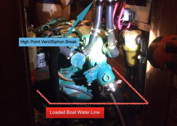

2 hour sailing in following winds. Then 30 minutes of motoring to a slip. After sitting 4 days, our oil was like brown molasses and up about 4 quarts.
How can water get in there? My mechanic said it probably backed up through the muffler. Any other ideas?
