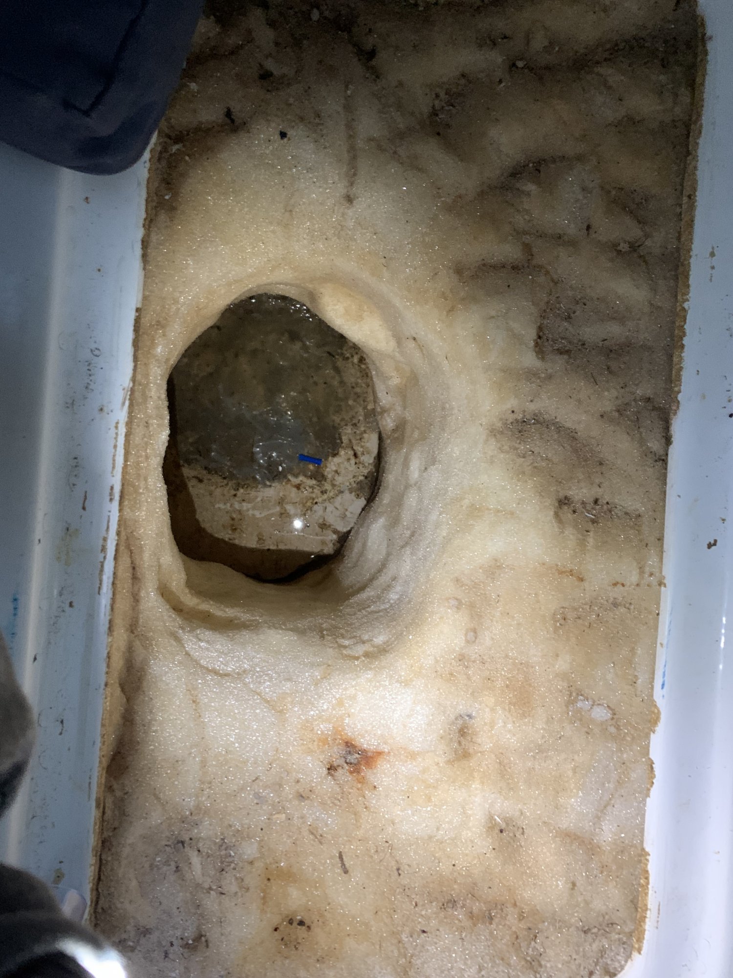

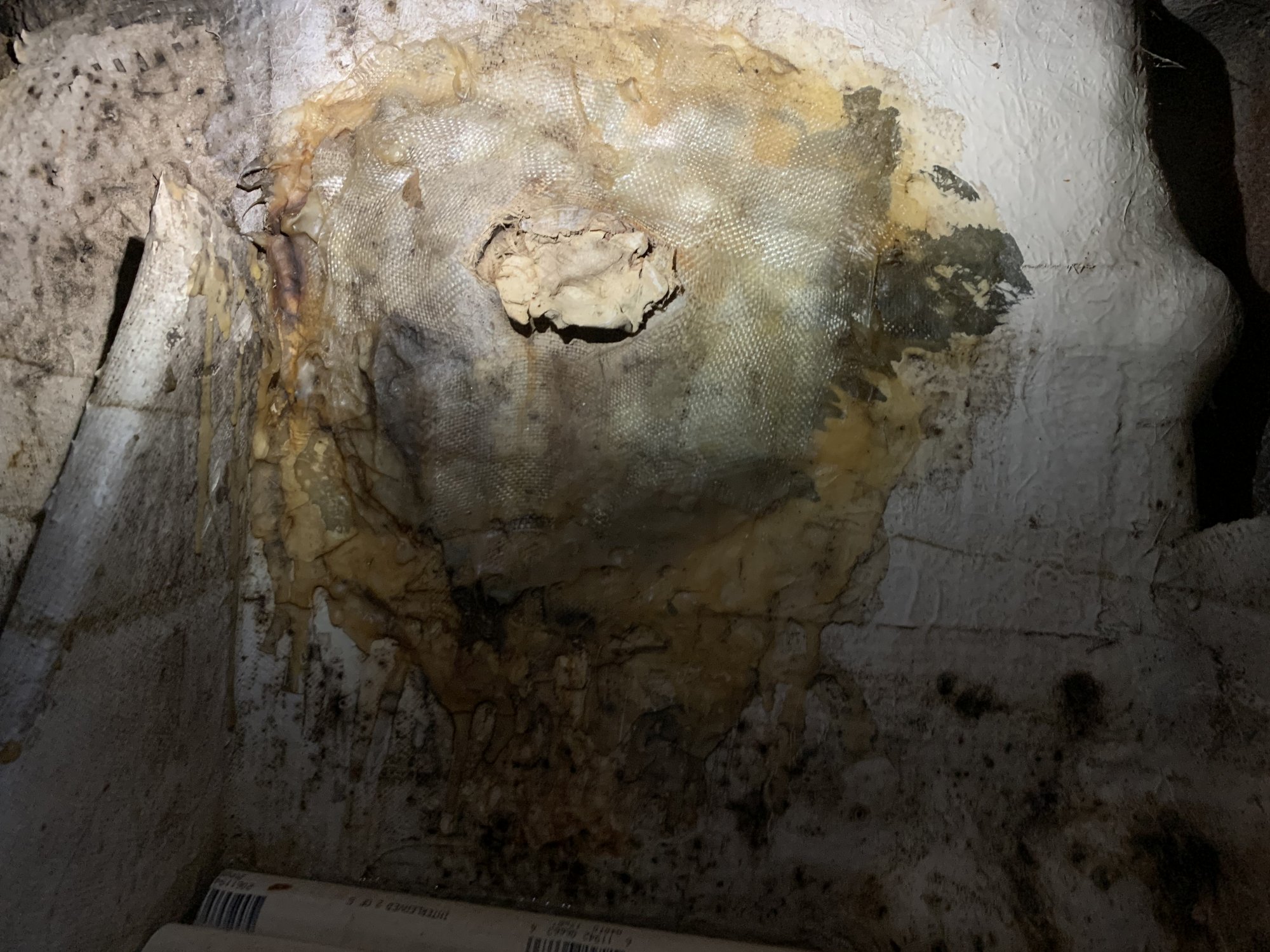

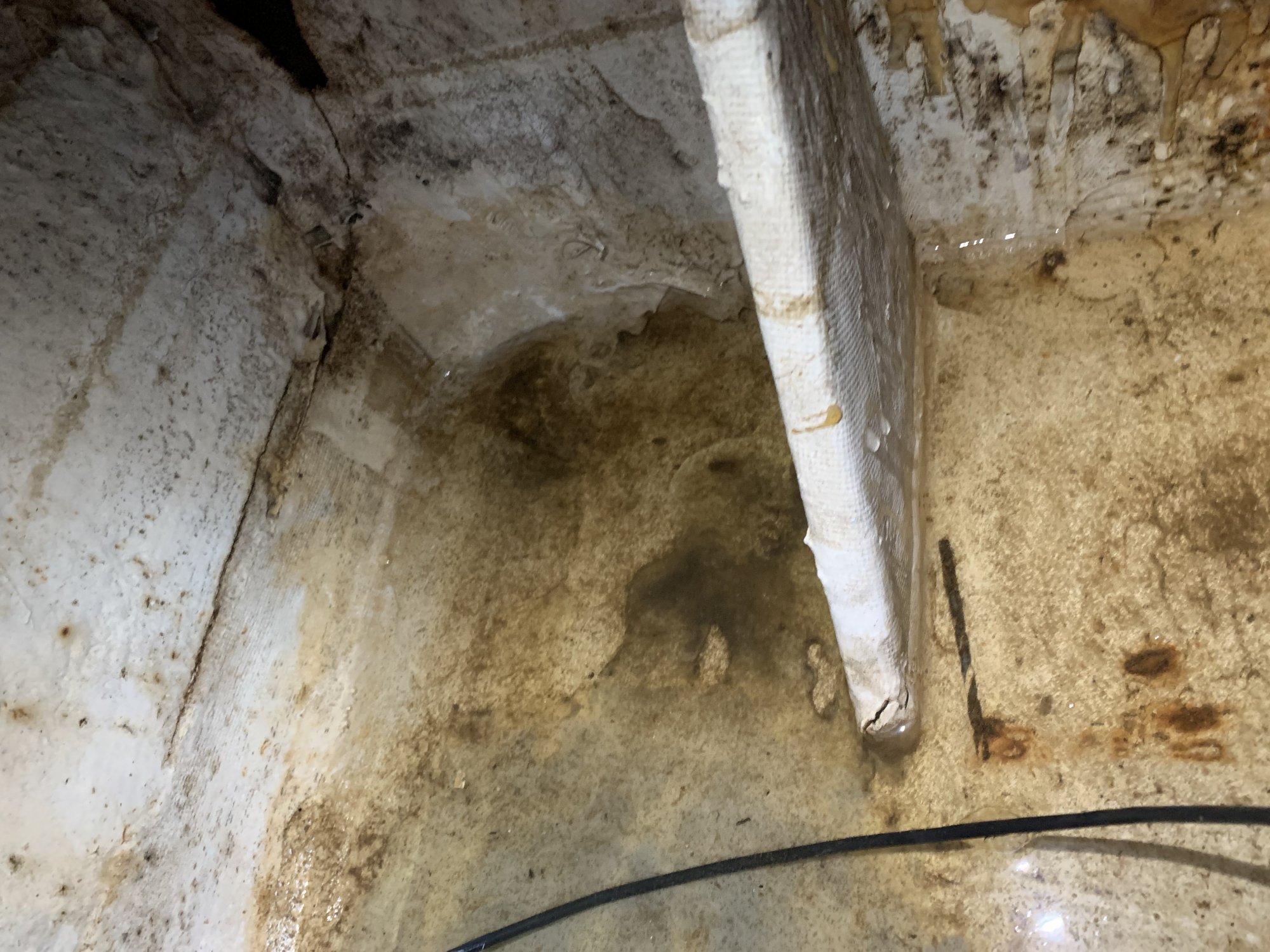

I recently purchased a 1974 Cat 22. It had only been stored outside a couple months before I bought it. Upon a more thorough inspection I found water under the forward dinette bench. Maybe a gallon. One of the POs. had a field day with the fiberglass in there, including patching the shit out of where the keel lock bolt should be.
There was also a good amount of water under the V berth, where someone cut a big hole in the foam, presumably to access the water? None of the other compartments had water. The boat tilts forward a bit on the trailer so it makes sense the water would run to the bow
my questions: how screwed am I? What are the odds it’s coming in from a crack in the fiberglass somewhere below the water line? Should I try to grind out the old fiberglass where the keel lock bolt was and try to reinstall it? It seems a likely culprit for the leak.

Appreciate the reply! Do you have any experience glassing? Im assuming I just go to town with a dremel or grinding drill bit adapter. Do I go all the way through the hull? I can’t see how the keel locking bolt was originally installed, but I know there’s a strap that it was bolted to. I bet thats still there.

I'm of the opposite opinion of ...3TacksontheWater (you'll get that on forums). Personally I removed my lock down bolt. It was rusted in place and pretty much broke when I tried to turn it. I just sanded the area flat with pretty heavy grit sand paper so that the epoxy would have something to grab, then cut a couple of circles of fiberglass, saturated with epoxy and stuck them over the hole. A little smoothing work with a plastic scraper and you're done. No need to sand / fair / paint the patch unless you really want to.

The fiberglass work is pretty bad and looks fairly easy to remove compared to a properly saturated repair. An oscillating tool is something you want in your arsenal. I've done extensive work with a $20 Harbor Freight and a $100 dewalt. The dewalt provides superior control, especially when starting the cut

appreciate the advice. No there’s no water leaking out the bottom anywhere. All other compartments are bone try even after I trailered it home up and down hills. This leads me to believe the leak originated somewhere in the bow and is isolated there. My guess besides leaky deck fittings is it’s where the PO removed and patched the keel lock bolt. That patch looks shotty. There is a patch where there was a thru hull transducer that was removed in the same compartment. But that patch looks solid.

I find it unlikely that it would enter somewhere aft, migrate completely around all the bulkheads and pool only in the bow while the compartment with the source leak is completely dry, but you never know. The hull seems intact everywhere. I think it’s either the keel trunk or coming from rainwater?

It was quite a bit. Maybe a little over 5 gallons total. Mostly in the bow under the vberth.

Yeah that’s where the water was, under the forward dinette locker and under the V berth
