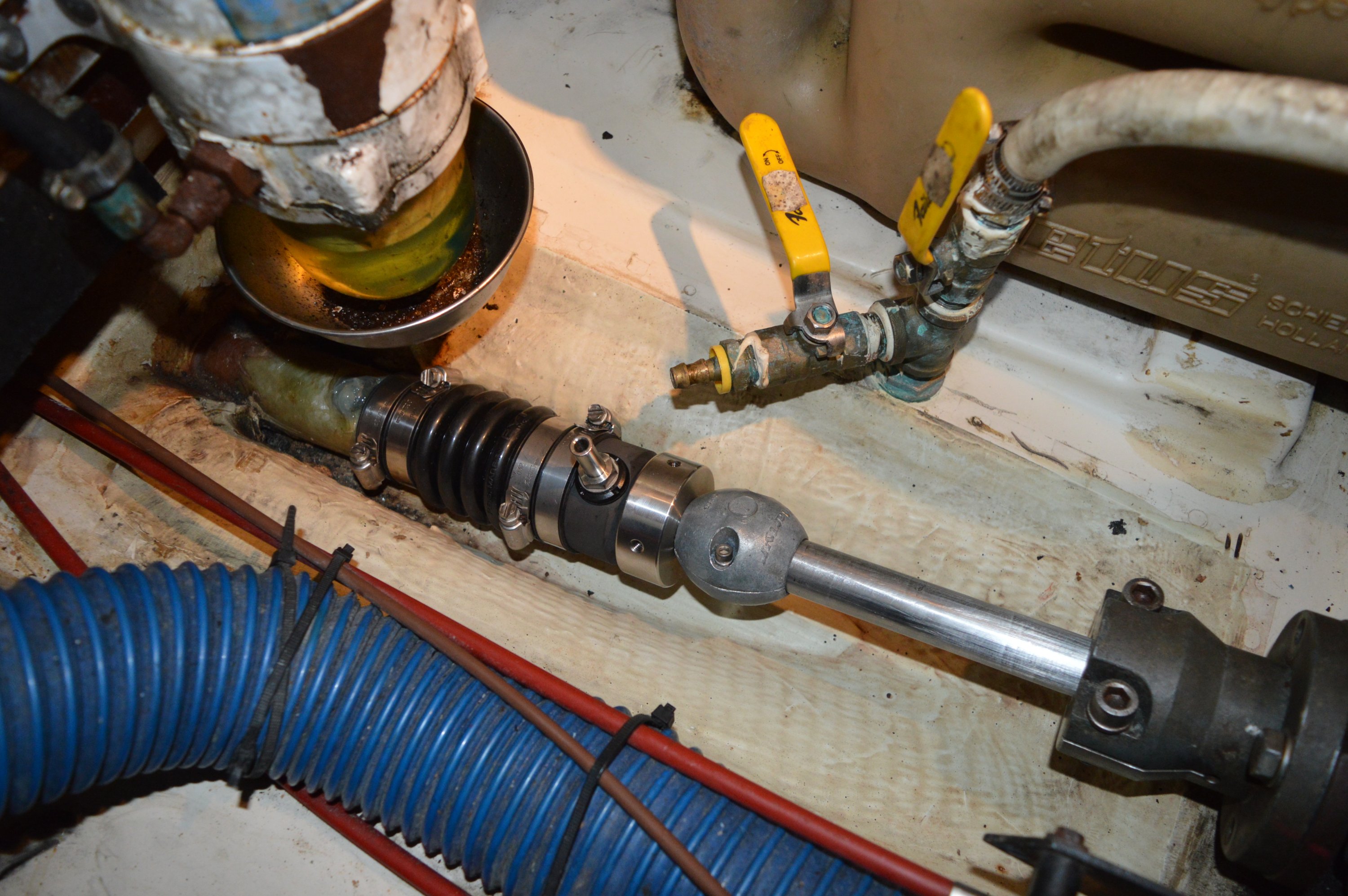

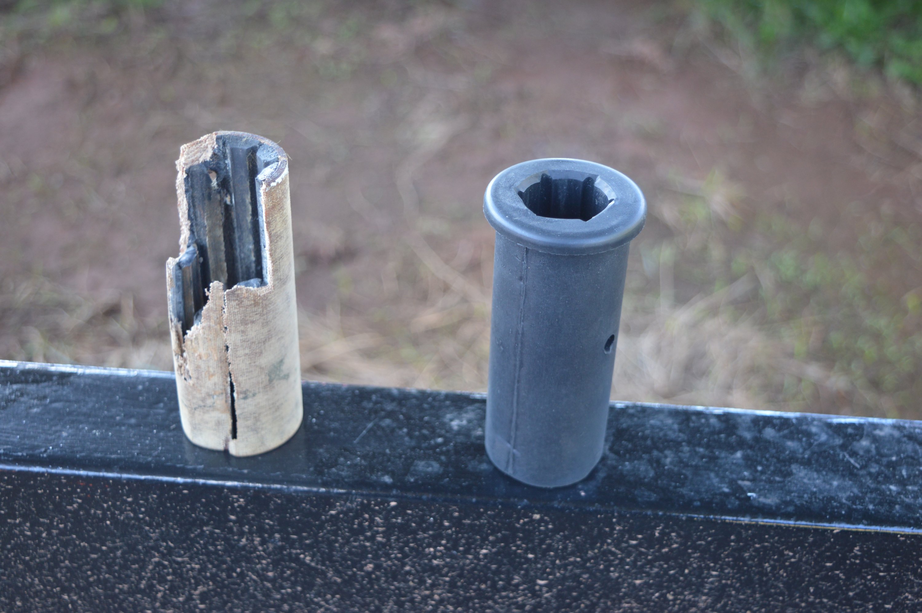

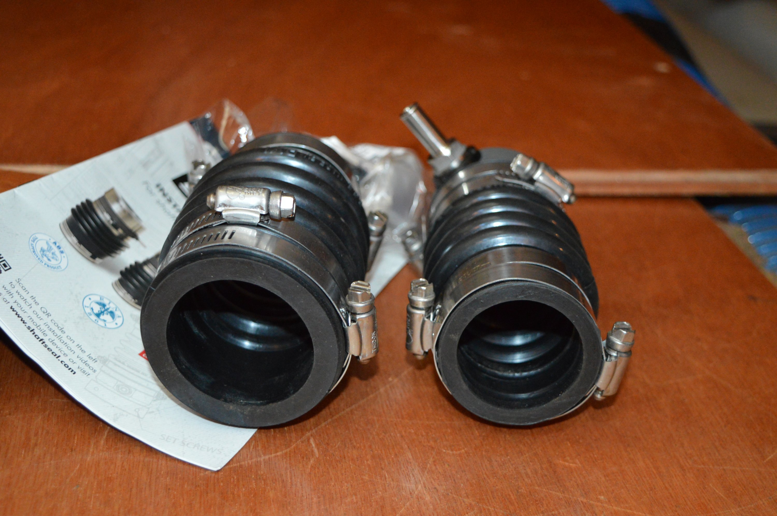

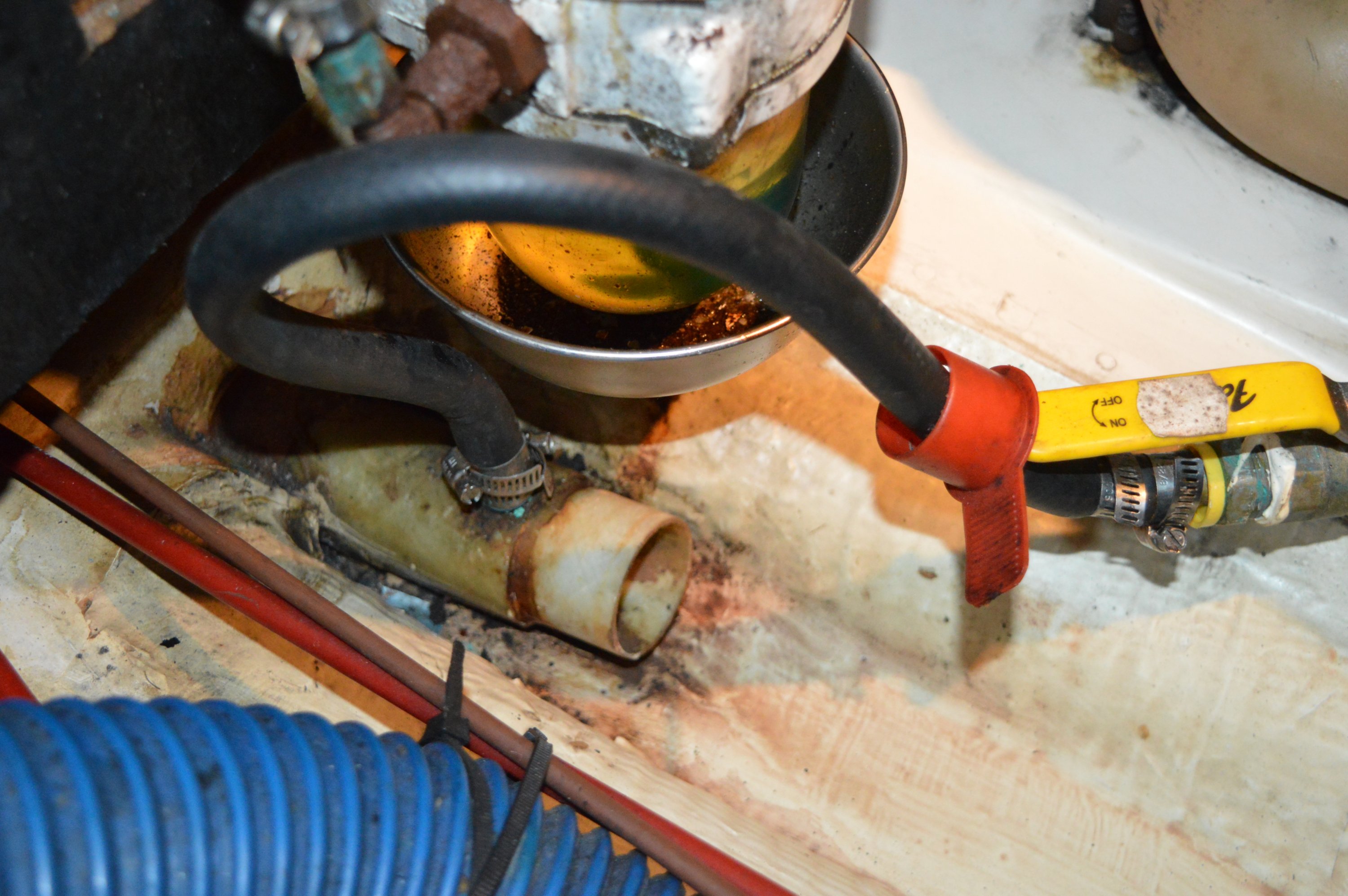

One step closer to launching this year (only another 20,000, 5 minute jobs to do). Replaced the original Volvo seal with a PSS, and Cutlass bearing as well. I had mentioned in another post that I thought I'd have to build up my stern tube, but after checking around found out I ordered the wrong bellows, (the right size is the one on the right in the picture, and wasn't available from my local dealer). so all is coming together, chopped off the pesky nipple that resides aft of the original and filled the hole with epoxy,. I still have a few things to tidy up, as the photo's show, one being the hose that the original po had to lube the Volvo seal, I will plug that. Interesting that the Beneteau cutlass bearing is solid rubber, with no bronze outer casing.

Explain why you have the shaft zincs inside the hull? I am no expert, but
I would think that they would have to be exposed to water to be of any value.

Looks like he is using it has a lock collar to keep that half of the seal from sliding back.

It's a cheap collar lock.
Why plug the hose going to Volvo seal? You still need to lubricate the PSS from somewhere, right?
I believe Beneteau uses solid rubber cutlass bearing because they are easier to remove from the skeg in comparison to bronze ones used on boats with access from both sides.
The PSS has it's own vent nipple, I don't see a need for 2.

Phillip, think that Brian was referring to plugging the hole in the shaft tube where Beneteau installs a nipple for cooling / lubricating water. He will now use existing thru Hull & hose to attach to the nipple on the new PSS shaft seal instead of the old nipple on the shaft tube.

The original po, had installed a shut off on it.
No, it was sold with a shut-off on the shaft log raw water supply. I am asking what you are sharing the thru-hull raw water supply with. I would fix that while I was doing the work you have underway.
That's interesting info, I didn't know! Thanks!
This is split from the galley sink (raw water foot pump side) and into the original Volvo shaft seal vent tube.
