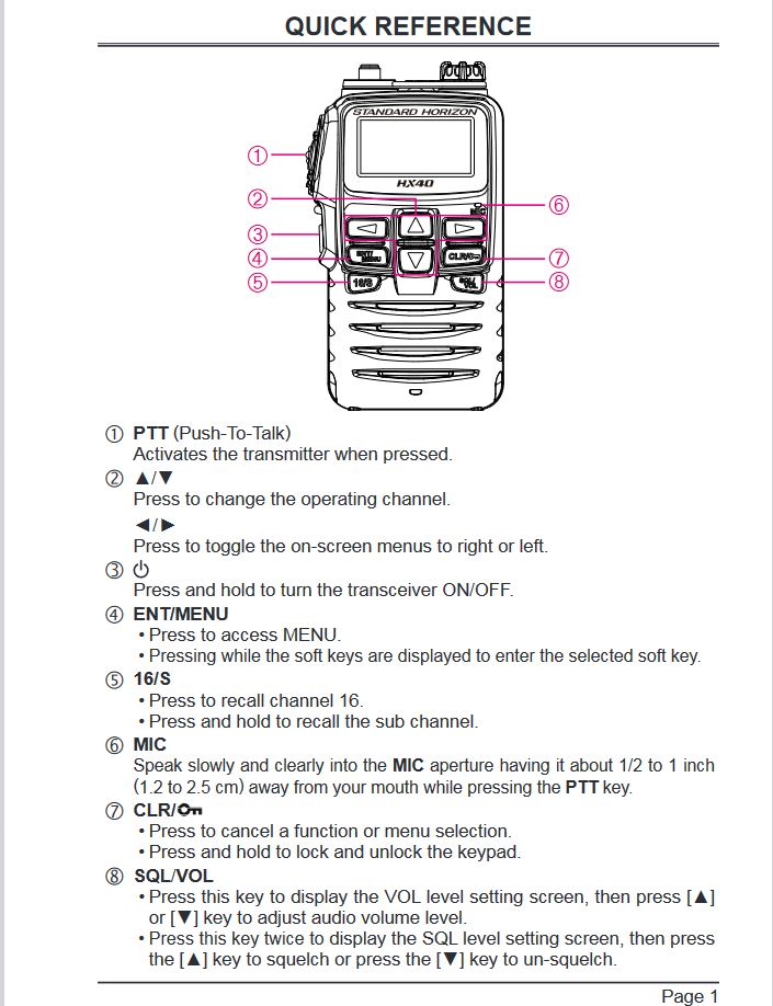

Which handheld do you recommend?
The one in your hand that works. For me it is the Standard Horizon I have had for 7plus years.
Expectations...
  • I am only looking for basic features. I only use this to contact in sight marinas for slip assignments or launch service.
  • I need clear sound, 5 or 6 watts broadcast power,... REALLY ONLY NEED 1W power to reach a marina in your line of sight. The 5-6 watts is for emergency calls when you are far far away.
  • simple intuitive operation,
  • preferably with knobs and not multi-function buttons, that would Increase the cost.
  • and inexpensive to purchase.
  • What say you?
    • Standard Horizon
      HX40 6W Ultra Compact Marine Handheld VHF Transceiver
      Priced about $120.
Ease of operation.

That radio has the multi-function buttons and scrolling screen menus, which makes it tougher to use. My old HX270S has that big, old On/OFF/Volume know right on top, and single-function buttons for channel, squelch, 16/9, scan, high/low, preset, and mem (for scan). I love its simplicity. I had a couple or three of these, I'm going to try and find the rest and resurrect them: mostly worn out rechargeable battery issues.
