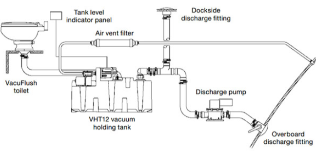

Is this schematic diagram like your system with a single vacuum holding tank? If so, yes as long as the new toilet can freely pump into the holding tank.

Yes, indeed. I was a bit puzzled when I saw the air vent filter on our boat. I was not quite sure what it was. I really need to order Peggie's book so I am not so daft on the subject of marine head systems. Thanks again. -craig

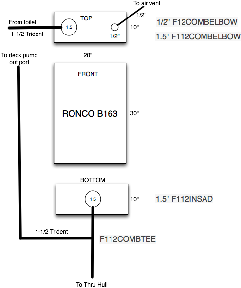

Hi Peggie. I read some of you book, still working on it. Below is my first run at this. I could not find 5/8" fittings from Ronco. What size of line does Vacuflush use for air vent? I decided to scrap the maserator, one less pump to support. Are there additional seals for the fittings that attach to the tank? Looking for feedback. Thank you, thank you! -craig
It really doesn't matter because you're going to remove that tank and replace it with real holding tank that will have female threaded tank fittings--which should be 1" to provide enough air exchange to keep the tank contents aerobic (essential to odor prevention)--instead of pressure relief valves....and Ronco installs fittings in the sizes and locations specified by the customer...so if you specify a 1" vent, that's the size vent fitting Ronco will install in your tank.
If/when you'd like to for me to help you sort all this out for on the phone, send me a PM (private message) and we can pick a mutually convenient day/time to spend up to an hour doing that. I don't charge anything to help folks do that.
