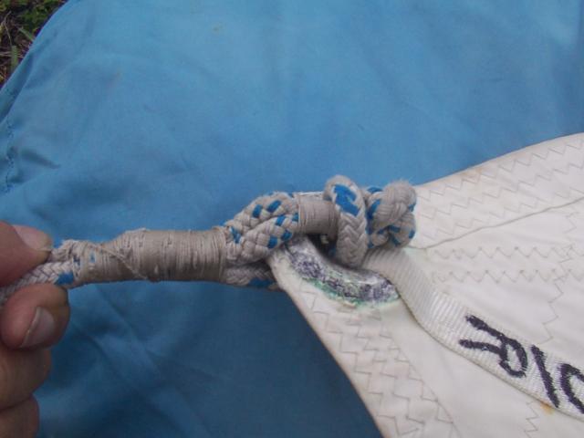

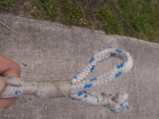

8,160
I like the meb135 solution. Tight eye splice on the sheet and soft shackles. One boat I sailed on this summer did that and it was clean and did not hang on the shrouds in tacks. Bowlines are going the way of ski runaway straps.

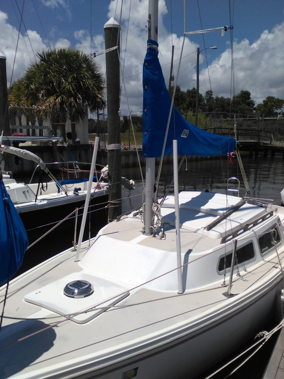

Sep 14, 2014
1,295
Catalina 22 Pensacola, Florida
Simpler fix is pvc pipe over forwardmost shrouds, knot just slides over as they rotate.

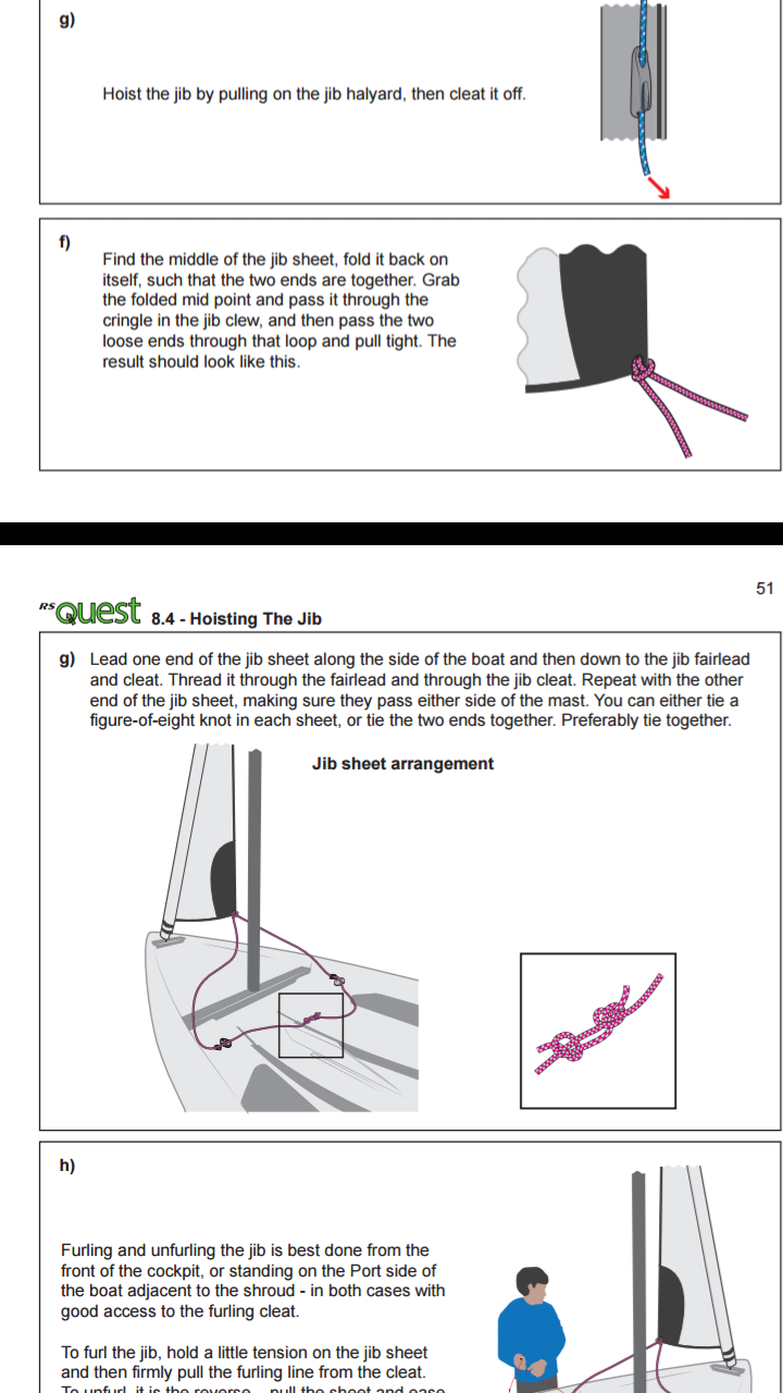

Just do a luggage tag like NYSail has suggested. I have for years with no issues.
This seems standard for many smaller boats. What do you think of tying the ends together?
Thus is from an RS Quest manual
