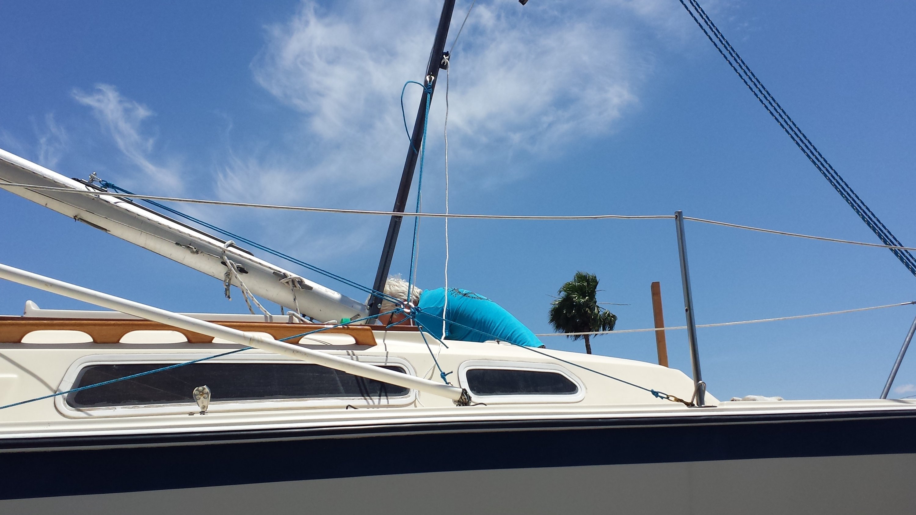

Here is my quick and dirty system for holding the mast and gin pole aligned. We named it the spider web. The five lines you see in blue are the web. The ring that they are all attached too is in exact alignment with the pivot point of the mast step. This allows the lines holding the gin pole upright and the lines holding the mast to all pivot with the mast and remain tight. If the alignment is correct you can stop at any point in the raising/lowering operation. This system allows for single hand mast raising. I did steal this idea from somewhere on the internet.
I have since welded up a new system that is much easier/quicker to install (does other functions also) and no fine tuning of the lines required. One of these days I will get around to making a video so whomever buys the boat can understand the operation.
