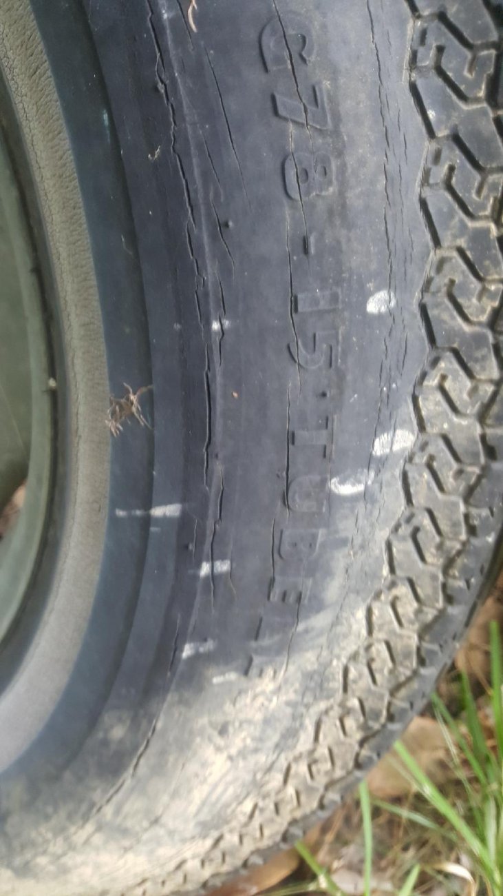

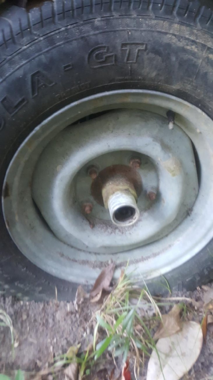

What size? Fender on trailer above tire. One tire is a C 75-15 tubeless, the other is tire is different:
215/65R15 955 Formula -GT BRAND.
Both are rotted from sitting 5 years .
Need to move and want to buy new tires with the rims attached to be.sure its safe. And where i can buy these replacement tires. Your help is greatly appreciated . Thanks loads!

If it were me, I'd avoid automotive tires and get real trailer tires designed for loads and minimized swaying.
TireRack offers them but you could do well locally too. Be sure your bearings are in good shape and packed well. you don't need rims unless yours are bent.

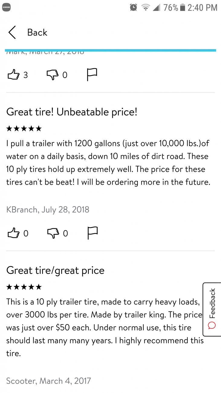

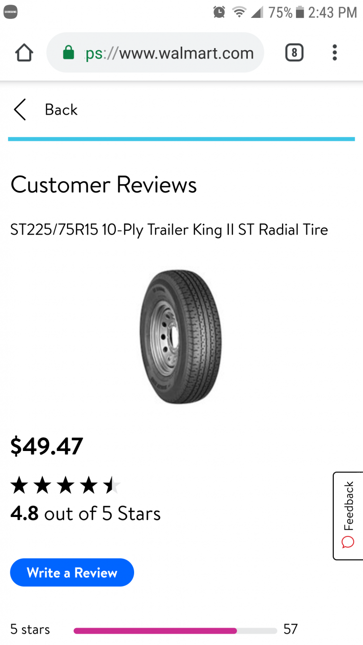

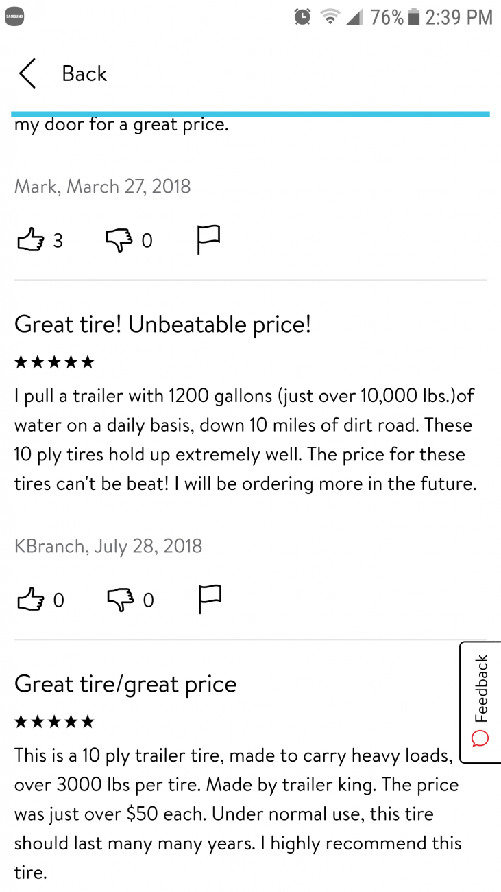

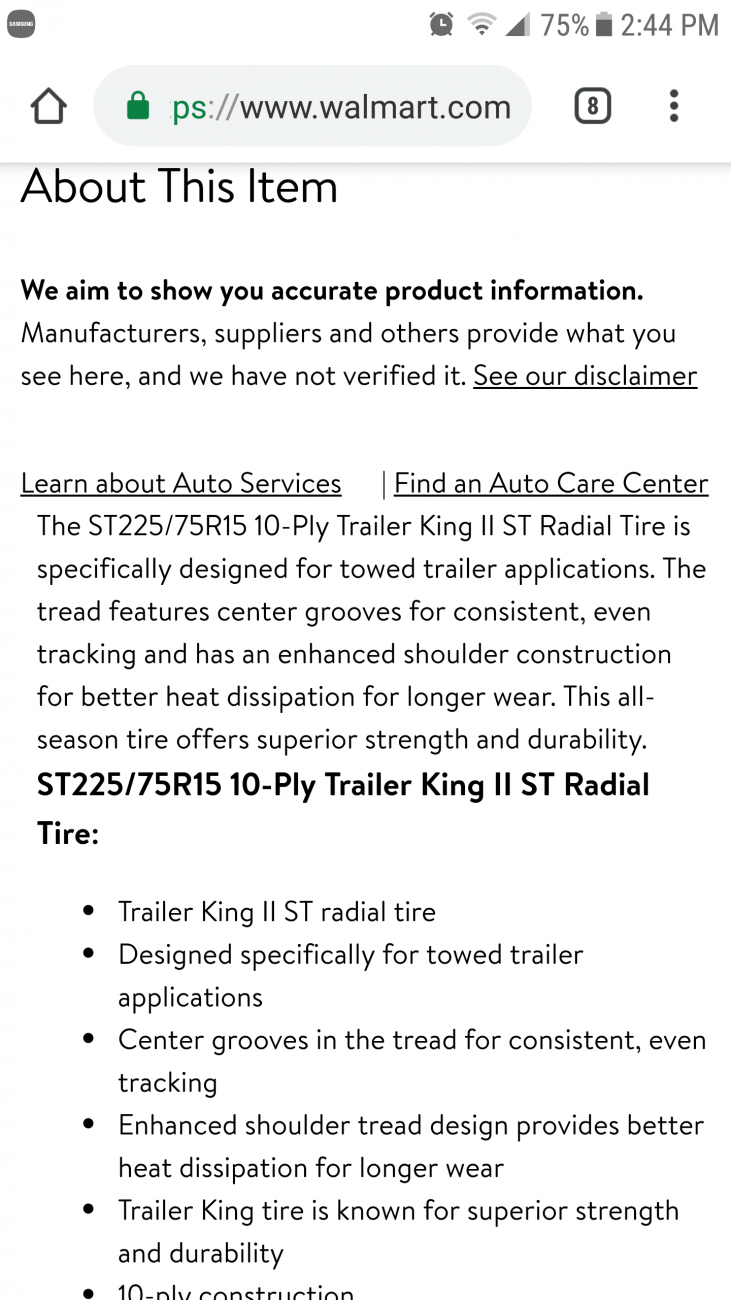

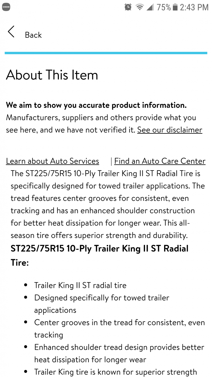

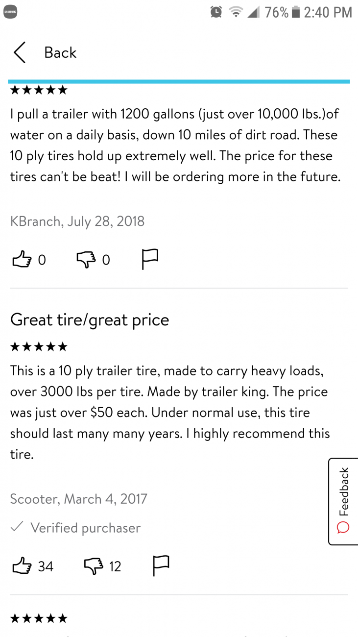

Thanks for your quick replies. While i plan to xheck out tiretrack for the tires you recommended,
I also just looked up types of tires to buy for the simgle.axle trailer and found these at Walmart, with exceptional reviews. What do you think? Know anyone who ever used this tire... from.Wallymart?

They should work fine. And you can check the fit/clearance right there on the spot.
I only reference TireRack because they have good information
