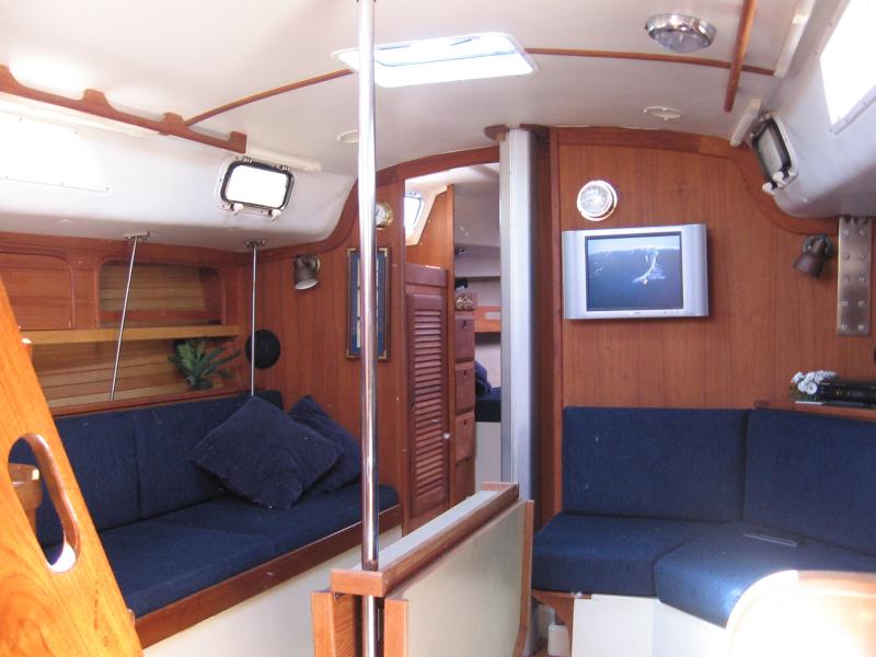

I originally swore I wouldn't have a TV on my H410, STARGAZER. But I was over-ruled by my wife & son. So we have installed a 24-inch LCD/DVD unit on the main bulkhead with wires going through to the forward berth so that they're not visible. We also have 19-inch units w/DVD in each of our berths. We tried external antennas but only received 3-4 channels from a cabin-top unit. Then we decided to upgrade to DirectTV. We have an HD dish on our home dock and carry a smaller dish to put out on cruises. We clamp it to our transient dock at 315 degrees magnetic and the inclination is fixed. reception is awesome! Great for those rainy days! Capt Bill on STARGAZER

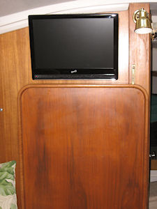

That's where mine is located. A wall mount 22" flatscreen right on the bulkhead of the v-berth with large support washers on the other side. It's a regular 120VAC plugged in the wall outlet aboard. Haven't had any moisture issues in two years (Samsung) although with the price of small flat screens, it's not a big issue if some future replacement is needed.
I don't use it much except when all of my sailing neighbors are stuck in the marina during a rough northeaster. Then it's whatever football game we can find with a few cocktails! Good luck.
