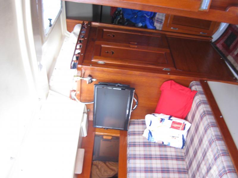

We installed a 15" LED Supersonic 1512 TV with DVD. It is still available from Amazon. It runs on 12V or 120V and accepts a variety of inputs (HDMI, VGA, USB, etc.). I found an antenna that looks like a sheet of paper that works most of the time. With digital, anytime you move the boat more than 4 feet you have to re-scan the channels.
Here is the link to my post earlier this year with mounting details
http://forums.hunter.sailboatowners.com/showthread.php?p=979594&highlight=allan12210 tv

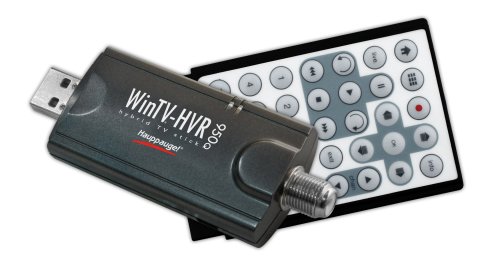

If you use a laptop onboard, think about what we do: a USB HDTV tuner. Antenna is a powered omnidirectional model similar to what Rich showed in post #13. Laptop has a 15" display and a built in DVD, and this little piece of hardware and some software provide TV at a location about 35 miles away from the transmitters.
We do the same using a ....
Hauppauge 950...
http://www.amazon.com/Hauppauge-1191-WinTV-HVR-950Q-Personal-Recorder/dp/B001DEYVXO
...for the past 2 years in the yard for about 6 months total with probably the same amplified antenna that we set on the cabin top. It runs direct off of 12 volts as well as the computer.
This is on a 15"-16" laptop. We have thought about taking Ruth's 23 inch flat screen monitor from home that she uses with the laptop there along with a wireless keyboard and mouse. It also runs on 12 volts direct or on the 120 brick. So far we haven't taken it with us and so far have not used this out on the water but I think the station we are using in the yard for NASCAR is some distance from the yard.
We will continue this combination as it works well and we also watch Netflix in the Yard with our long distance WiFi on the same laptop,
Sum
