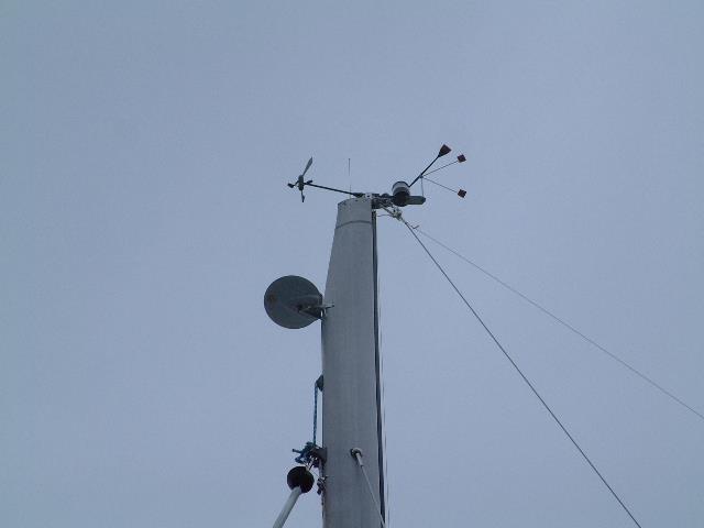

Back in in spring of 2000 I installed an omnidirectional TV antenna called an "UFO". It is powered via the signal cable and has worked perfectly to date. There is a new updated model that can be seen here:
http://www.majestic-global.us/tv-fm-antenna/28-tv-antenna-ufo-x.html
Below is a picture of my antenna. It is about 5-6 feet from the top of my mast, so that puts it at about 57 feet off the water. I get good reception most of the time, but occasionally the picture drops out for un-explained reasons. With digital signals, the reception is either perfect or non-existent; there is no in-between. I have no idea how well the antenna would work if mounted lower.
