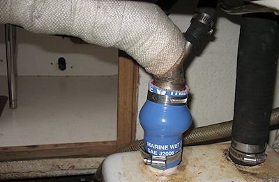

I believe I need to replace the hose running from my engine to my muffler. The piece in question is very short and rigid and I don't see how I can get the old one out and the new one in.
I have enclosed a picture. It is taken after I took out the aft seat around the dining table. The hose in question goes vertically from the muffler (it's the hose on the starboard side, the left most one on the picture) to the engine (Universal M3-20). It actually connects with a hose wrapped in foil. The foil hose and the muffler are solid in place. I suspect each has a 1-2 inch coupling extension. The hose I'm taking out is maybe 7 inches long and very rigid. I don't see how I can get it out without breaking it. I don;t see how I could get a new one in to replace it.
What am I missing?
-should I just brute force it in and out?
-Can I move the muffler?
-Can I move the foil covered hose coming from the engine?
-Is there another way?

Just replaced mine. Lubricant the inside of the hose with soap and use a heat gun to heat the hose and make it more pliable. Good luck.
23,525
Never, ever, use that type of hose in that location again.
Go to www.catalinadirect.com and buy HUMP HOSE, 1 5/8" diameter. Use that. It's pliable and will allow you to install it and, as a bonus, it keeps the lip of your muffler intact. That old black hose transmits too much vibration.

Stu is absolutely right about the hump hose being the way to go. I did it when I replaced the motor mounts on my boat. I had to cut the old hose out. On my engine (25XP) the exhaust manifold had to be removed to install the new hose which had to be cut down to fit. If you do have to remove the exhaust manifold soak the bolts for a week in PB Blaster and you'll need to pick up a gasket kit (also Catalina Direct). I'd also order the correct stainless clamps. That's not a hose you want to fail.
Here's what it looks like installed
It's an awkward spot to work, so go slow and allow yourself plenty of time and you'll be fine.

Something I learned from an old hand is "there is nothing you can break that you can not fix." On my boat you can unbolt the muffler from the wood block that is tabbed to the hull and move it about after removing the output hose. Looking at your photo I would hesitate to move the engine hot pipe and mixer as it looks aged and may be corroded. If you do need rebuild the hot section you can buy sched 40 iron pipe from McMaster Carr and an new mix elbow and pipe wrap from Moyer Marine, I built a new hot section in about an hour, easy, as stated above the hardest part is the manifold connection.
