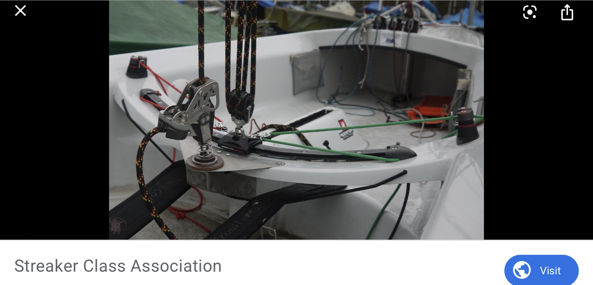

Jun 25, 2004
1,109
@LeeandRick
Could you please post a picture of the curved traveler? It’s unusual to see a radiused traveller except for self tacking jibs.
Thanks.
Judy
RussC
Sep 11, 2015
1,734
Merit 22- Oregon lakes
@LeeandRick
Thanks.
Judy
I'd also like to see that. specifically how the traveler line are routed along a curved track

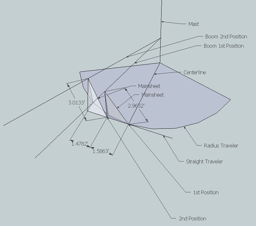

If we dont get a picture ill have to google sketchup and prove that out.. Does this traveler curve around the boom or curve up over the cabin top? Some trimarans have humongous travelers / mainsheet tracks.

Sorry you guys I've been out sailing in the plus 70 ° weather and haven't looked at the computer. I'll get a picture tomorrow. The S2 8.0C (center cockpit) has a radius on the aft coaming, behind the wheel, that matches the radius the boom makes at it's end. End boom sheeting. The boom could be 8" longer to bring the sheet directly over the traveler to relieve torque forces on the traveler car. I'm going to build a carbon fiber boom extension this spring to eliminate this issue. I would buy a new boom (or used one if I could find one with similar moment of inertia) but we already have $20K in a 45 year old boat that would sell for $7000 and I have the cloth and epoxy laying around. But hey, this boat is a fun hobby that keeps my 66 year old brain active:cool:.

One thing that was not mentioned (I don't think) was easing a straight traveler and how it will increase leech tension due to the radius of boom travel. I never paid much attention to this until our current boat where the traveler track is curved to the same radius of the boom travel. This allows us to change angle of attack with no changes in the sail shape.
That's pretty cool. I hadn't thought about that. If a sailor starts at position 1 with a level boom, and arbitrarily moves the boom out some angle to position 2 with a straight traveler while keeping the boom absolutely level, it will require more mainsheet. On a curved traveler then angle of the mainsheet stays the same with each position change.

Since my boat lacks a traveler, I have no experience using one. I also have a lot to learn about sail shape. So if the (straight) traveler is eased, and not the mainsheet, and leach tension is thus increased. what effect does that have on sail shape and performance?
Mar 26, 2011
3,990
Corsair F-24 MK I Deale, MD
A perceptive question. The answer is it depends on the geometry. It can go either way.
If the sheet is tight and the sheet is perpendicular to the boom or angled forward, the leach is tightened. BUT, if the traveler is being eased a few inches or a foot because of a strong gust, and the sail is polyester, the leach probably stretched a little. No change. Also, the difference in sheet length cause by easing the traveler a foot is a fraction of an inch.
(The sheet is angled aft--easing the traveler eases the leach. It's not actually angled that far--parallax has distorted the image.)
If the sheet angles back (many do) the sheet actually is eased, but again, only a fraction of an inch. If you have laminate sails (I do) this is probably a good thing.
If a straight traveler is eased a lot it generally tightens the leach, but most often this is done off the wind and the sheet is eased anyway.
A curved main traveler is neat, but I'm not sure the advantages are important. A curved traveler on a self tacking jib is different--it really helps, since the sheet is always angled forward.
