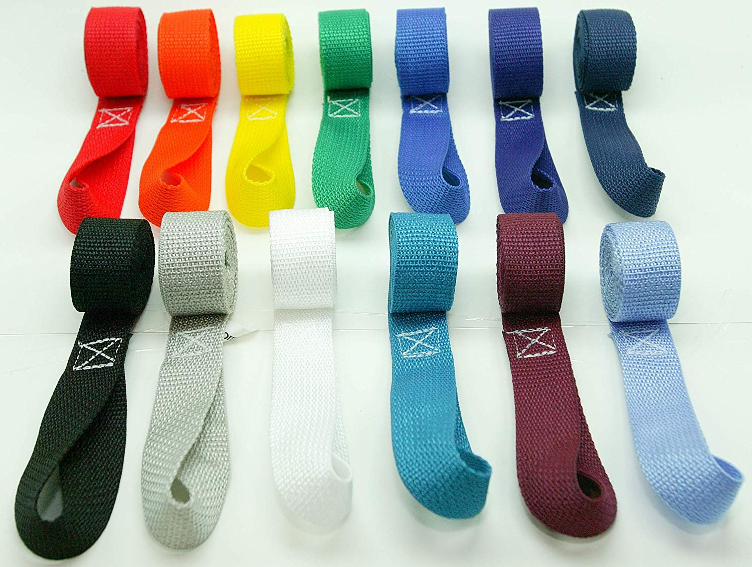

I absolutely agree this is exactly what should be done if you need to rapidly ease the main My “concern” was with what appeared to be a constrictor knot around the mainsheet purchase. If the “loop” slows or snarls the release in an “emergency” bad stuff could happen. Perhaps a large loop soft shackle that would go around the mainsheet and be attached to the strap in the photo might be a safer alternative.
As I mentioned above, that is my sail tie and it is not a constrictor knot. The loop is sewn so it cannot pull any tighter. I agree with your concern and a slip knot around the mainsheet would be a bad idea.
It is one of these...

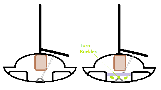

There is a U-bolt on the floor of the cockpit and the main-sheet attaches there and is led to a bail mid-boom. My idea for the Barton-like traveler would be to secure the traveler between the cockpit benches directly over the U-bolt and then transfer the load from the traveler to the U-bolt using turnbuckles.
Good thinking there @rgranger . if the oem u bolt was strong enough to begin with then it's certainly strong enough to hold the new arrangement. :thumbup:

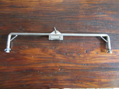

@jimshipsky keep in mind that the location of the traveler track also makes a difference in how functional it is. Those towel-bar configurations have a very limited range because they are located on the stern. A track mounted on the coach roof has a much wider range of effectiveness because it is much closer to the gooseneck (the fulcrum). The most valuable purpose of that Cat 25 system is that it is possible to get your boom closest to the centerline even when you have a little twist set with the mainsheet. What you had on your old boat was actually worse than having a fixed point in the center for the mainsheet control. With a fixed point, you could at least get your boom nearer to centerline, even if you did have to draw it tight and eliminate twist. With your old system, without controls, it didn't matter how tight you made your mainsheet, the car was going to slide to leeward no matter what. You should have had a control on it, but lacking that, you would be better-off if you simply removed it, put a padeye on the centerline and used a vang for controlling twist.

Interesting concept. The concerns with after market installations like this traveller are the loads to which the traveller will be subjected and will it be strong enough to accept the continuous loads (sailing upwind in a good breeze) and the shock loads (an accidental gybe in a stiff breeze). While the traveller track may be strong enough, will the attachment points be strong enough? And what modifications to the cockpit structures will be necessary to make them strong enough.

Having owned and raced a Catalina 25 SK for 20 years the towel rack traveler works fine "if" you have an 8:1 vang working against a boomkicker or a rigid vang (spring). It just requires a little finesse between the controls. As far as moving sheet location be very careful as the boom is designed for a certain placement of the sheet. If you want to figure basic bending loads on a boom this requires many calculations. Even though I'm an ME I didn't do this one time, and I have a scar on my forehead to prove it. Breaking a boom is not fun.
