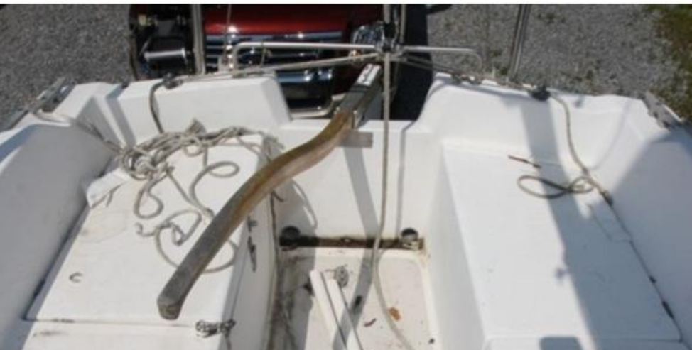

Photo of traveller setup from the Cat 25 manual found here
The car can be placed anywhere on the traveller “towel bar” that you want using the control lines. The reasons to move it are explained very well in the previous posts. I’ve found using a traveller very useful in improving the safety, performance and comfort level of the boat. The boats I’ve been on typically have the traveller mounted across the cockpit on the seating surface, I believe they are aptly referred to as $&@!! shin busters! ;) Having this on the stern is a nice touch IMHO.
