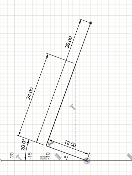

Your calculations are not incorporating the fact your body can also be leaning - the space does not get smaller, it remains the same, it's simply the angle w.r.t. the horizontal that changes. So with handholds on a cabin top in that 1 foot space you are talking about, you can use both hands, one on the cabin top and one on the lifelines.
I guess so well known: I've never heard of it, have never seen it mentioned on any references I can put my finger on, and no one on my boat goes up the leeward side when the conditions are bad. "This is a well-known issue and it is one of the main reasons that contributes to crews being forced to move forward along the leeward side of the boat and getting washed off their feet with a broach."

Consider a 1-foot wide walkway, just as an example, and a relatively modest 20 degree heeling angle.
At that angle, a 24" lifeline leaves you with only 3" of walkway. A 36" lifeline pushes you over an inch leeward of any existing walkway. At 30 degrees of heeling, even a 22" lifeline would completely eliminate this 12" walkway. So, again, you need to do the math for your boat and your tolerances. Taller is not necessarily better.
I'm not even sure you can buy stanchions longer than about 30". One would need to have them custom built.
The other consideration is that the longer the stanchion, the weaker it is. (More accurately, more torque is applied to the base as a result of leverage from force applied at the top of the stanchion.) In other words, taller stanchions break off easier, all else being equal. That is a problem when lifelines/stanchions, in general, are not really up to the task of keeping you on the boat (at any height).
