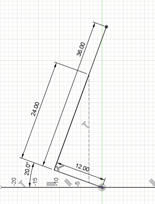

It's really preferred that your lifelines run 36" to 42" high. 42" high lifelines aren't going to get in your way while heeling....
Consider a 1-foot wide walkway, just as an example, and a relatively modest 20 degree heeling angle.
At that angle, a 24" lifeline leaves you with only 3" of walkway. A 36" lifeline pushes you over an inch leeward of any existing walkway. At 30 degrees of heeling, even a 22" lifeline would completely eliminate this 12" walkway. So, again, you need to do the math for your boat and your tolerances. Taller is not necessarily better.
This is a well-known issue and it is one of the main reasons that contributes to crews being forced to move forward along the leeward side of the boat and getting washed off their feet with a broach.
