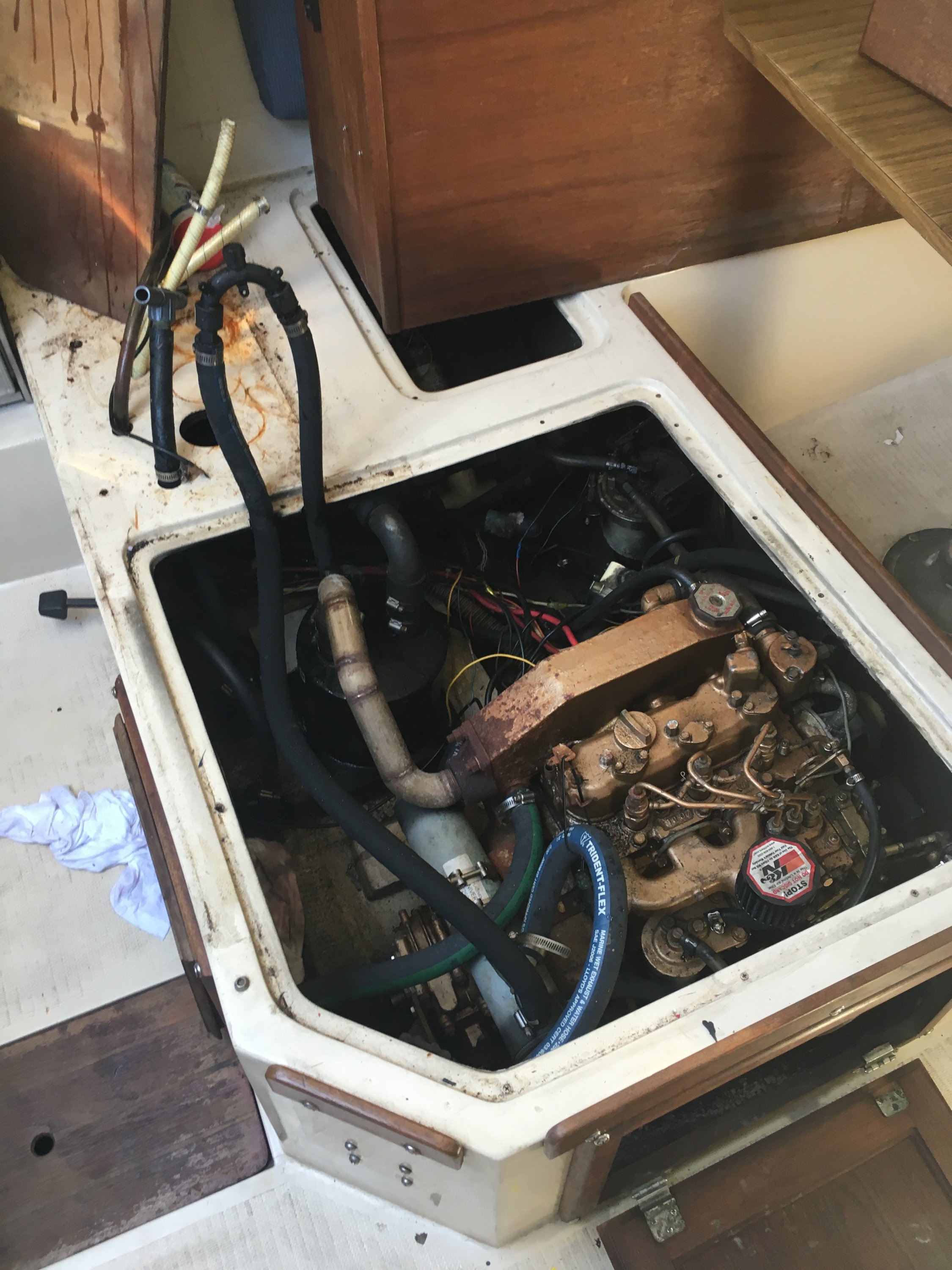

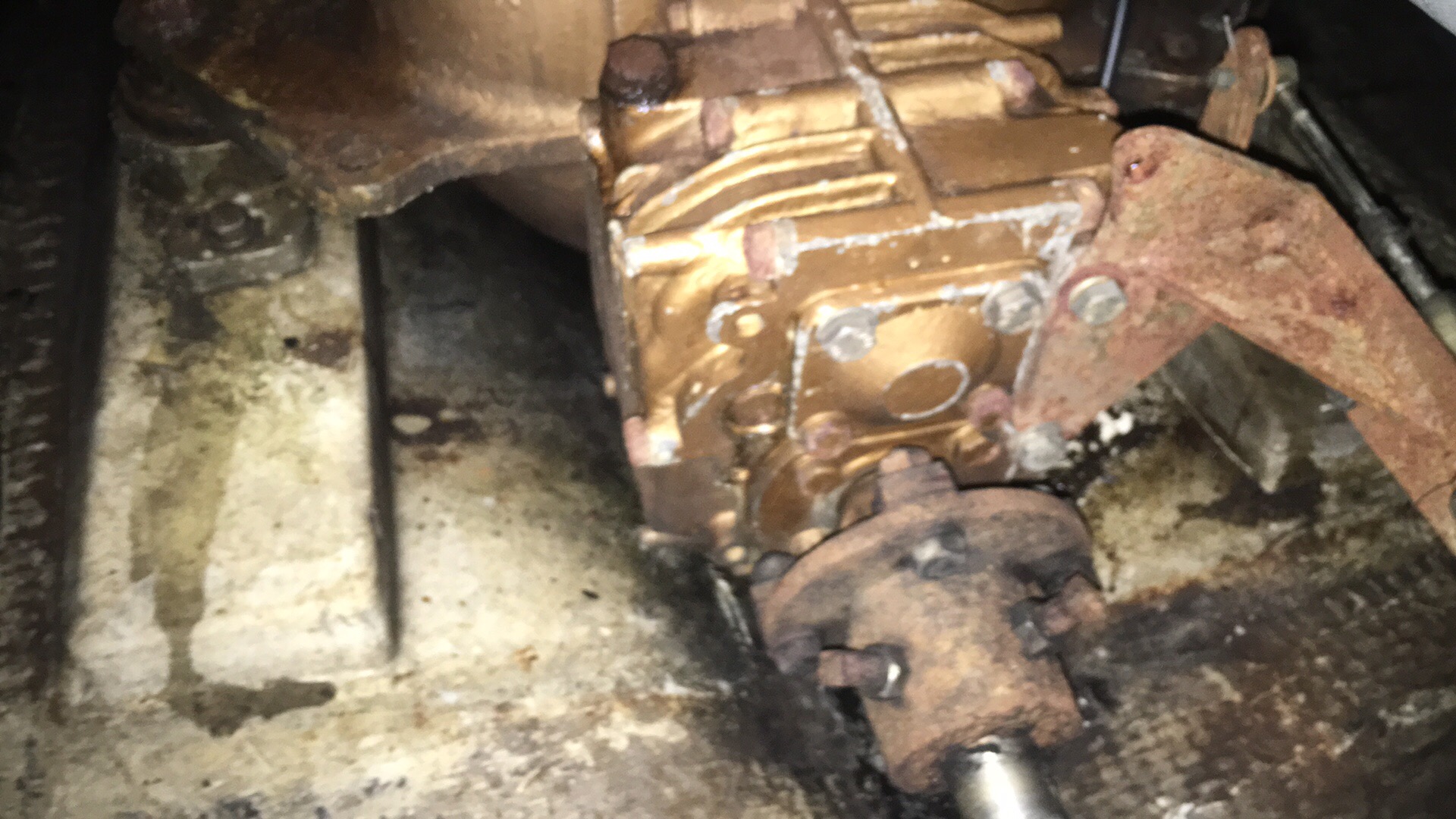

Hi all,
I have a 1984 Catalina 30 with a um-25 and hurth hbw-50 transmission. Yesterday I was sailing under power. I noticed eventually that my speed had dropped severely and there was smoke from the transmission.
I let it sit for awhile, removed a cable that burned up because it was laying against the shaft, and re-started the engine. This time I was able to get back to normal speed for about 20 minutes (heading home, no wind) before it began to smoke again. I realized that the shaft was rotating much slower than normal.
I decided to bypass the shift cable and operate the shifter arm manually. After this I was never able to get the shaft to rotate fast enough in the forward direction. I was however, able to operate the boat as normal in reverse. I reversed for another 20 minutes and made it safely to my slip.
This morning I woke up and tested the transmission again. This time, no matter what gear the boat is in, the shaft does not turn at all. I haven't yet tried turning the shaft by hand.
Any thoughts? I'm dreading the prospect of replacing the entire transmission.
