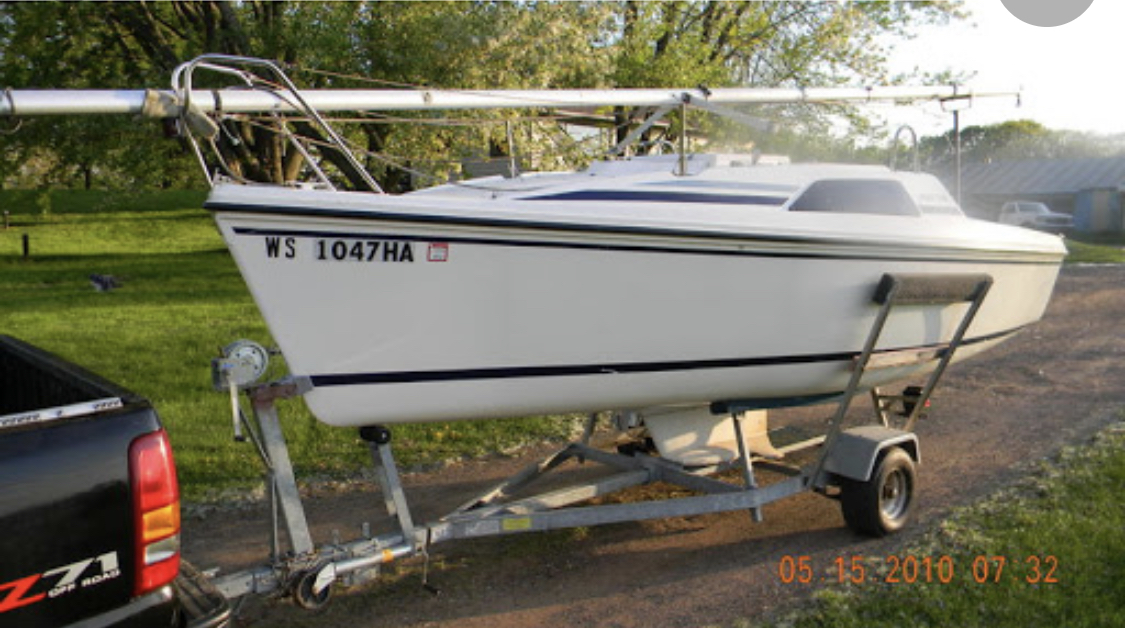

You asked for ideas so....
I assume you are towing your Hunter 18.5 so on a trailer it looks like this.
I can only assume the wing keel sits on some kind of tray but is it possible to move the brace that holds the winch and bow stop forward a bit and keep the keel on the tray?
At 1600lbs the boat is not a monster but having the trailer balanced correctly can make quite a difference.
Good move in getting the correct height on the tow ball.
Carrying your spare tire near the hitch will add some tongue weight.
Reluctance to move motor if that’s the only option could prove costly, just sayin :)

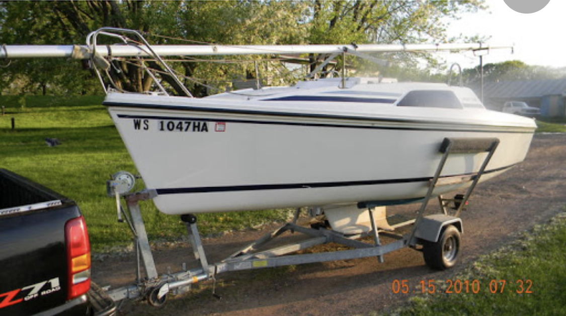

Yes our boat / trailer combo are close to identical... modifying the keel stop isn’t really an option because that would mean V at the front would have to move back ......but it’s out of room because of the tongue extension.
