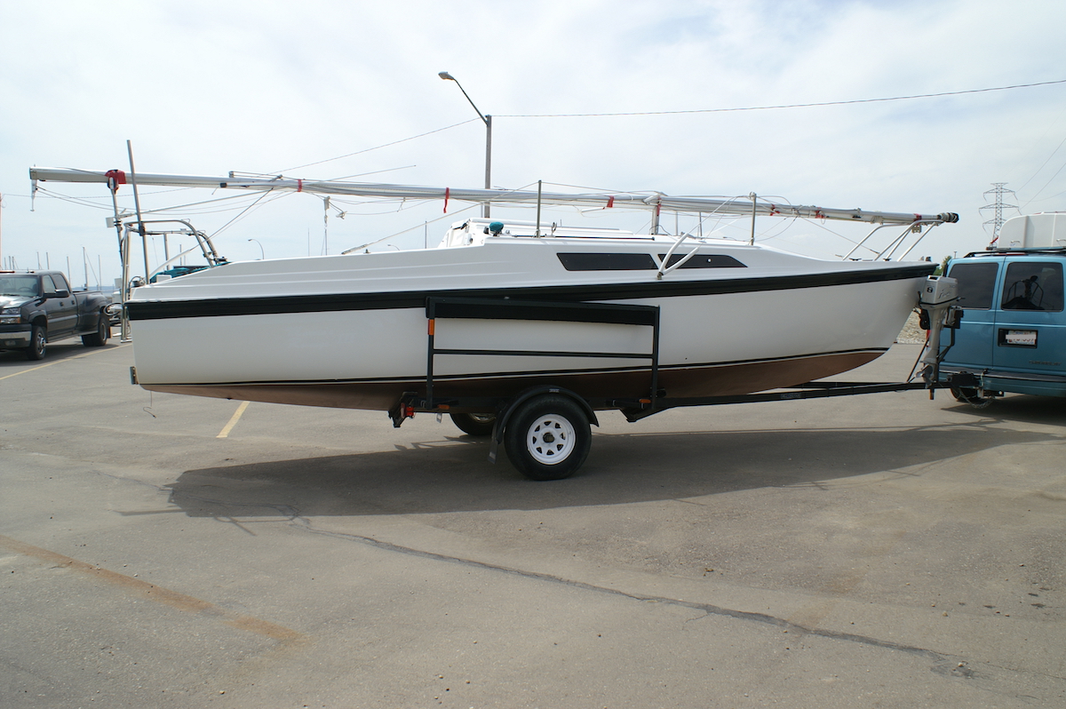

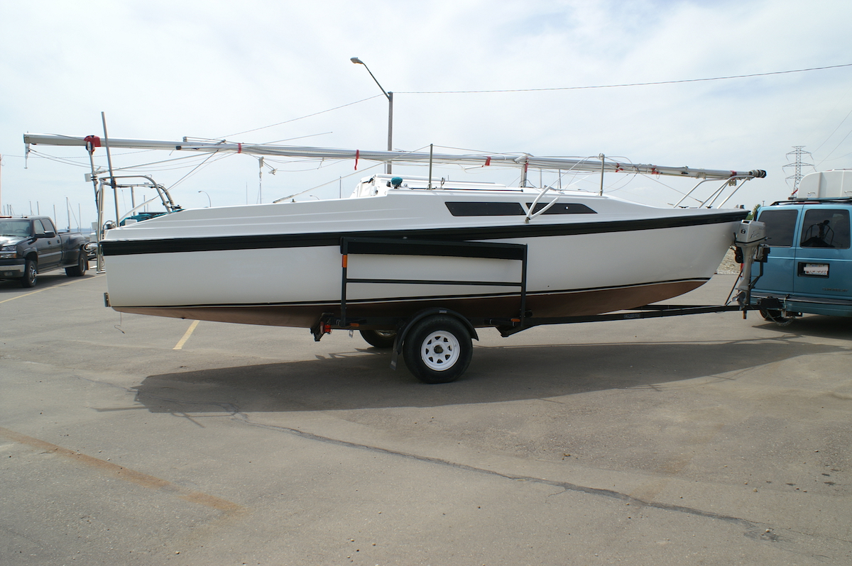

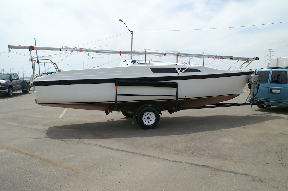

Yank the motor, and build yourself a bracket to put the motor at the front of the trailer. A simple and very effective way of loading up the front while you unload the back, and it only takes a couple of minutes to move the motor. That's what we did on our old MacGregor, and the addition of an 8hp up front made all the difference in the world. Failing that, you are moving the axle, loading the bow or getting the boat further forward.

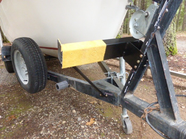

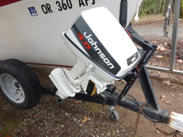

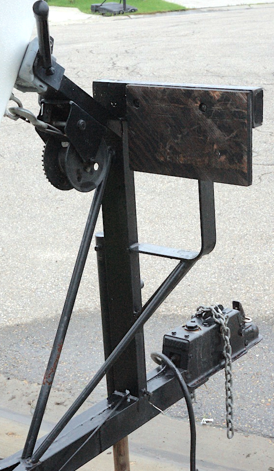

How is your front trailer motor mount rigged?
Aug 1, 2011
3,972
Welded to the bow stop. You'll notice that there is a built in step, and a rod to stop the assembly from twisting. There is a plywood bracket to use the motor clamps against. I played with the saturation of the picture to try to bring out some more detail.

I did the same thing to get tougue weigth on my C25 swing. Made all of the difference. It was also much easier on the motor mount. On the one (and only) trip with the motor in the back on the mount, my brother in law was following in his car. He told me that in addition to the terrible sway that I could feel at every bump, the motor was bouncing all over the place. He told me that he backed off an extra 5-6 car-lengths so that when it broke off, he would have a chance of dodging it.
Moving it was easy enough. unlock, unscrew the mounting clamp, lift and carry to board mounted on the tongue. When my brother in law set his boat up, he build a platform on the tongue that he mounted to outboard to laying on its side.

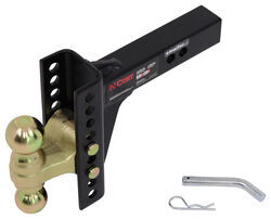

Also ordered a height adjustable receiver that will get the boat level (it’s currently sitting tongue high) which should help the weight distribution and make getting the boat back onto the trailer from the water a bit easier.
