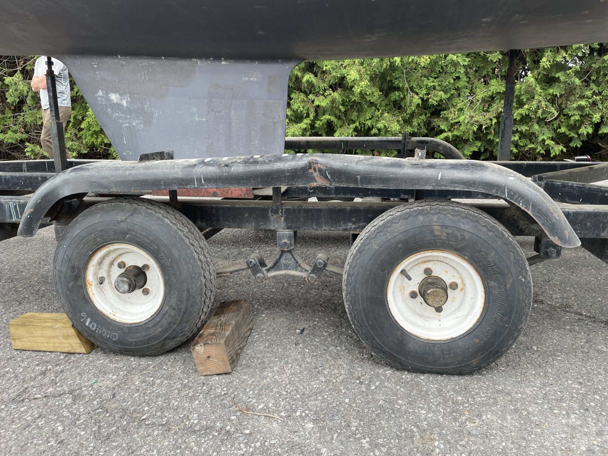

I'm looking for a used trailer for a Capri 22 wing keel version. I'm located in Ontario Canada, need a trailer to move my boat from Ottawa to Toronto.
My boat is currently on a trailer, but this has been mainly used for storing the boat in winter. Attaching some pictures to get your opinion on my options. I'm thinking of renting or buying a used trailer to take it to Toronto.

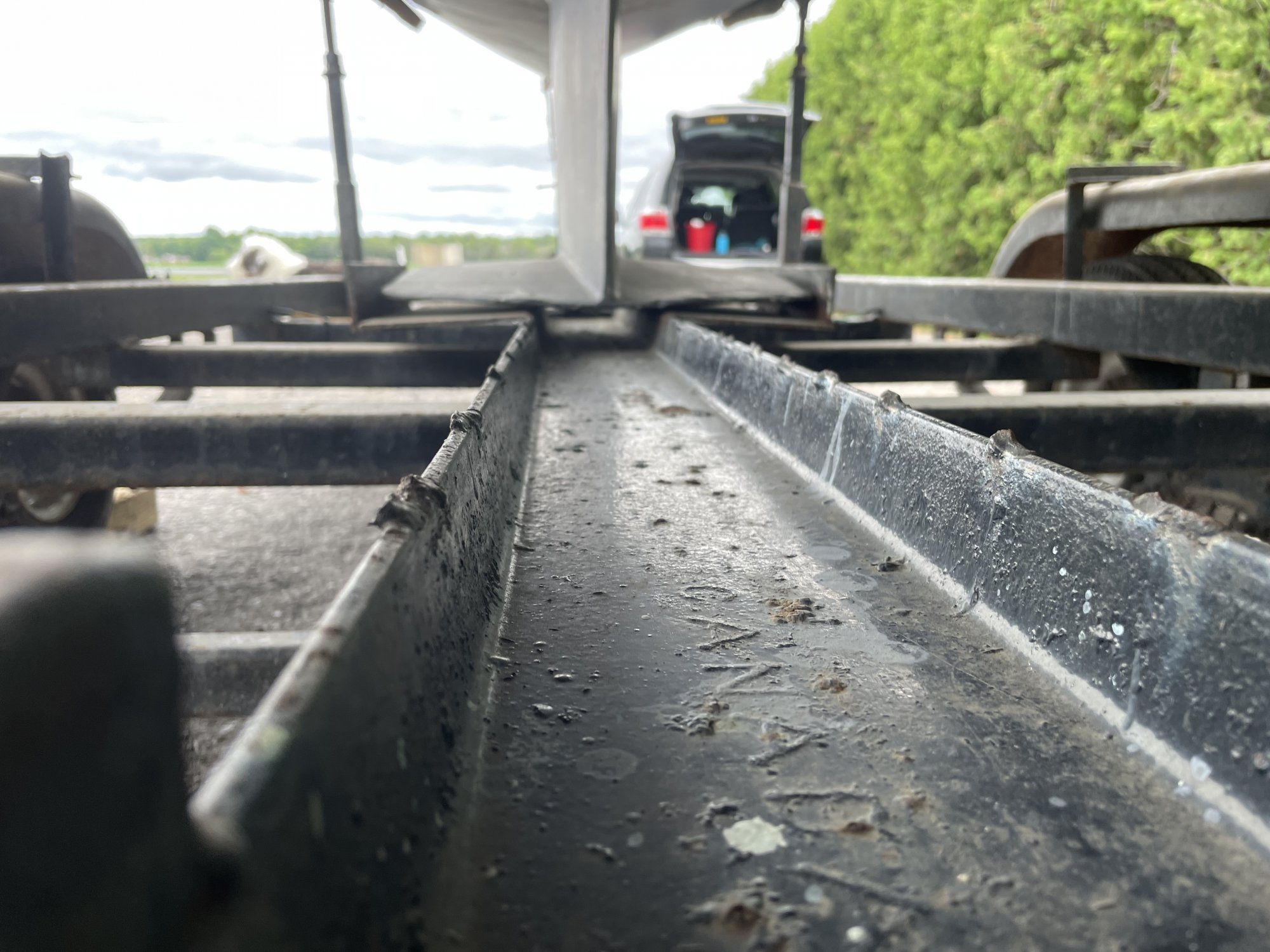

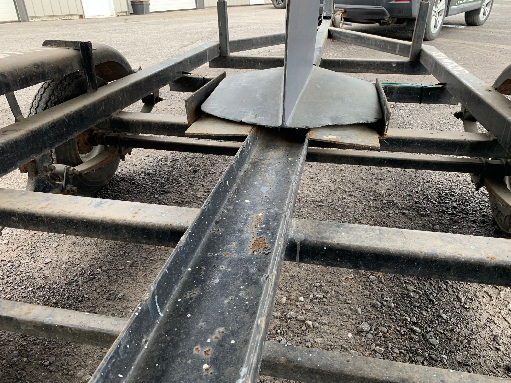

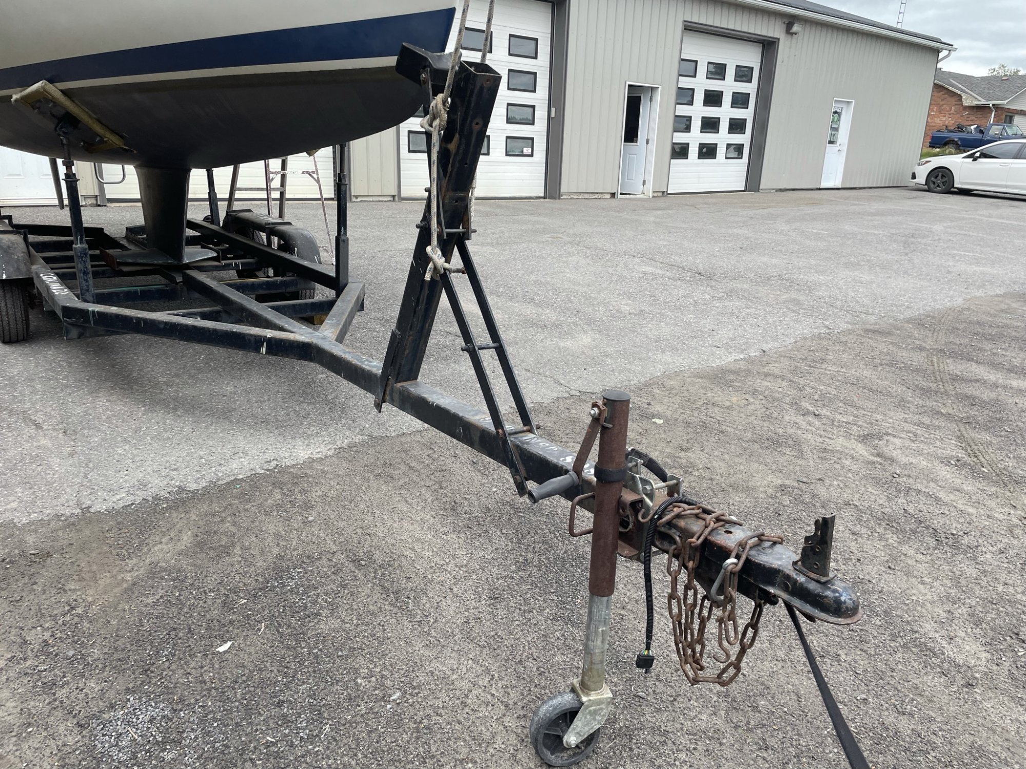

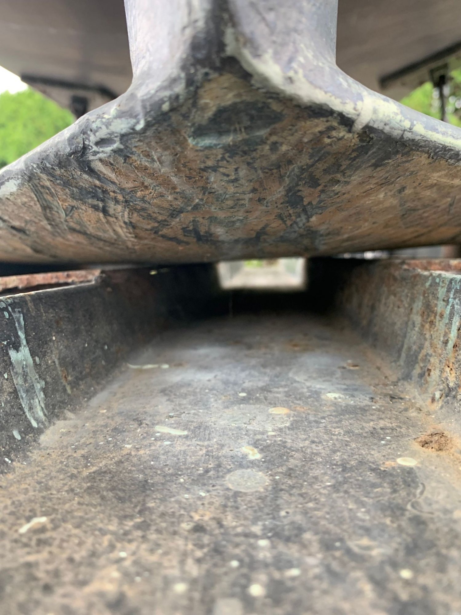

Hi sail sfbay, thanks for the very helpful links.
I already explored options 3 and 4 but they are expensive for the value of the boat.
I also think option 1, is the most immediate and cheap, but I lack the experience and contact to do make sure everything is correct. I serviced bearing on the trailer and the lights already. My main concern are: there is no winch or bow eye attachment, seems like the keel (see picture) is not supporting properly the weight of the boat. I need the help of a person that know how to place saiboat in trailer’s appropriate and securely.
If I can find someone to check/install/adjust these things I might be good with current trailer.
If you have some recommendation on who can help me with this it would be amazing.

Load range of the tires?
How many supports on each bunk board?
Brakes?
Installation of a bow eye is a must!
Lengthen winch stand post!
Insert piece of wood in keel tray for so keel will not move is a must!
Advise please

That trailer looks substantial enough for the job assuming it is in decent shape. No brakes is a small concern for the weight involved. I imagine the trailer weighs pretty close to the weight of the boat so using anything less than a full size truck might be an issue.
Repack the bearings replace if any wear is showing on them get new larger tires and a bunch of straps and I think you'd be fine.
Another option is to flatbed the whole contraption.

@Crazy Dave Condon
Tires are Max load are 915 LBS each
No brakes
There are 4 stands posts with pads in each of them
