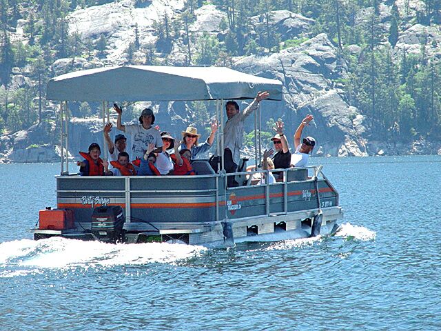

I count more than 30 on here.
That math formula comes out to 17 people on my 32 foot sailboat. That would be 3 people sleeping in a berth. That formula would not work on my boat and I know of another boat it did not work on, with three dead.
