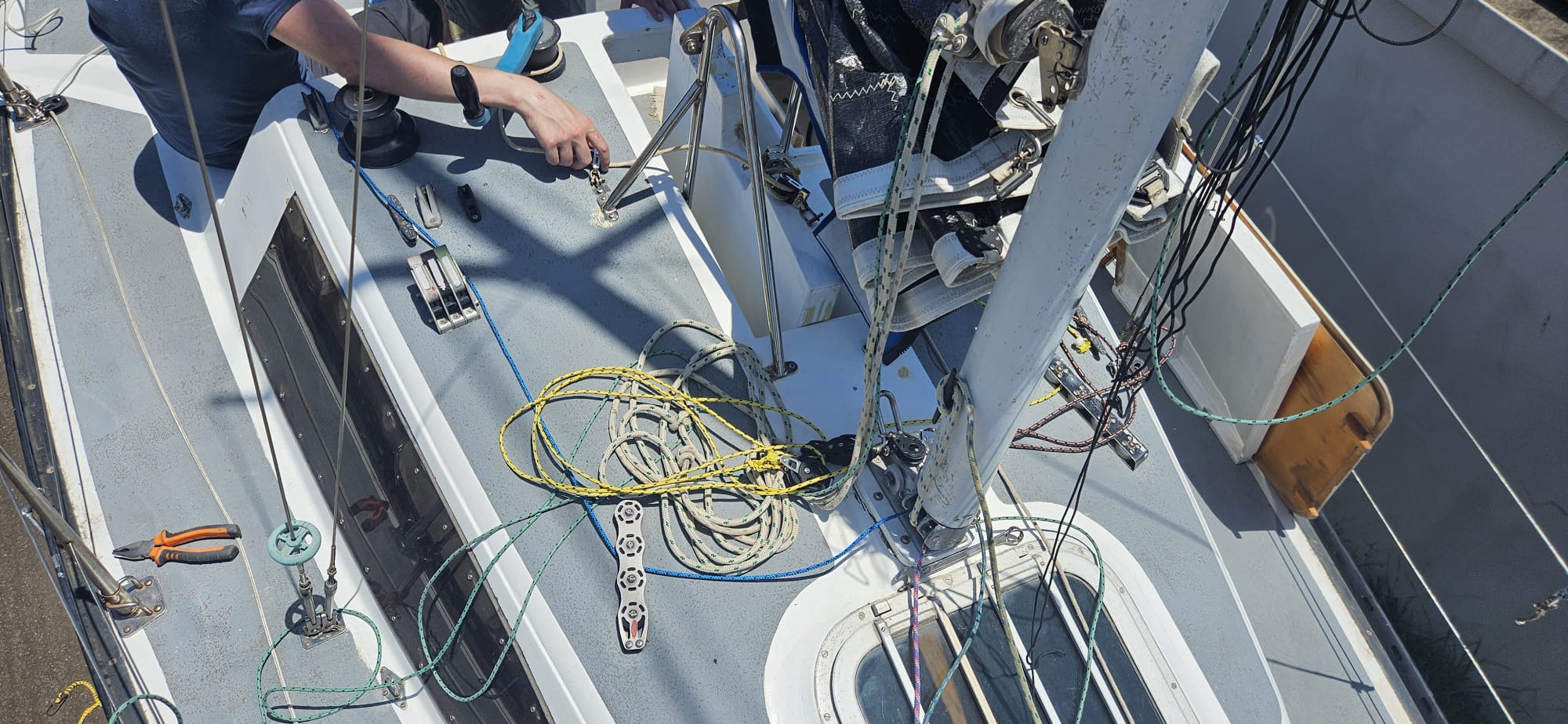

I just bought a Seaway 25. The previous owner was mounting the Jib and Genoa with different way than what I am used to and I am actually thinking about putting tracks in to make things little bit more standard.
Looking at Ronstan 25 Alloy T track 1m long on each side.
Based on these measurements and pictures, would anyone be able to advise where approximately they should sit?

Deck photo

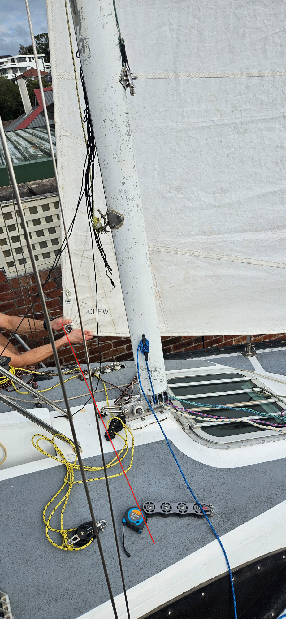

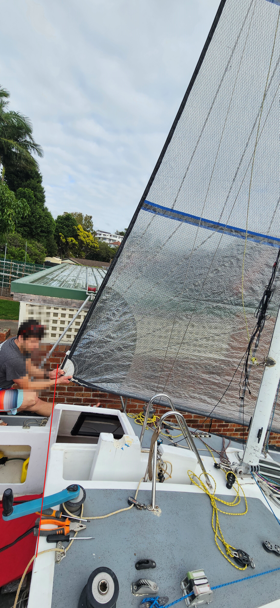

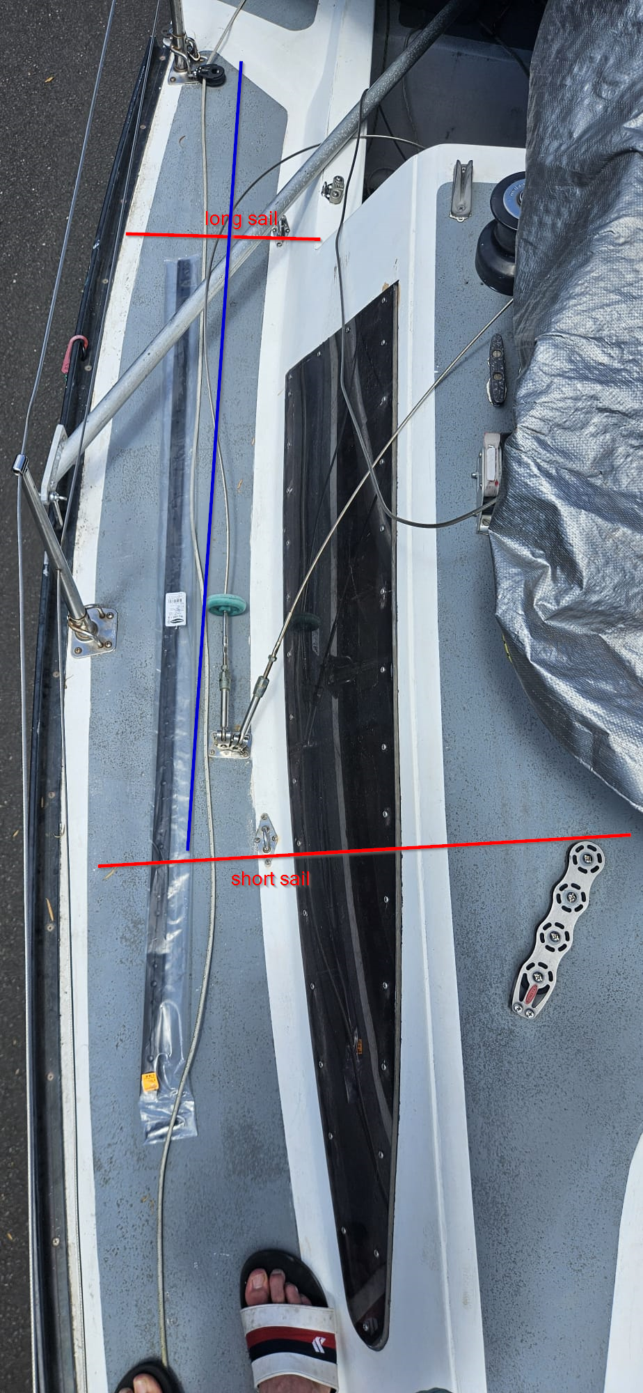

I've checked both sails and I've marked the position of the clew on the picture (red). The shorter sail foot is 270 cm (white) and longer (black/transparent) is 380cm, so there is approx 110 cm between them. This measurement is just the clew and not the midpoint + clew as you described.
Considering the length of the longer sail one and position of the shrouds, I am not sure whether there is much benefit pulling the rail towards the stern since the shrouds are going to be in the way anyway + if the sail is inflated, the clew will be pulled towards bow.
So I am Considering 25mm x 1.5m length track which may be placed more in favor of the shorter sail rather than the longer one. If it starts where the shrouds are (picture does not reflect this, but the blue line does), that is going to give some space front from the optimal point (since that one may be 30 or 40 cm further to the back). That would then also then probs reach optimal point of the longer sail (nearly).
I think this seems to be most sensible considering the deck angle where 2m track might be too long. Thanks.

Depends on the size of the smallest jib. If it overlaps the shrouds, the track needs to be outside of the shrouds.

A straight track can be bent as shown in the photo that dlochner posted. The genoa car manufacturer can provide you with the maximum amount you can bend it without interfering with the function of the car. If the bend radius is too small the car will not be able to move along the track without binding.

Your "big sail" (genoa) will need to be set outside the stays. The side decks are not that wide, it is likely that this genoa is intended to be sheeted to the toe rail. I would start with this and see how close you can sheet it. If you want to bring the clew inboard, it might be better to run the sheet through a tweaker with a low friction ring before it reaches the jib sheet block on the rail. This will allow more variability in the 3D position of the clew for various wind speeds and sailing angles than running straight to a track. You could cam cleat (eg. Spinlock PXR) to manage the tweaker.
Adding a shorter track inboard of the shrouds could improve your tacking angle for the smaller jib.
There are boats that manage the 3D clew position just using tweakers instead of tracks. It does give more options in position but can be a little harder to set up and control. It looks like that's what the previous owner was doing with that pad-eye and tweaker. Experiment with that to see if you get good sail shape before making more holes in the boat.
