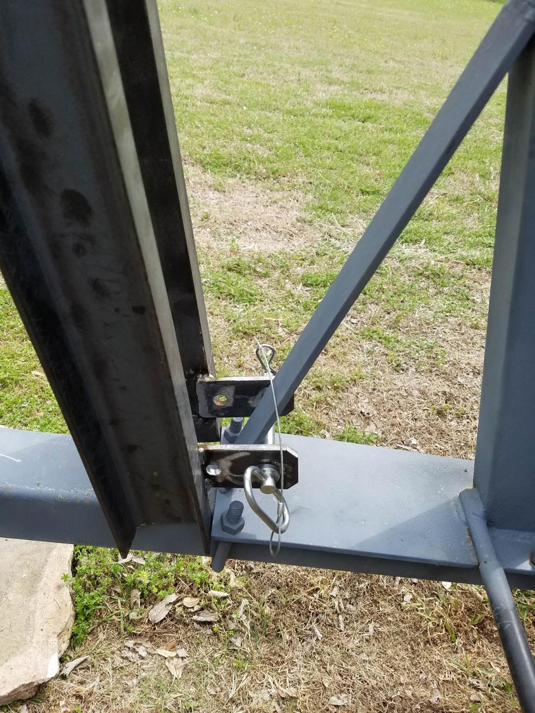

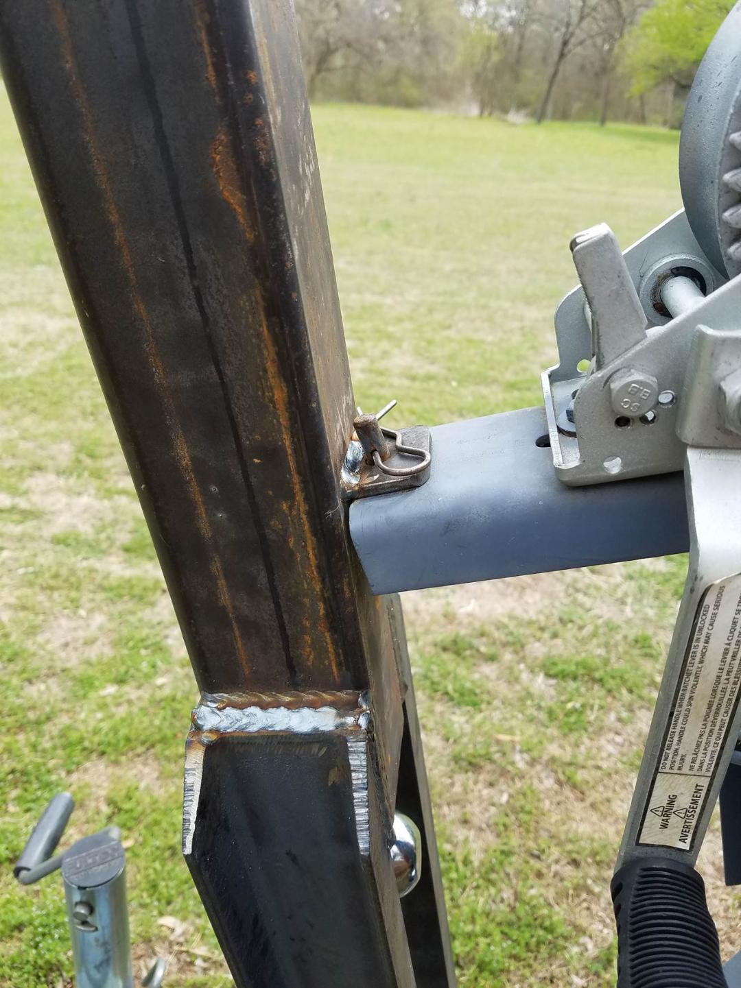

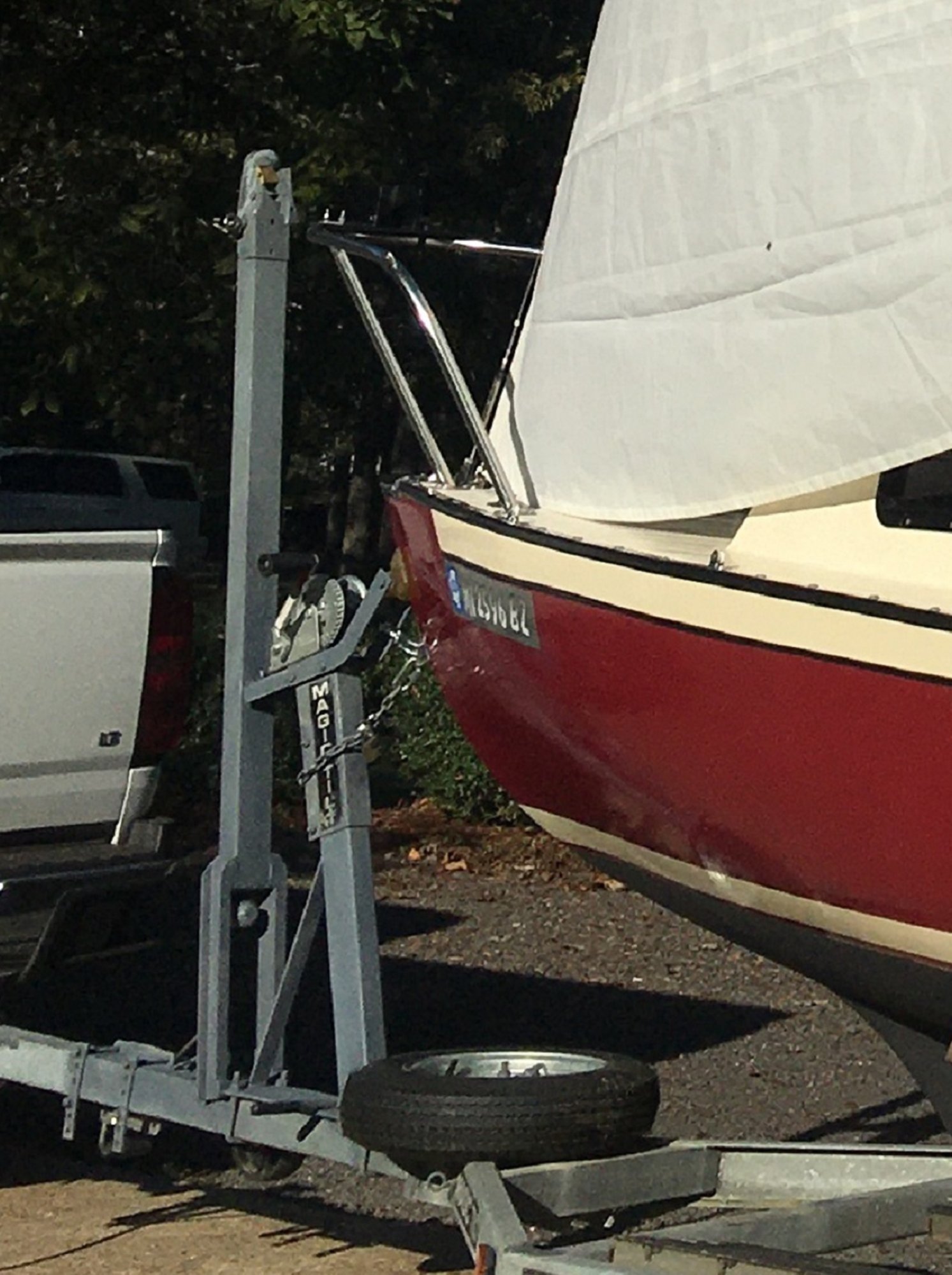

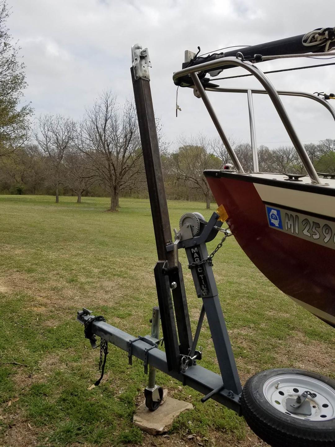

I purchased an 18 foot Victoria which came on a Magic tilt trailer with a tongue extension (not sure if it was OEM or not) but the extension disappeared while parked in the yard.
Fortunately the previous owner had sent me some pictures of the boat/trailer and one of them showed the extension so I had a local guy weld up a replacement for me.
Original from PO
My replacement

Hi Tedd,
It is really simple to use, put the extension ball in the trailer coupler, slip the rear of the extension up the trailer tongue and put the pin through the lower hole to secure it.
Looking at the new one I could have had them build it with smaller square tubing and possibly a lighter gauge, it is definitely beefier than the original.
-Brian
