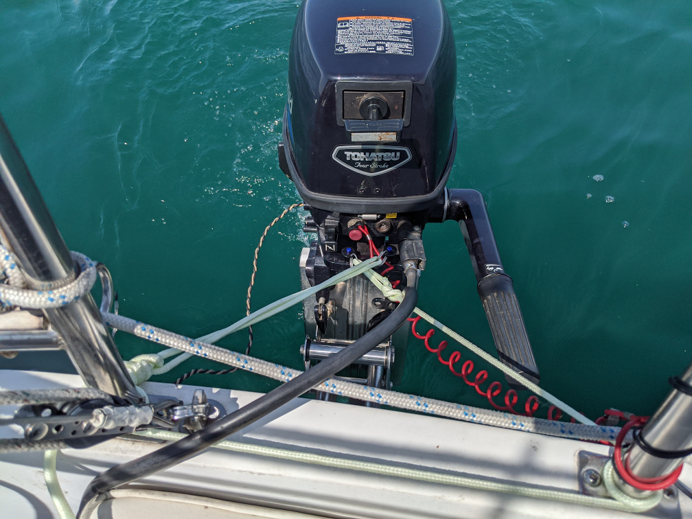

Tohatsu Stay-put
I read on some forum that over tightening the friction knob can damage the friction ring and cause other problems, apparently it's not to keep the motor from turning completely. Some para-cord and a couple 3/8" quick pins solved problem.

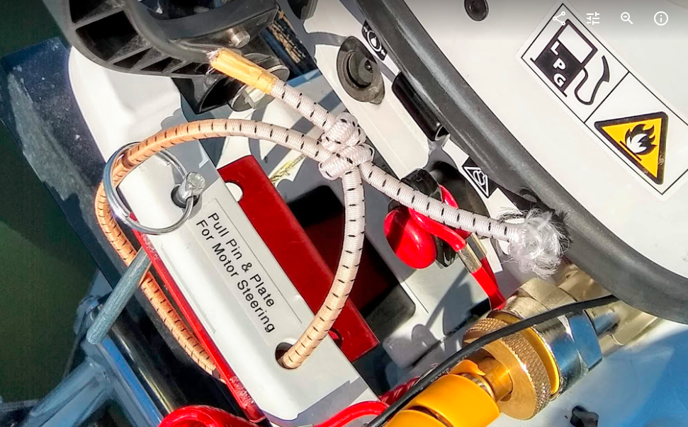

I used the locking plate plus quick release pins:
Hi, did you buy it like that or did you modify it with the locking pins? The no-locking problem is something I need to solve, but I would hate not having the ability to steer with the tiller if I needed it.
Sep 14, 2014
1,279
Catalina 22 Pensacola, Florida
So is that locking plate available somewhere or did you make it.

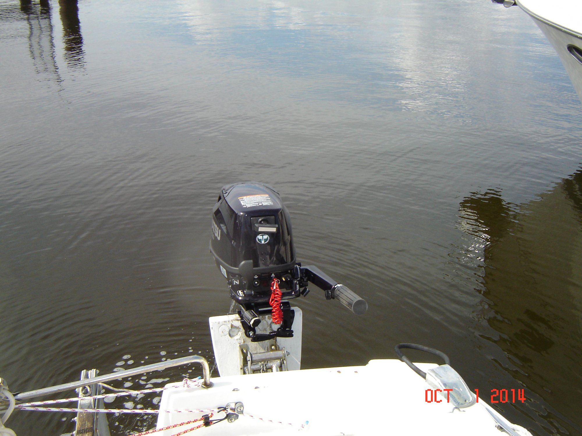

Sail pro is great, mine is 2015, never a problem, run it dry with remote fuel unplugged at dock after sail. Location of shifter at front beats hell out of all the outboards used over 40 years with side mounted shifters hard to reach when motor down to run. Alternator is great, only had one problem last year with choke control sticking, lubing it solved and no problems since. Starts on 2nd and sometimes first pull. Long shaft never cavitates. Even in rough water up wind never much run beyond half throttle, fuel use low even then.
Sep 14, 2014
1,279
By the way for rinsing, my dealer put a rubber tube from the flush inlet below the cowl terminating in a regular hose fitting with a cap, much easier to flush then flaps or bucket. See on pix closeup. White cap in black connector.
