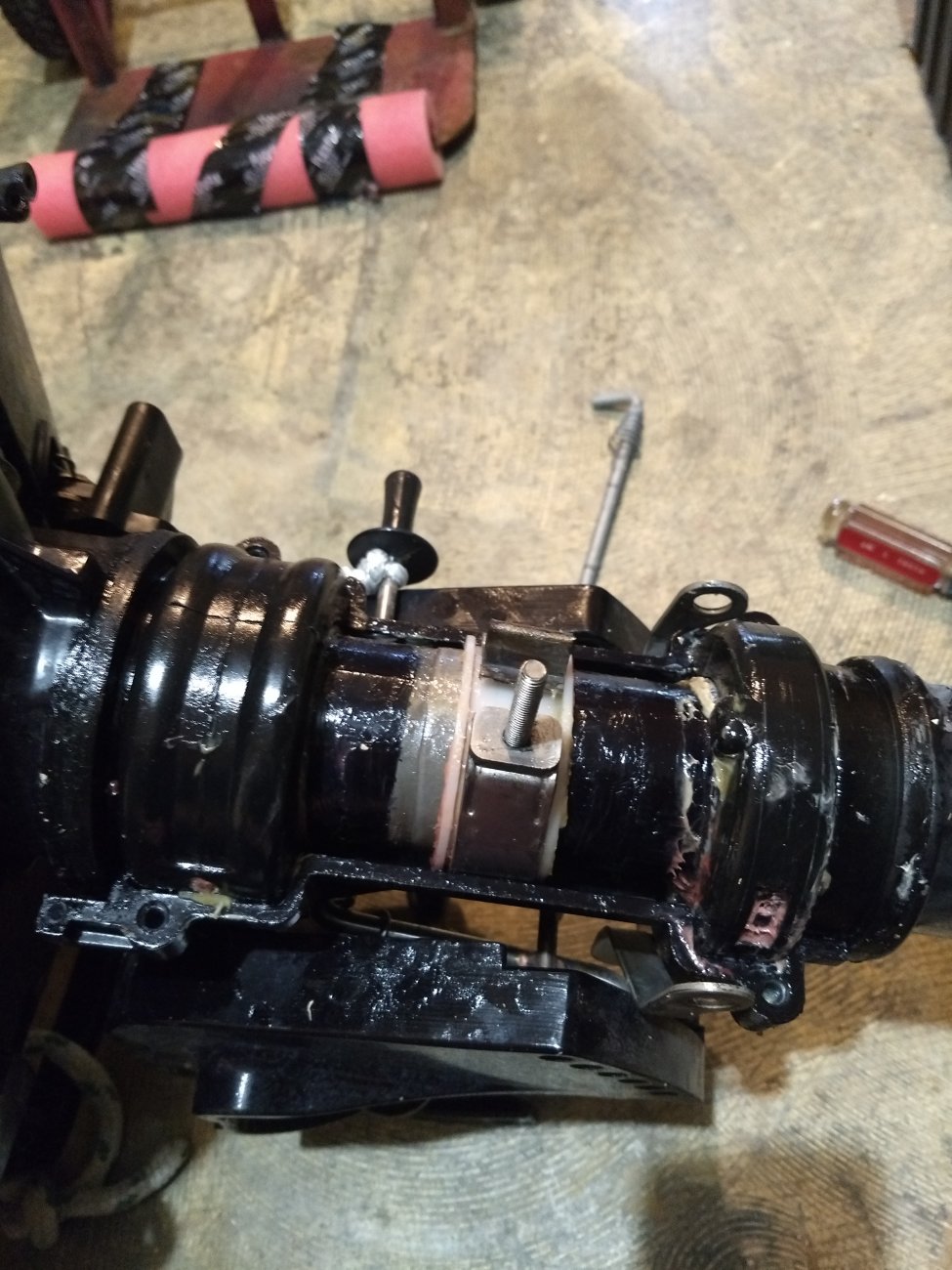

That's what I'm thinking.

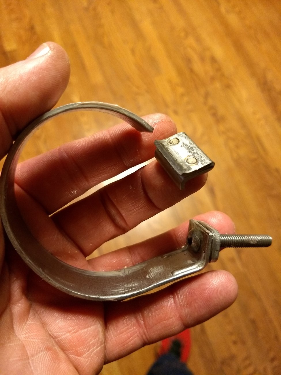

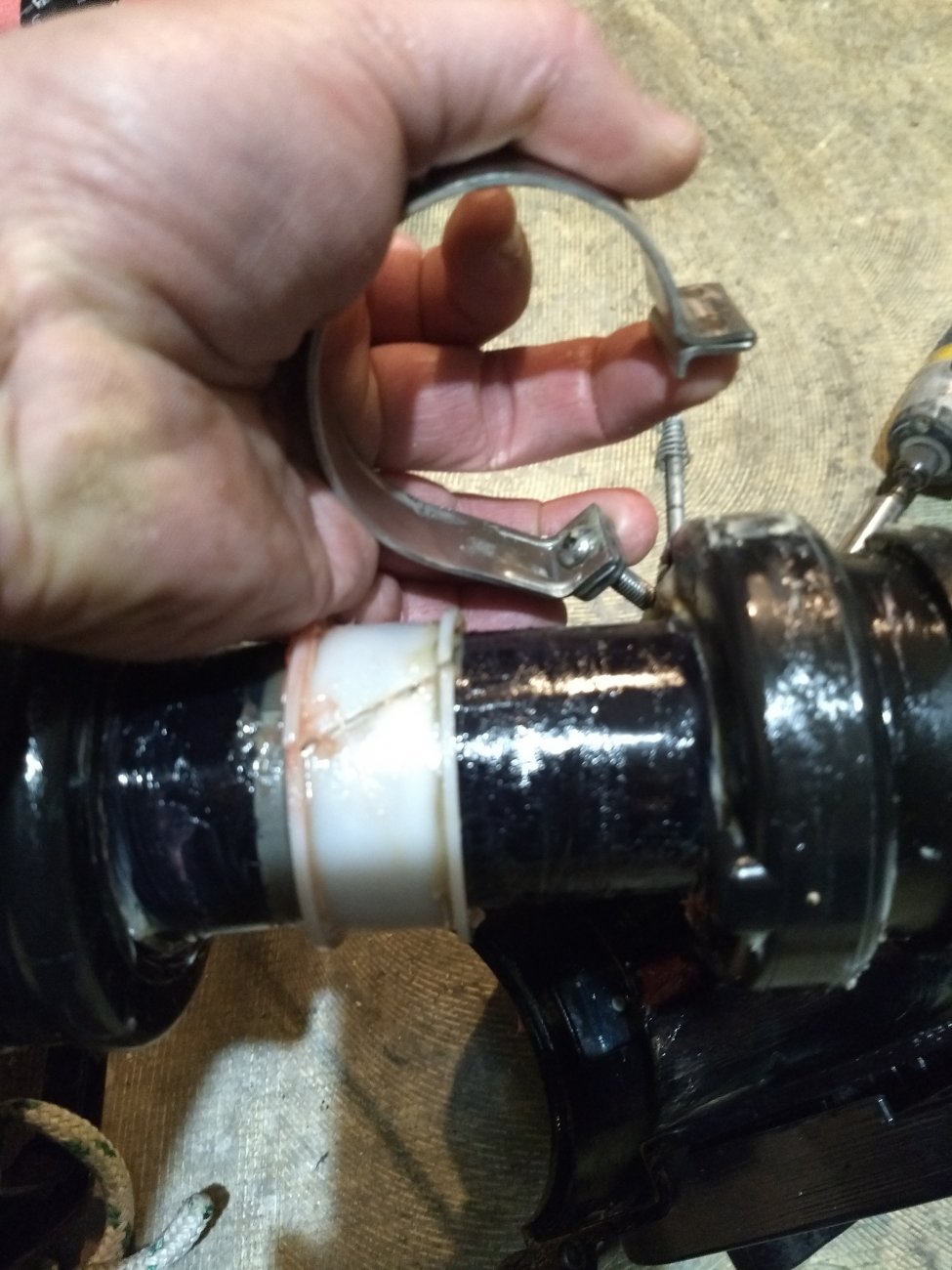

By the way, let me stress that this was taken AFTER I admittedly did overdo it a little, greasing the neck. My bad. I took it apart and degreased everything ... who knows. We've been cruising around with it like this for three years. LOL
I don't want to leave it this way forever though. I just ordered all new stuff. Hopefully I'll get another shot at gettin the friction on. :)

I noticed I had play like that too on my 4hp long shaft. I haven't had the time to take it apart yet too see what the issue is. Let us know what you find.
Sep 30, 2013
3,646
Will do. The parts are on my desk, but one of the clamp screws on the motor is seized up. Waiting (hoping) for PB Blaster to free it.
Likes: P100D

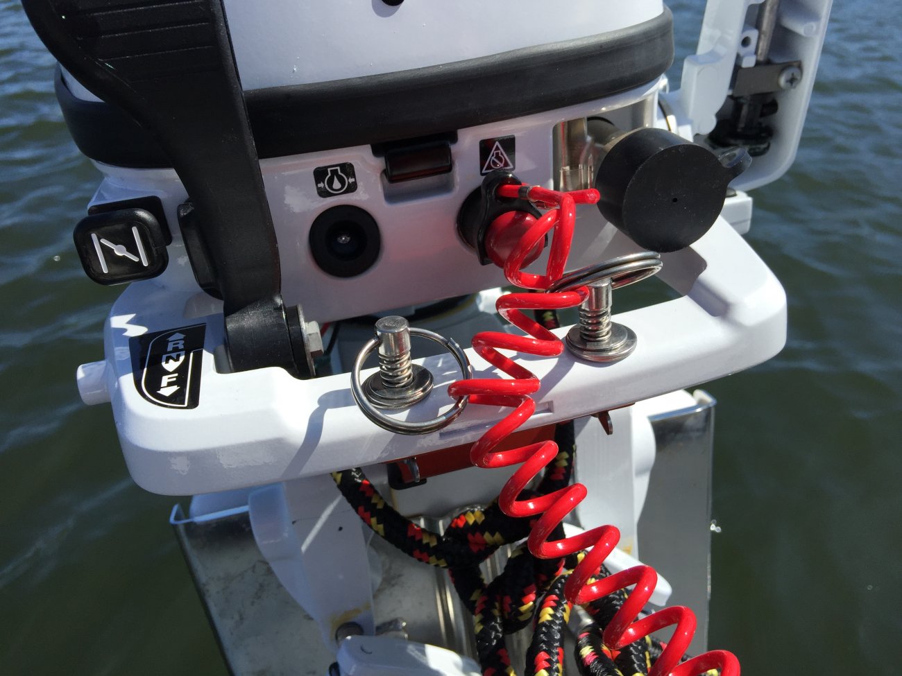

Back to the locking adapter: Looking at the photos on Tom Lipp's Blog it seems like the plate could be attached with a quick-release pin or two. An extra hole and line could be used to hold it captive to the motor handle or boat.
While that wouldn't make for an instantaneous release, perhaps no tools would be needed: Pull the pin, slide the lock out, and let it drop. Maybe when the motor is running there's too much friction to easily pull the lock out. I guess I'll have to try it.

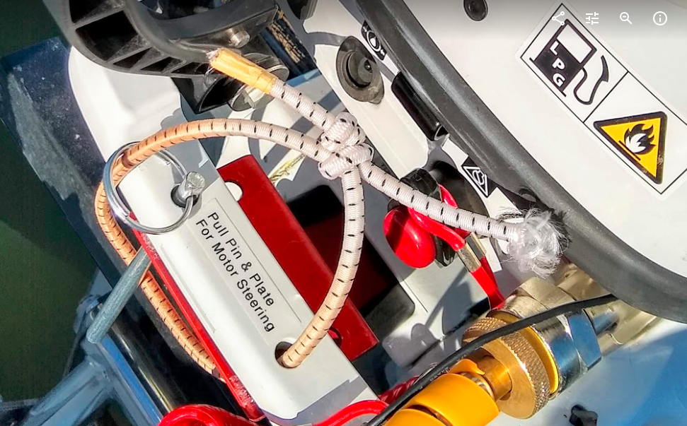

There IS an optional lock for the motor that is bolted into place, but many sailors don't want to lose the ability to steer the motor, so they don't buy/use one.
Here's my solution, using the offical lock but not bolting it in place. The pin and plate are both tied to the engine. I will use tape or heat shrink to keep the pin from rattling, and I need a shorter pin. The label is for whomever takes the helm when I fall overboard.

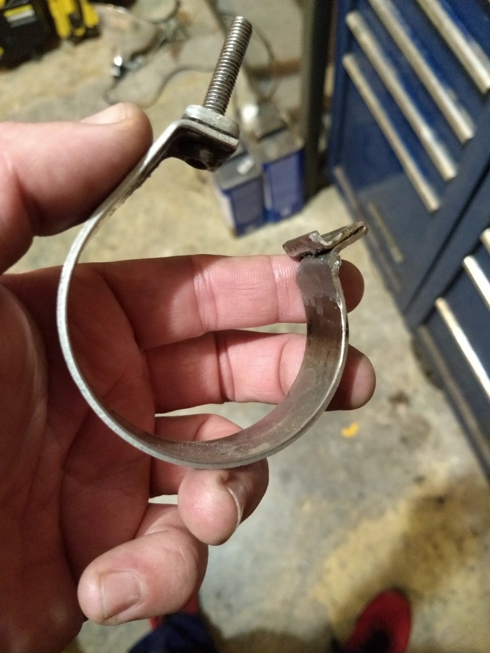

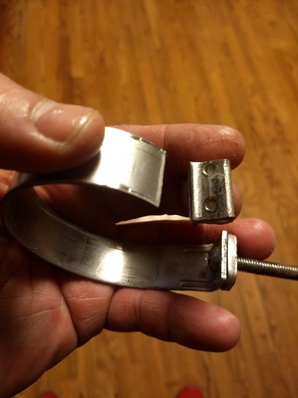

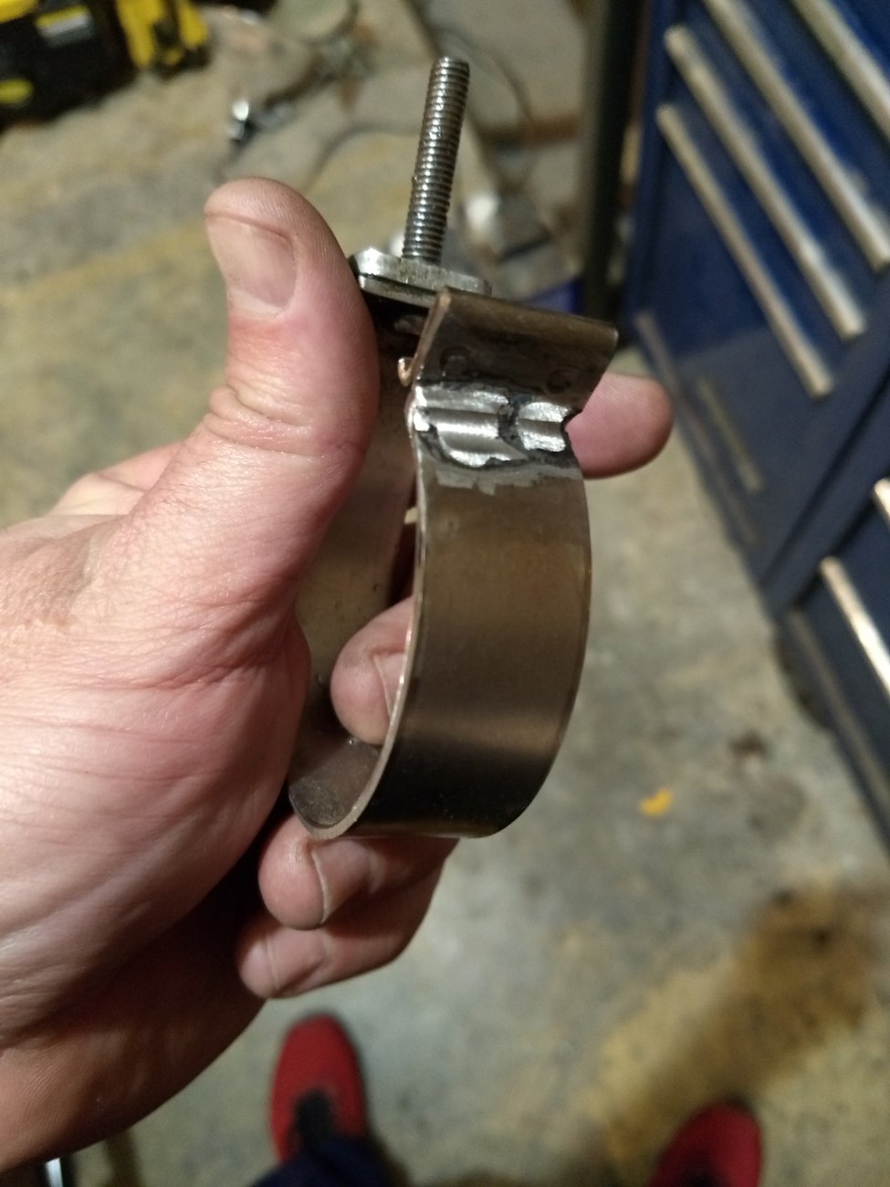

Took apart my 4hp Tahatsu for the no friction on the steering problem. Real simple problem easily fixed. The tensioner Tang broke off. I welded mine back but you can purchase these at a reasonable price as well.
