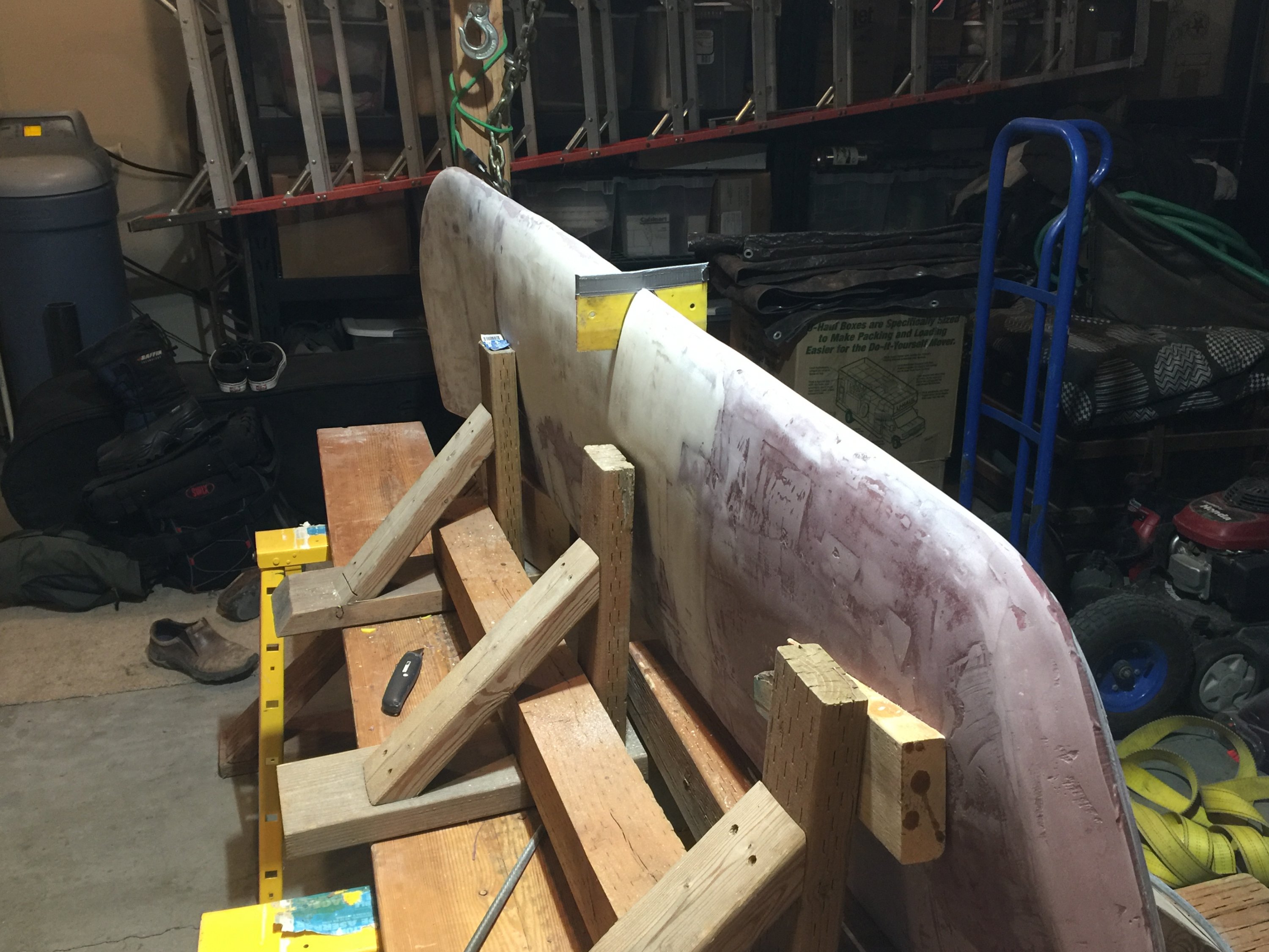

Looks great bro... I wouldn't worry too much about adding a skim coat of filler. You might be able to get that to sand down flat to the original laminate. The more room for the width of the keel, the better.

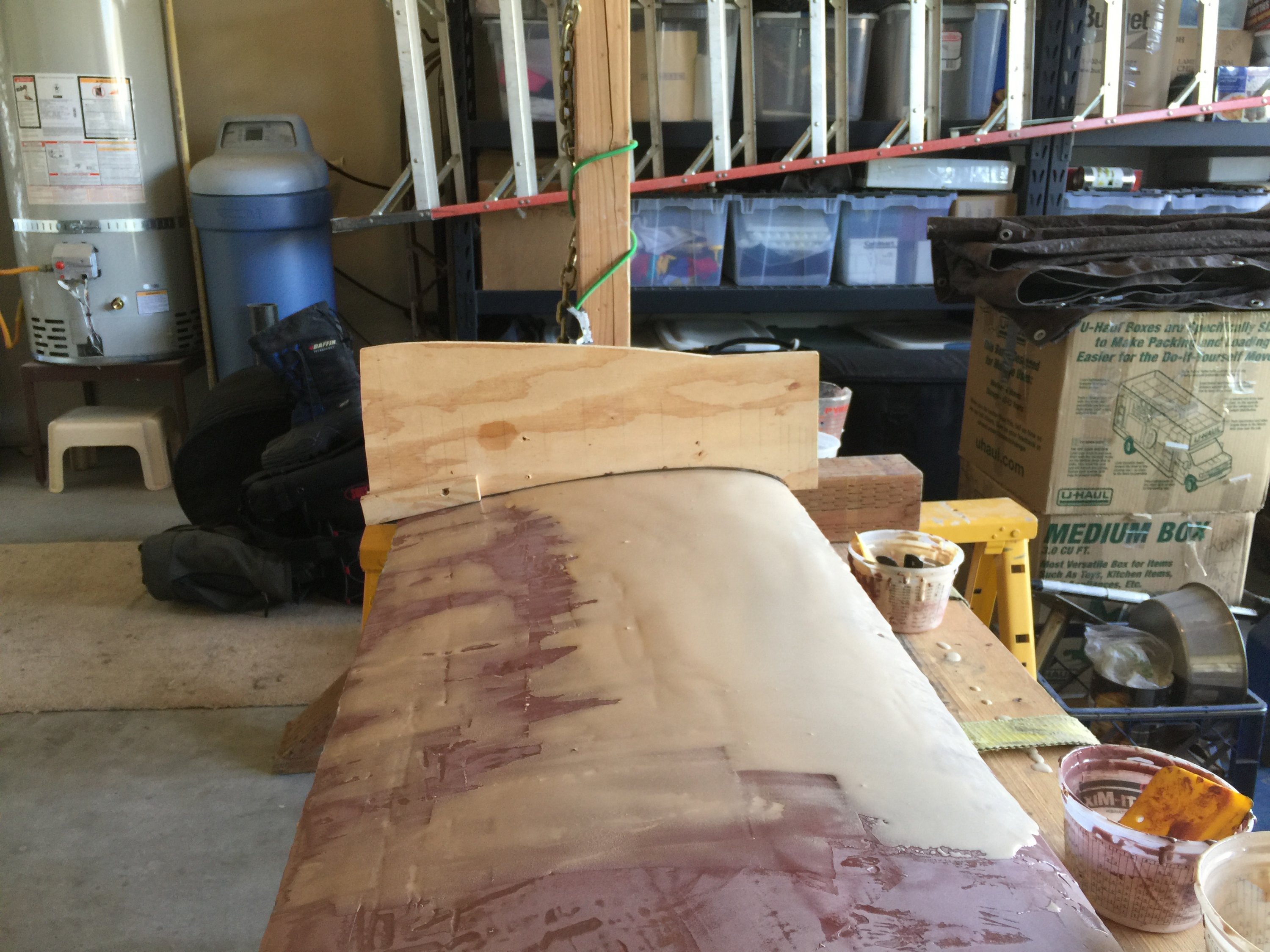

@CloudDiver : Thanks-- yep not wanting to build up surface as much as trying to smooth out what was a messy blotch of resin and cloth.

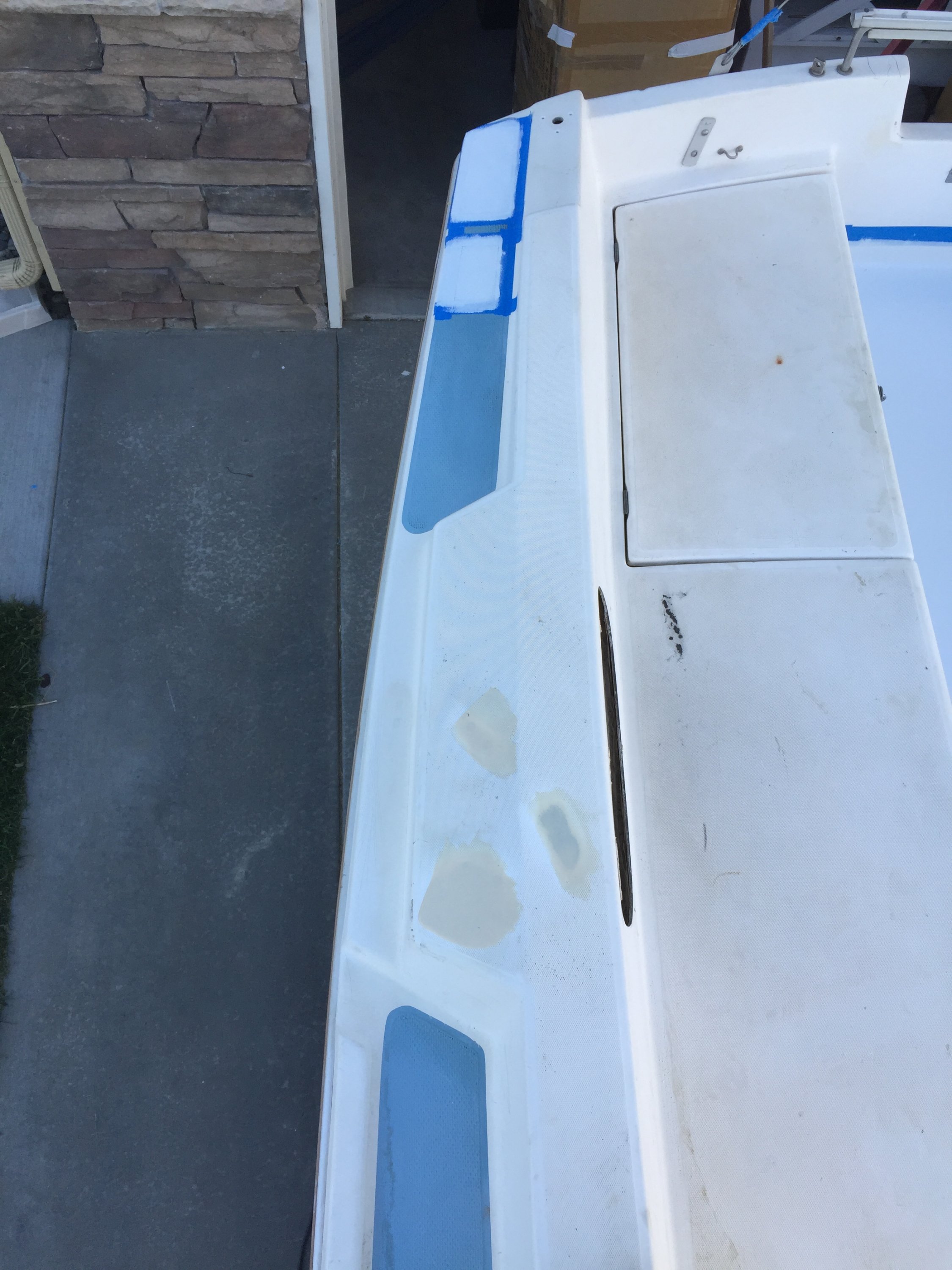

@CloudDiver : secondary and related question to deck prep-- wondering how and if you treated the non skid portion of the cockpit seating and the caps of the coaming? I was staring at the tighter (and seemingly harder to sand) hatched gel coat and thinking about options.

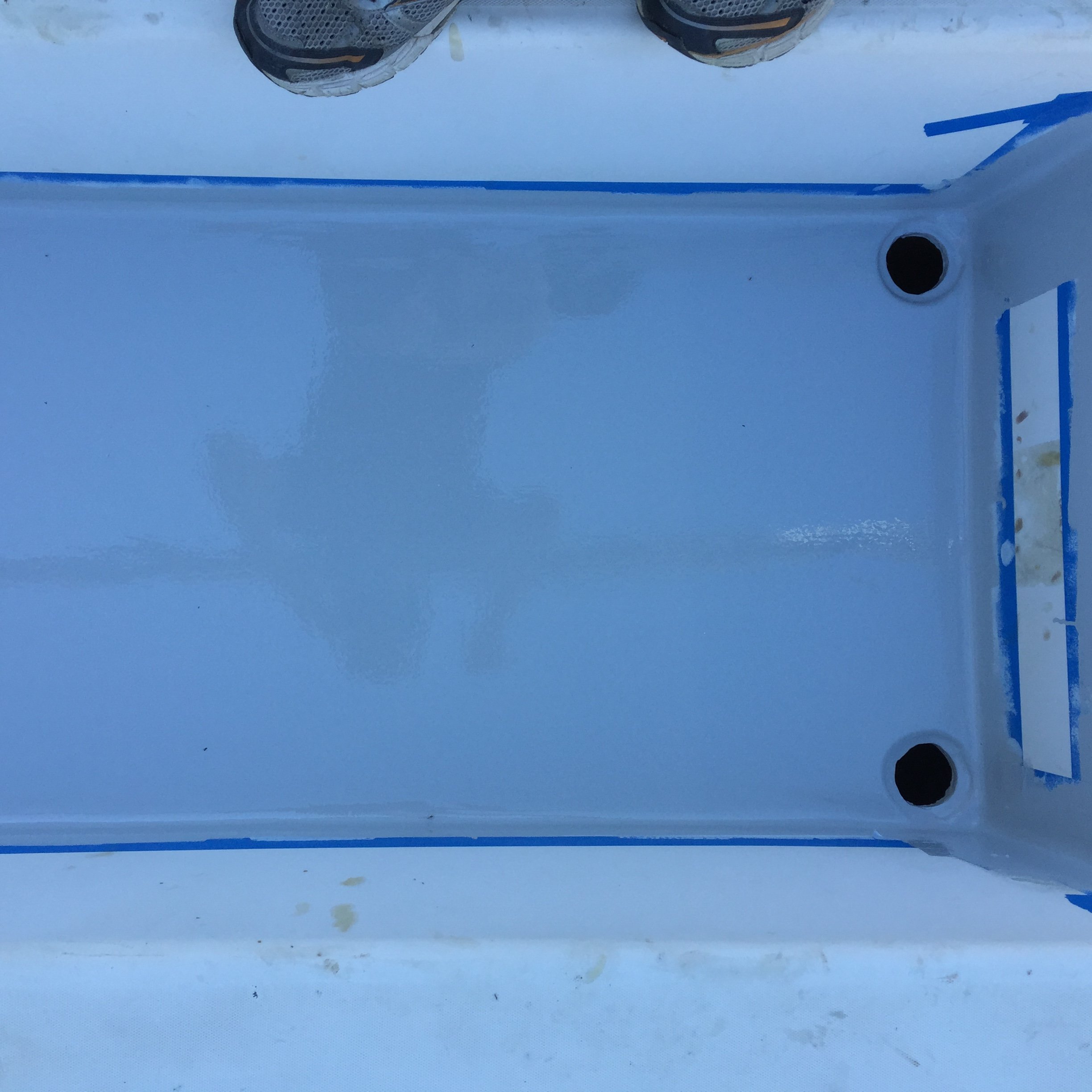

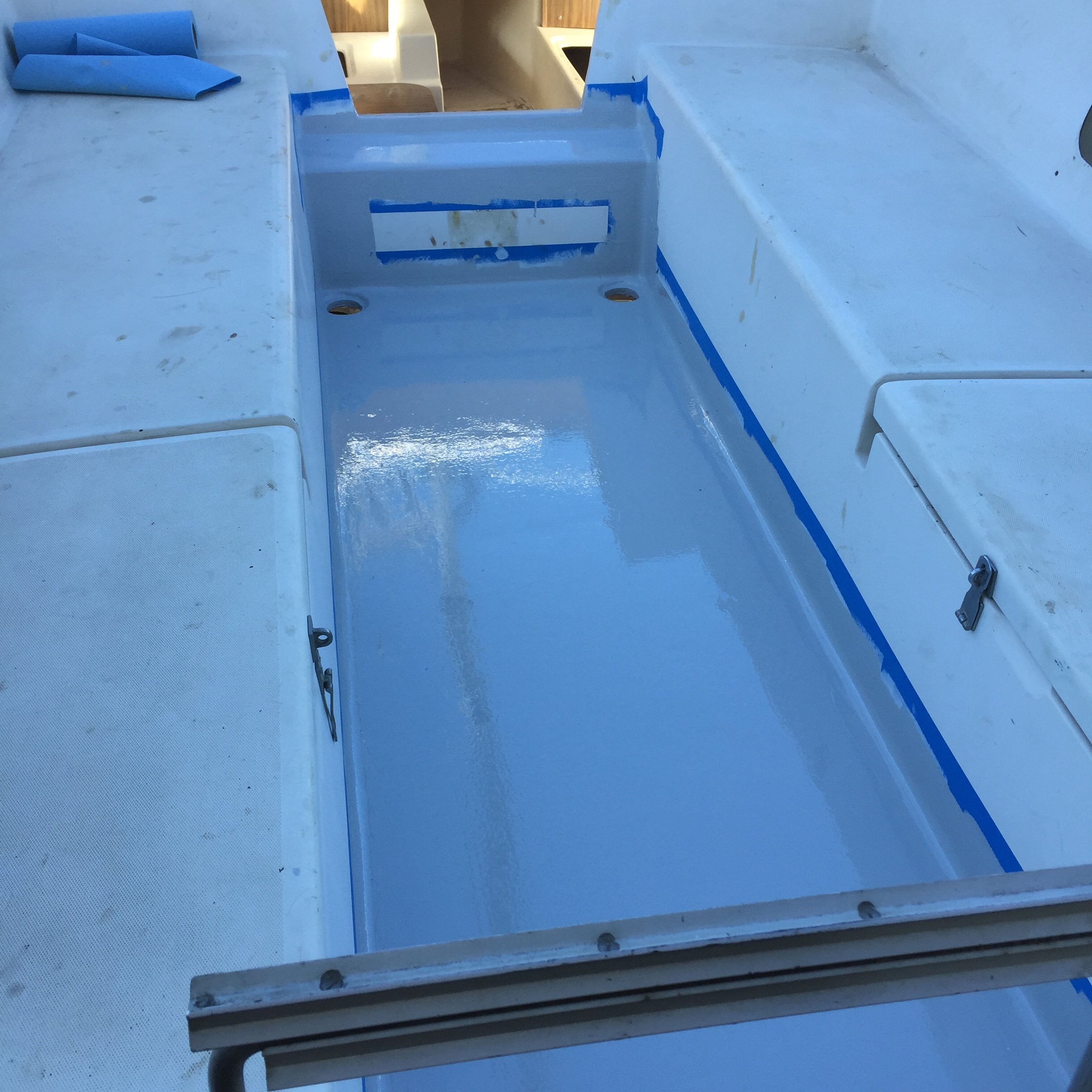

Coat 1 of liquid gold applied. I hate paint so I'm trying to make this as easy on myself as possible -- surely I don't need to roll then tip, ridiculous!?
TIP damnit! Tip until the cows come home!!
Needless to say awlgrip lays down beautifully but it tips really nicely despite my brush stroke fears. Coat one of pearl grey is in the books and I can already see my reflection

I sanded all the nonskid completely off in the cockpit and coamings and then primed/painted gloss white everything. If you intend to use kiwi grip you don't have to do that. I will be putting down faux teak SeaDek, it has 3M pressure sensitive adhesive on the back so it likes smooth glossy surfaces better.

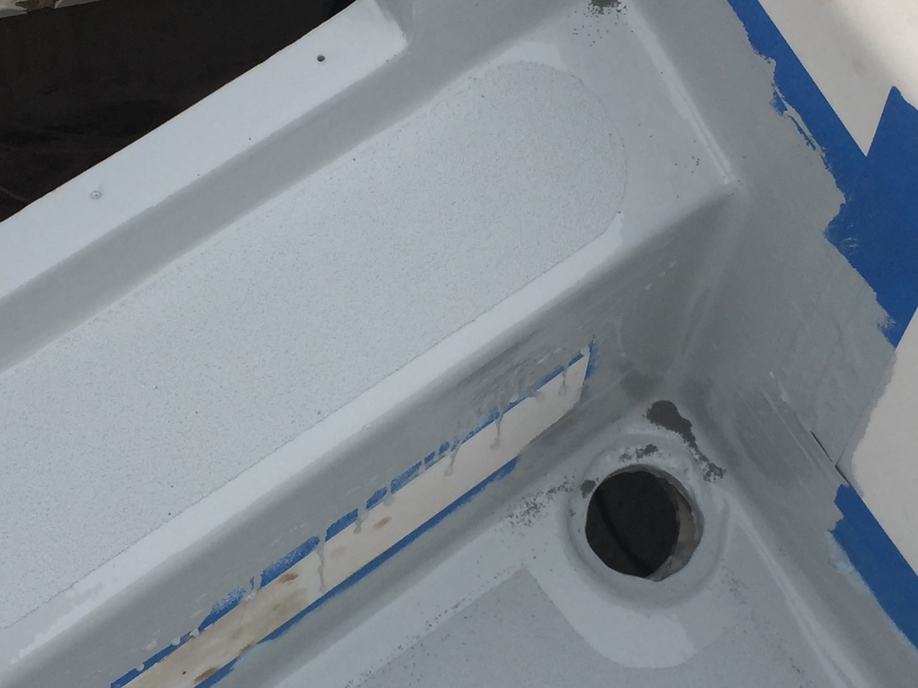

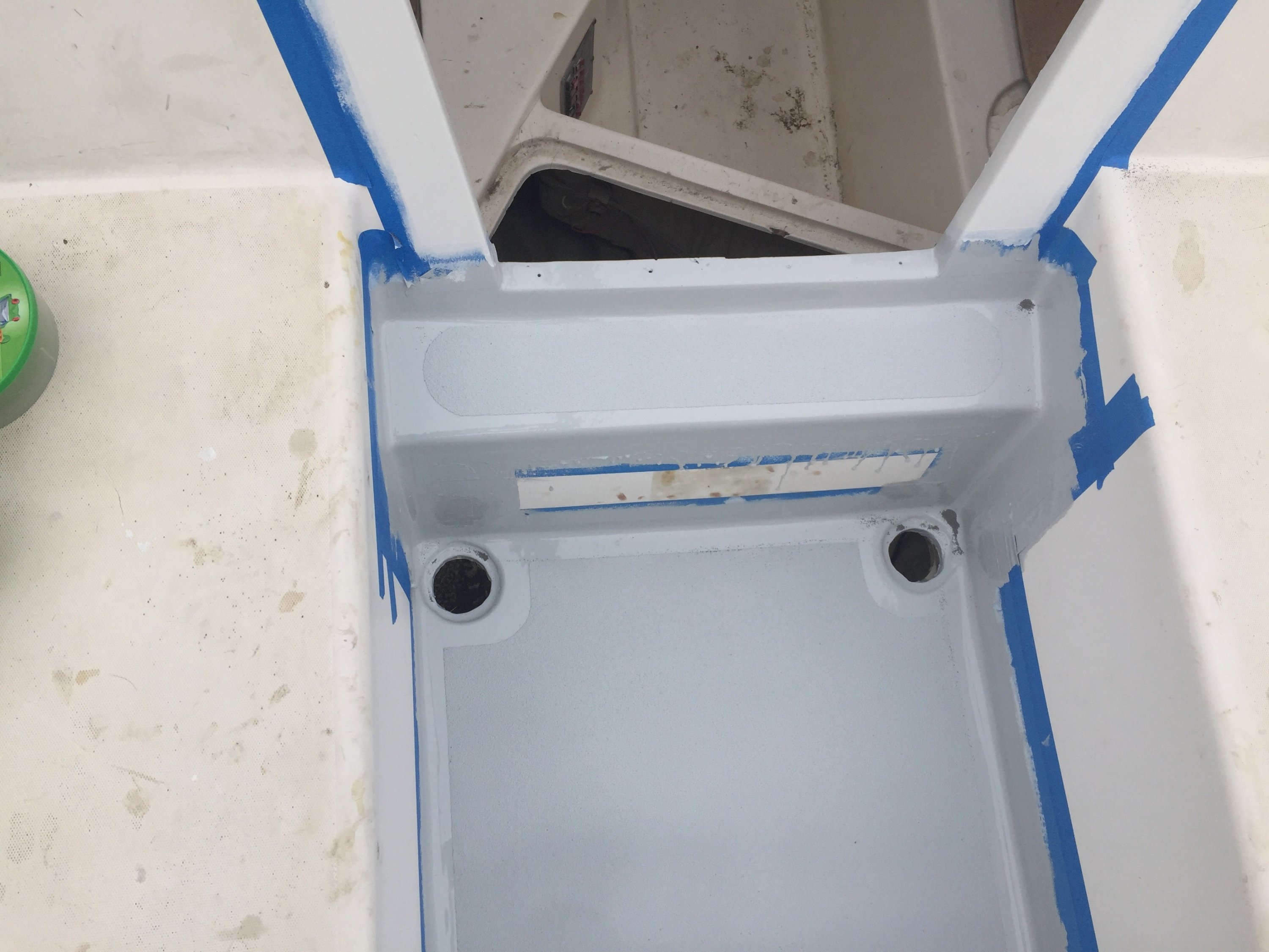

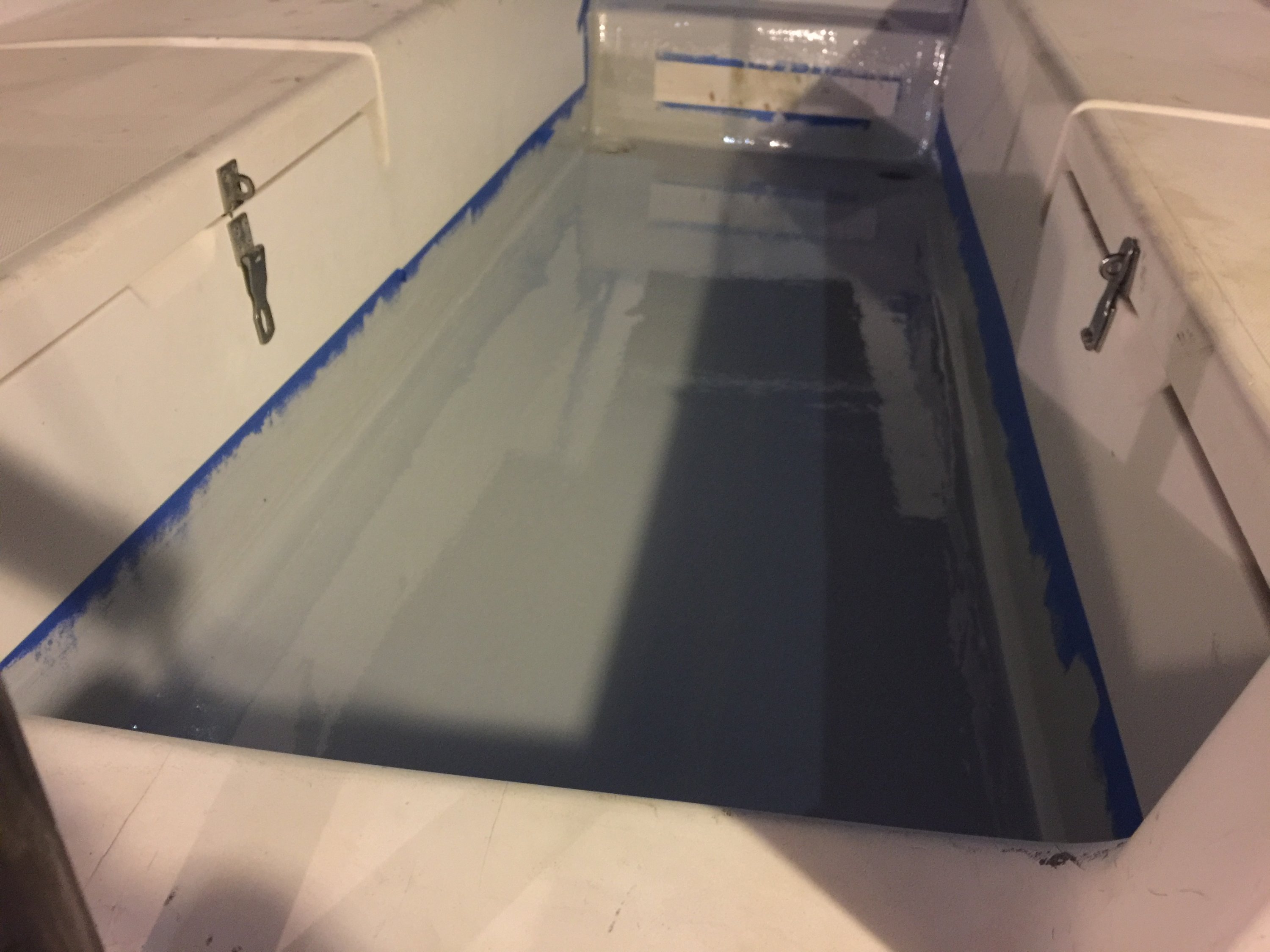

Last AwlGrip topcoat applied to the cockpit floor-- still waiting on the non skid media from SoftSand. Almost seems a shame to muddy up what looked like a swimming pool last night. And since daylight and temperature is starting to wane in the PNW, it's back to the garage and we finally have a foil. I'm losing this weekend to previous commitments but the plan is to have the Keel physically shaped and ready for a test fit before spacing and final barrier coat and paint.
Would still like to target a shakedown splash before the end of the year... we'll see.....

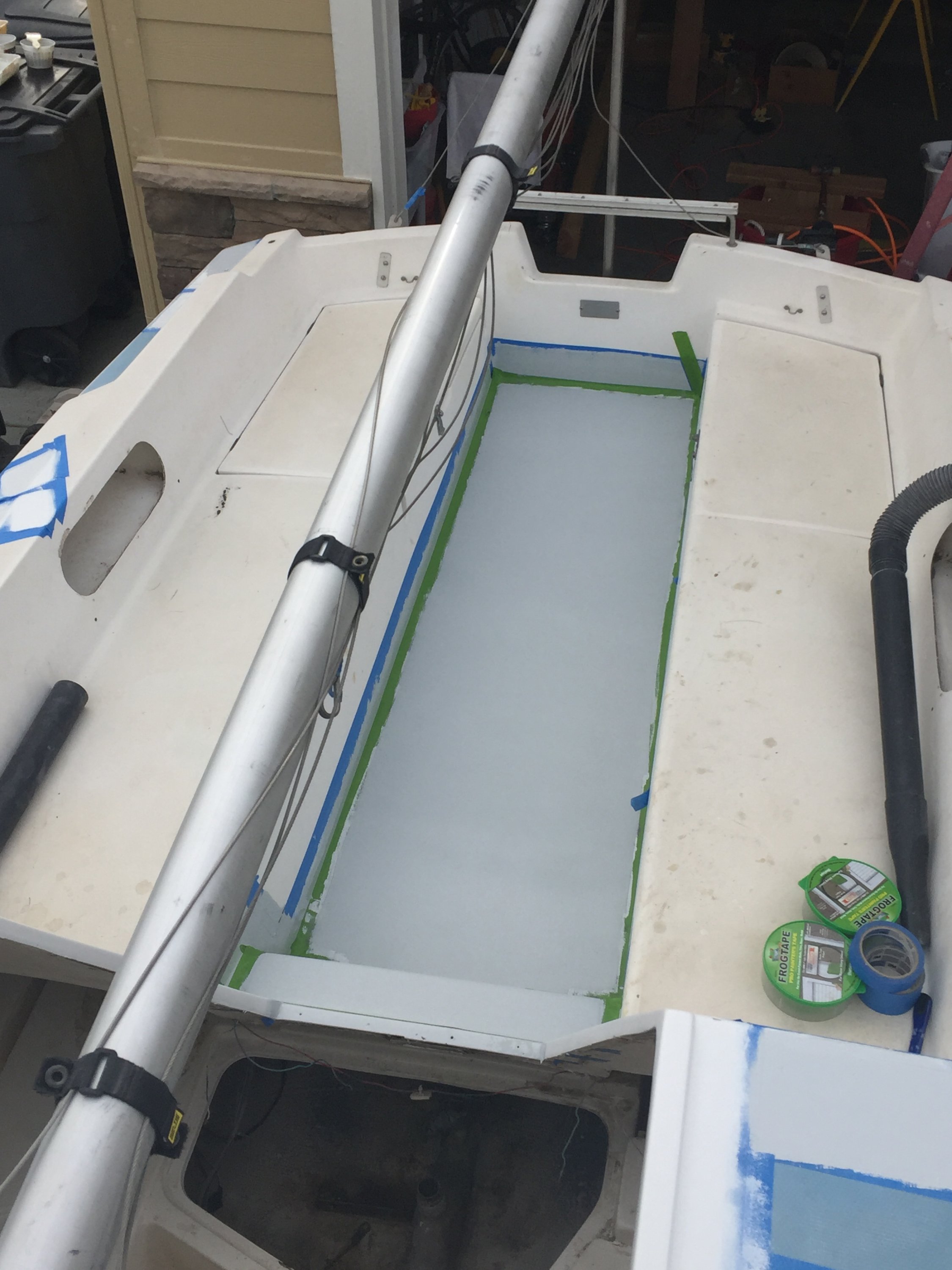

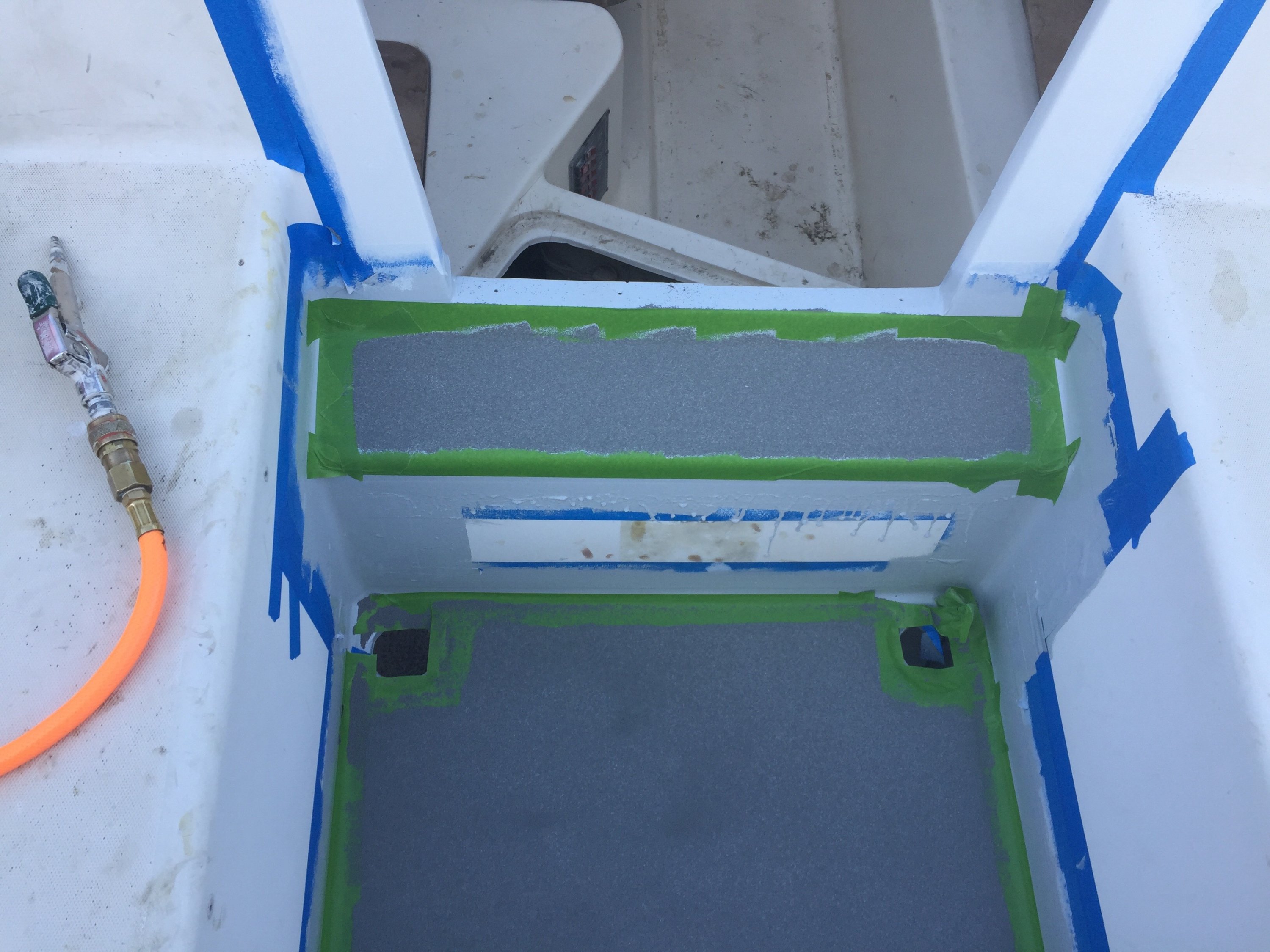

Finally feeling like something is finished-- full disclosure I'm not painting any thing but the horizontal surfaces this season, I had to have a functional cockpit floor and companionway step so it looks like hell-- the point being I have a 2 inch wrap on the finished grey to cut back into when the topsides get painted in earnest.
Used awlgrip with soft sand applied by shaker for the non skid-- really came out nice,and thank goodness I timed the tape pull-- perfect edges.
The soft sand came in a dark grey option which worked well to help indicate how much coverage and overcoat was necessary.
The small bits of grey visible in the pic is the soft sand leftovers from the tape pull which vacuumed up easily

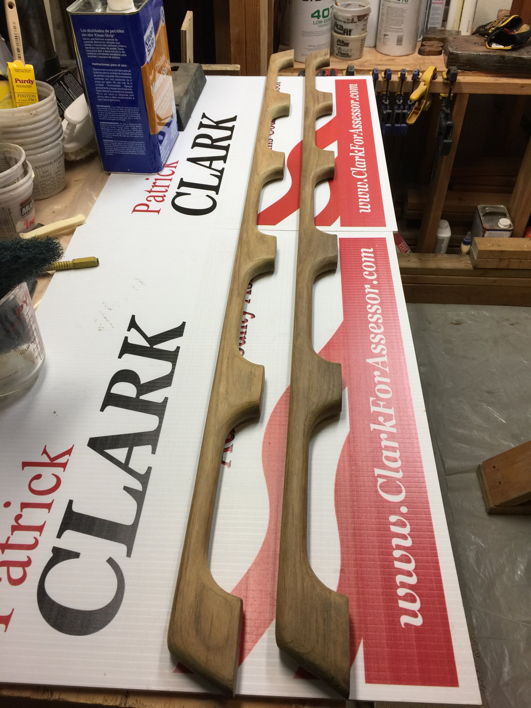

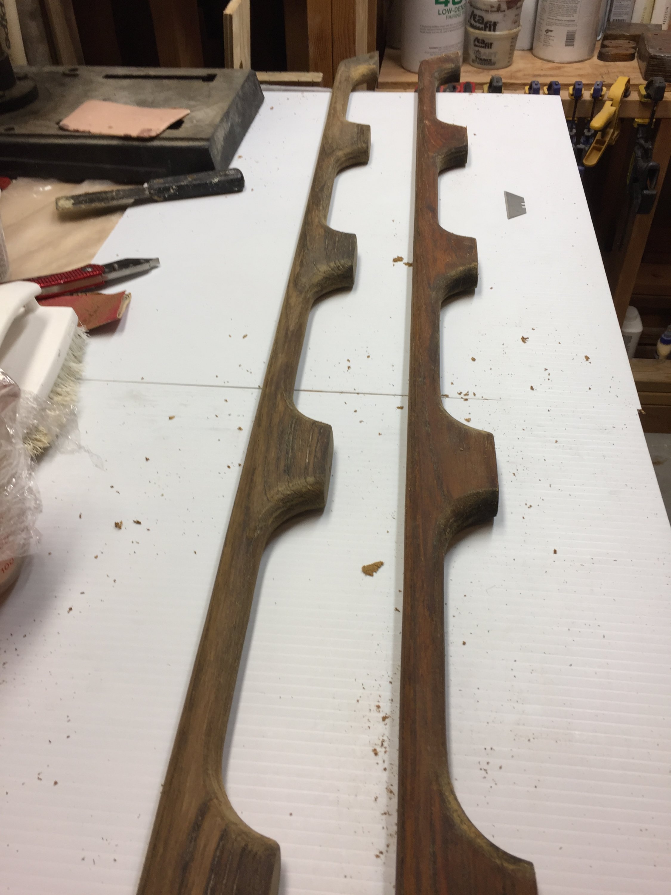

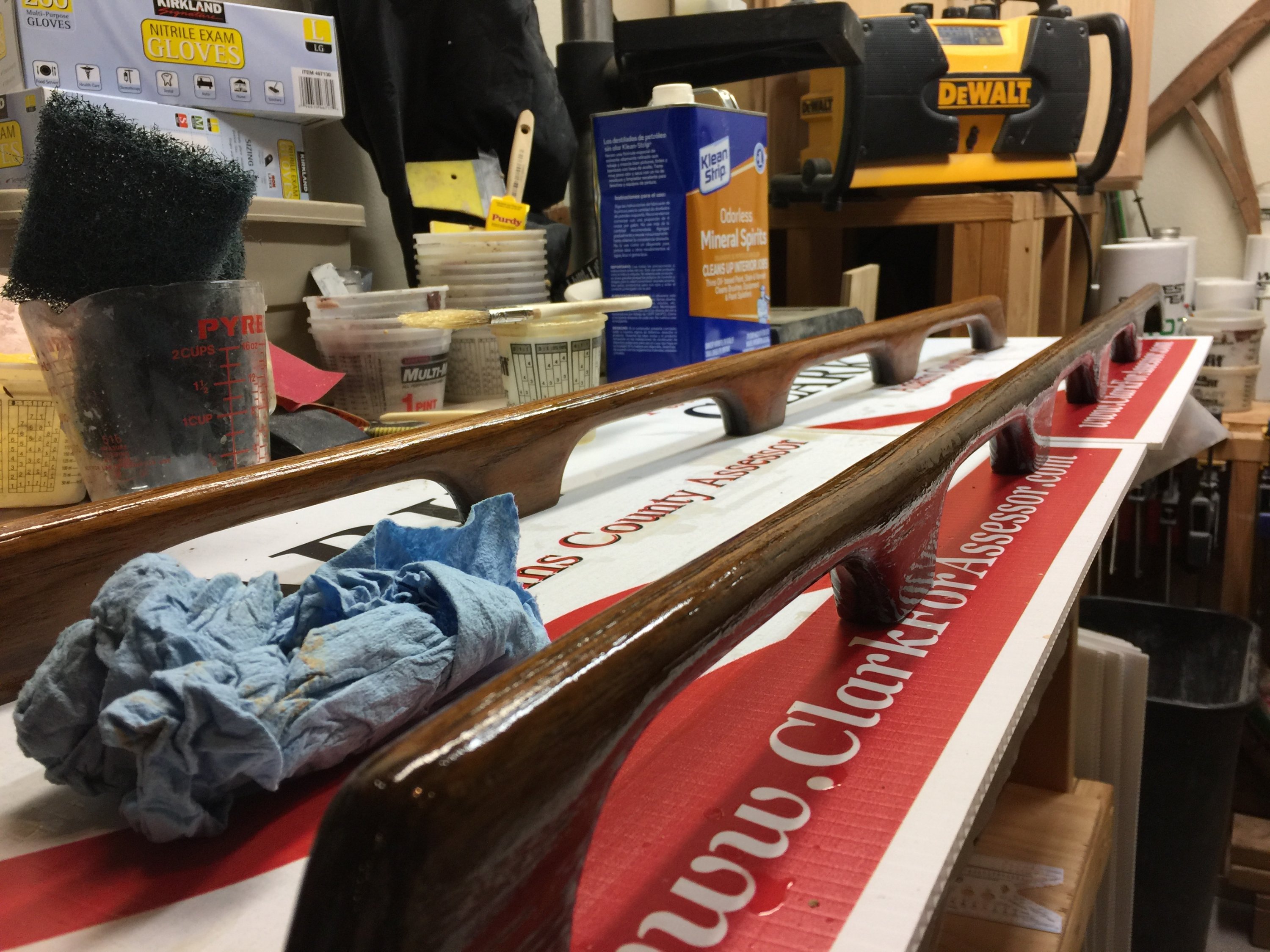

It's not much but it's progress: my portion of the PNW broke an all time record for snowfall which has led to scant little work indoors or out for that matter. I did, however; manage to snag a set of handrails I desperately needed and despite what should have been easy-- they came out fairly well.
Pic below shows what someone thought was a good idea for finish-- odd reddish gummy and useless. Rail on the left was post stripping and still not good enough:
I got out the Jabsco and some scotchbrite and got it back to recognizable teak again:
and a first coat of Smiths: Now bring me some warm weather so I can get to work!
