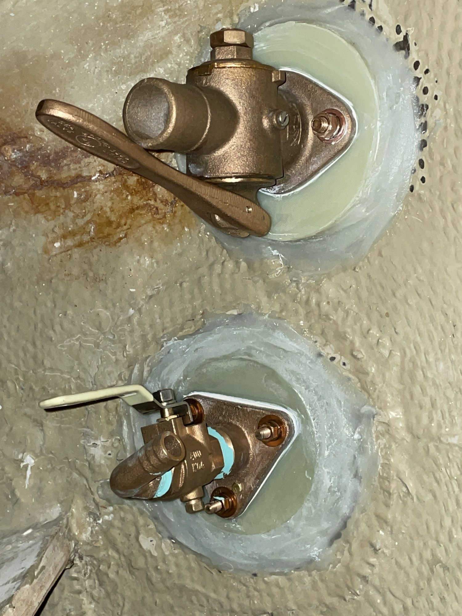

I dont know why they would want to hide them. I want to install a plexi window so i can stare at my beautiful bronze babies whenever i walk by, especially after how much i paid for them...im thinking they are more like functional art now.
Jan 4, 2006
7,308
If those were mine @BAD ORCA , I would spray them with protective acrylic (Krylon) to preserve the appearance, You can't take much pride in them after 24 years even in a dry location:

oh i didnt know you could do that. will definately think about that as i get the v-berth finished up. they will look good against a nice fresh white layer of gelcoat.
