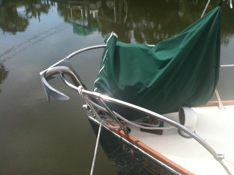

Are you using chain as chaff protection and/or to reduce scope?
I ask because I anchor in sand and shallow water and don't use chain. My Lewmar Bruce grabs and hold with 7-10 to 1 and I keep an eye on rode wear.
Danforth type anchor? Many others offer quicker set, re-set and better holding at the same weight.
I made a holder for the Bruce out of a scrap of rolled s/s tube that came from a old pool heater.
I have a 22lb with chain for use as a storm anchor stowed in a cockpit locker.

there are lots of pictures in my mac25 photo album, showing how mine is set up. on one of the many pages....
I took a quick look using my iPhone. I'll check out the pictures more carefully on my real computer later today. Looks like you've put a lot of effort into yours albums. Thanks for sharing
