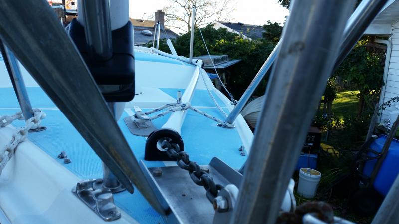

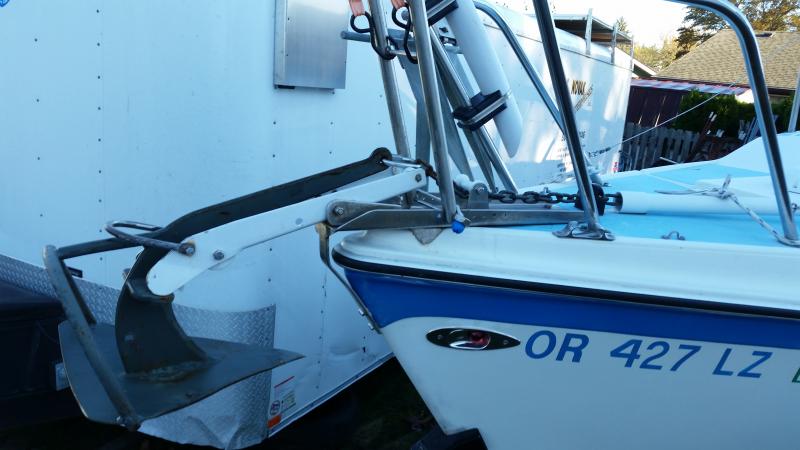

with my setup, I have 16 feet of chain on 170ft of 1/2" rode.... and it is ran back to the cockpit.... i never have to go on deck to either deploy or retrieve. its all done from the cockpit.
with the anchor rode being worked from the cockpit, its easier for a single hander to use the motor to drift forward towards the anchor while taking in the slack in the line, and save the heavy pulling for lifting the anchor full of mud or seaweed from the bottom....
and from the cockpit its also easier for the single hander to use the motor to back down on the ride while deploying and setting the anchor.
once I get directly over the anchor and have all the slack out of the rode, I cleat it off.... within a few seconds the motion of the boat (wave action and wind drift) will break the anchor out...no hard pulling whatsoever. then I usually let it drift a few more seconds so it has a chance to scour off as much mud as possible as it drags along, before drawing it up and onto the roller....
the anchor itself isnt usually too heavy, so there isnt much effort put into drawing up the anchor, but sometimes the heavy clay, or 'specially the kelp in other areas, that doesnt wash of after the anchor breaks out, can be almost overbearing when trying to draw it up to the boat from the bottom.
i know using a winch would help with this a lot if you have a disability of any kind, and although I havent actually thought about it until now, my method would work perfect in conjunction with a cabin top winch... a self tailer. everything is in perfect alignment.
its now on my "to do" list.....

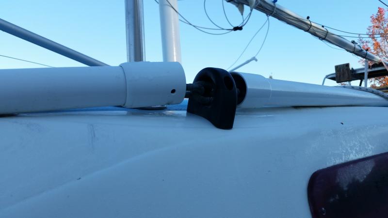

with pvc pipe... its not in the way of anything, its fully functional, and makes life while manually pulling the anchor as easy as it will ever get... the bullseyes for turning the rode after the roller and on the corner of the deck are 1 inch delrin blocks, which are very low in friction so there is little resistance in them.... "delrin is VERY strong, and can be easily worked with woodworking tools)
obviously, the chain stows in the pvc pipe, on deck.
the aft end of the pvc where the rode exits, it is not connected to the deck but free floats with the rode, so no matter where I stand while pulling, the tube is always in the lead...
the only things that are bolted to the boat are the two turning blocks.... (as well as the roller and the cleat)....
I had the turning blocks the same way on my 21 to bring the rode to the cockpit, but i didnt use chain on that boat so didnt need the tubes.
both pvc tubes free float on the rode without any other connection, other than a small wire lanyard that joins them together at the deck turning block, and this is only so the aft tube stays put and doesnt ride in with the line while im pulling it.
I dont currently have a winch, but you can see where one could be easily installed in the area of the cleat...
the anchor is a 30# home built design, kinda between a rocna and a manson, which works as well as anything ive ever used...
when deploying, i just uncleat and let it go...
when drawing it in, i just fold back the cockpit cushion and stand on the seat with one foot on the coaming.... or if the wind is blowing, i will stand at the tiller and steer with my leg and have the motor idling toward the anchor at the while I haul away.
the line falls into a small 4gal. rubbermaid garbage container that is stowed inside at the foot of the companionway..
the addition of the tiler pilot makes the whole retrieval process even easier, because you just set the course and haul in the slack. once you feel a bit of resistance, cleat it down and let the anchor break out..... then continue to draw it in while the tiller pilot does what it does best, keep you moving on course while you get things in order and wipe up any drips from the rode.
I have just taken these photos minutes ago.... we had our first frost of the year last night so its time to tarp the boat.....
