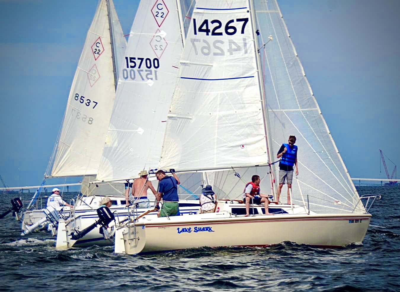

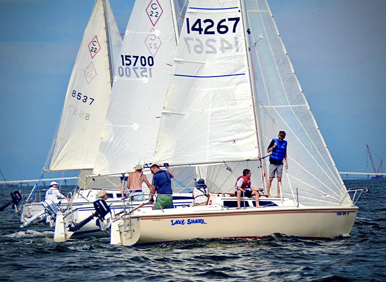

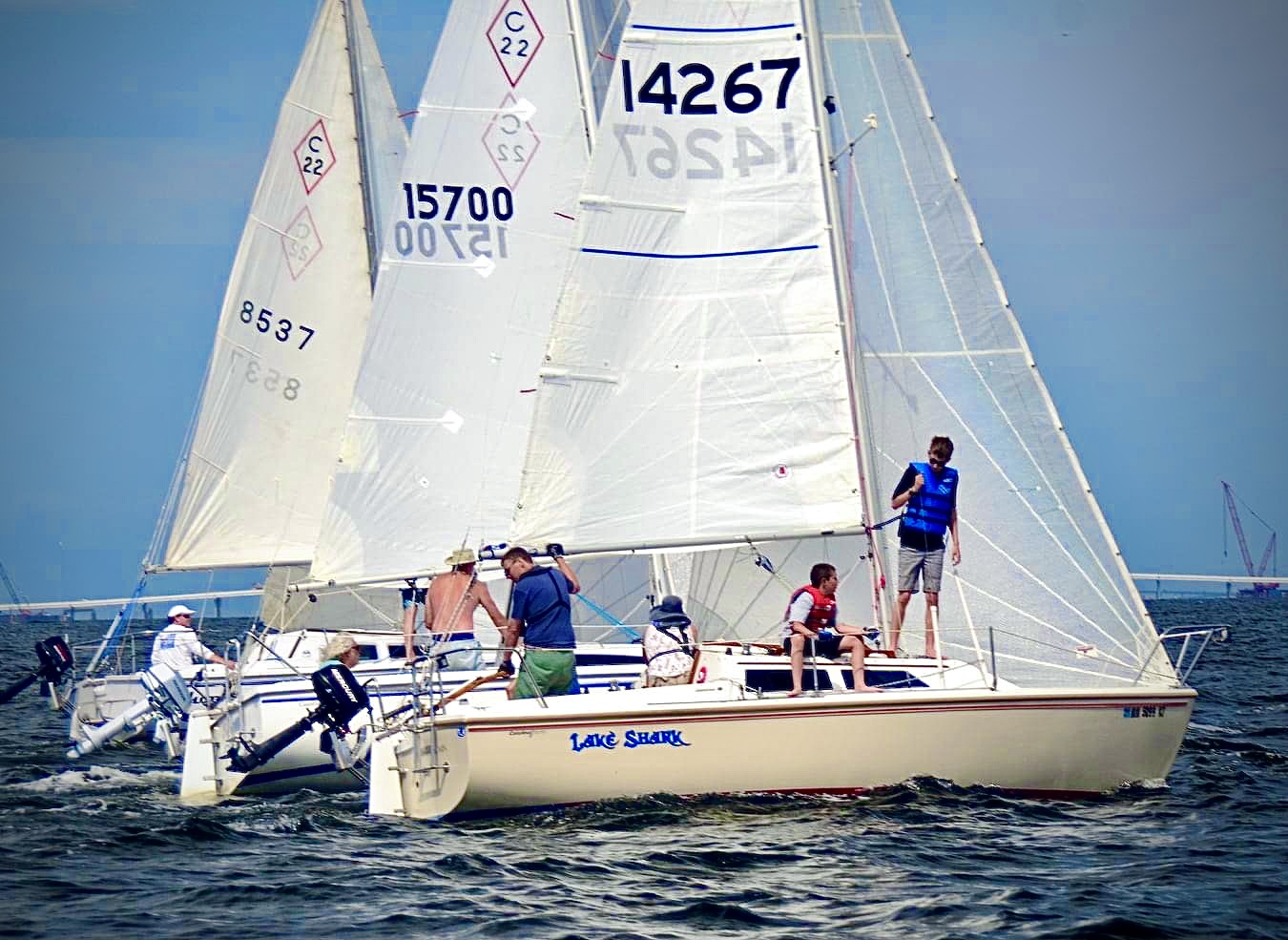

Picture of crisp sails (though not trimmed right on my part):

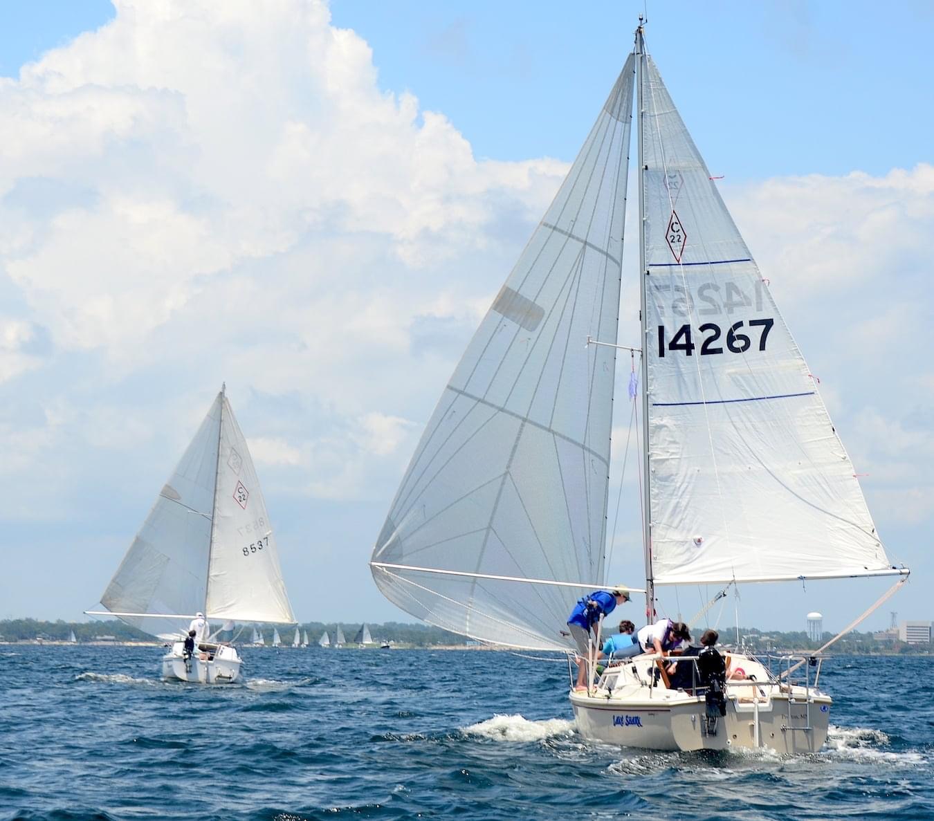

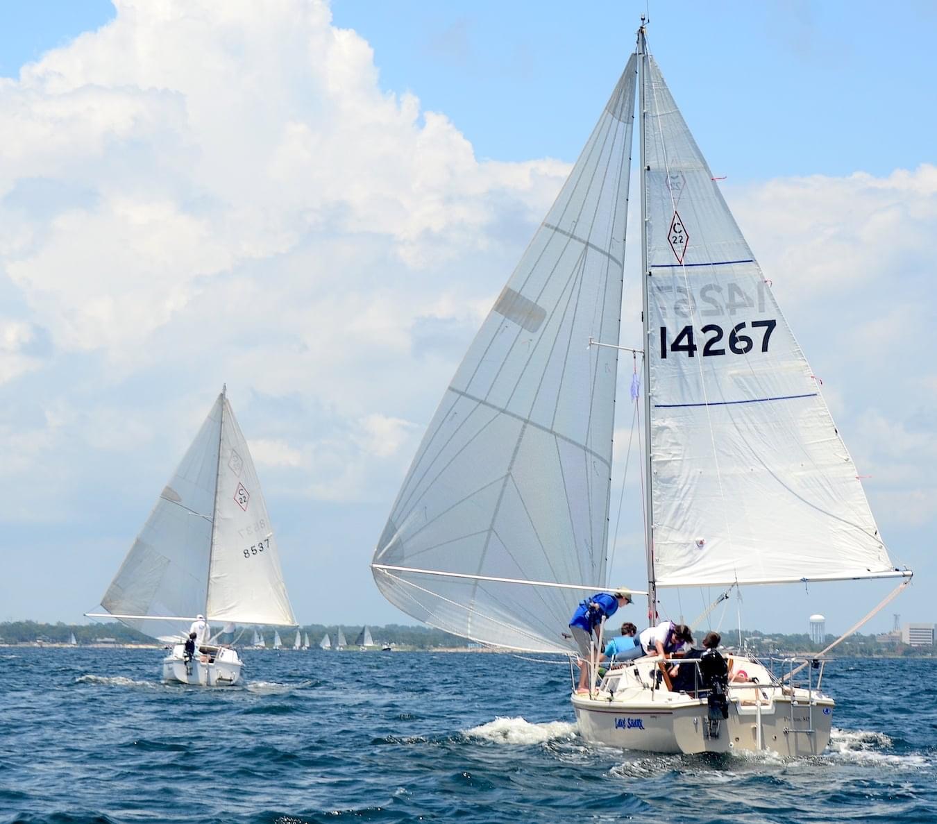

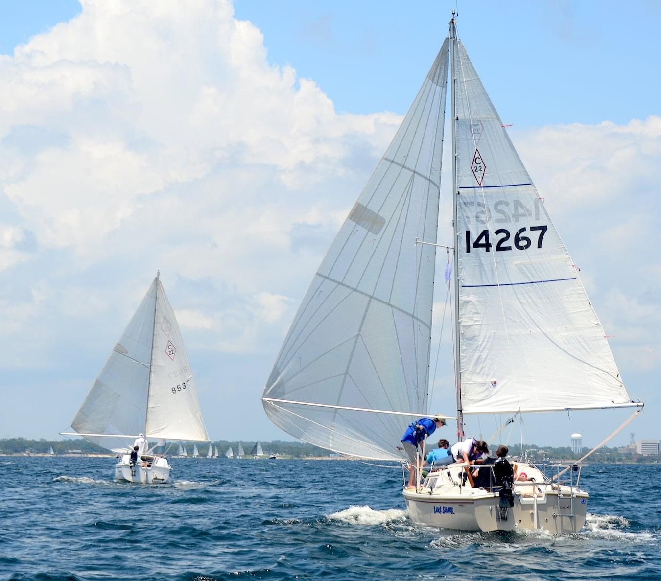

For reference we caught and passed the boat ahead of us in this shot downwind before the bottom mark. Weight forward on the downwind!
Hully heck, @LakeShark, great views. I just got off the phone with Catalina Tech support, he was discussing the very #5 "To point you'll need inside tracks so that the headsail can be trimmed into the spreaders...."
