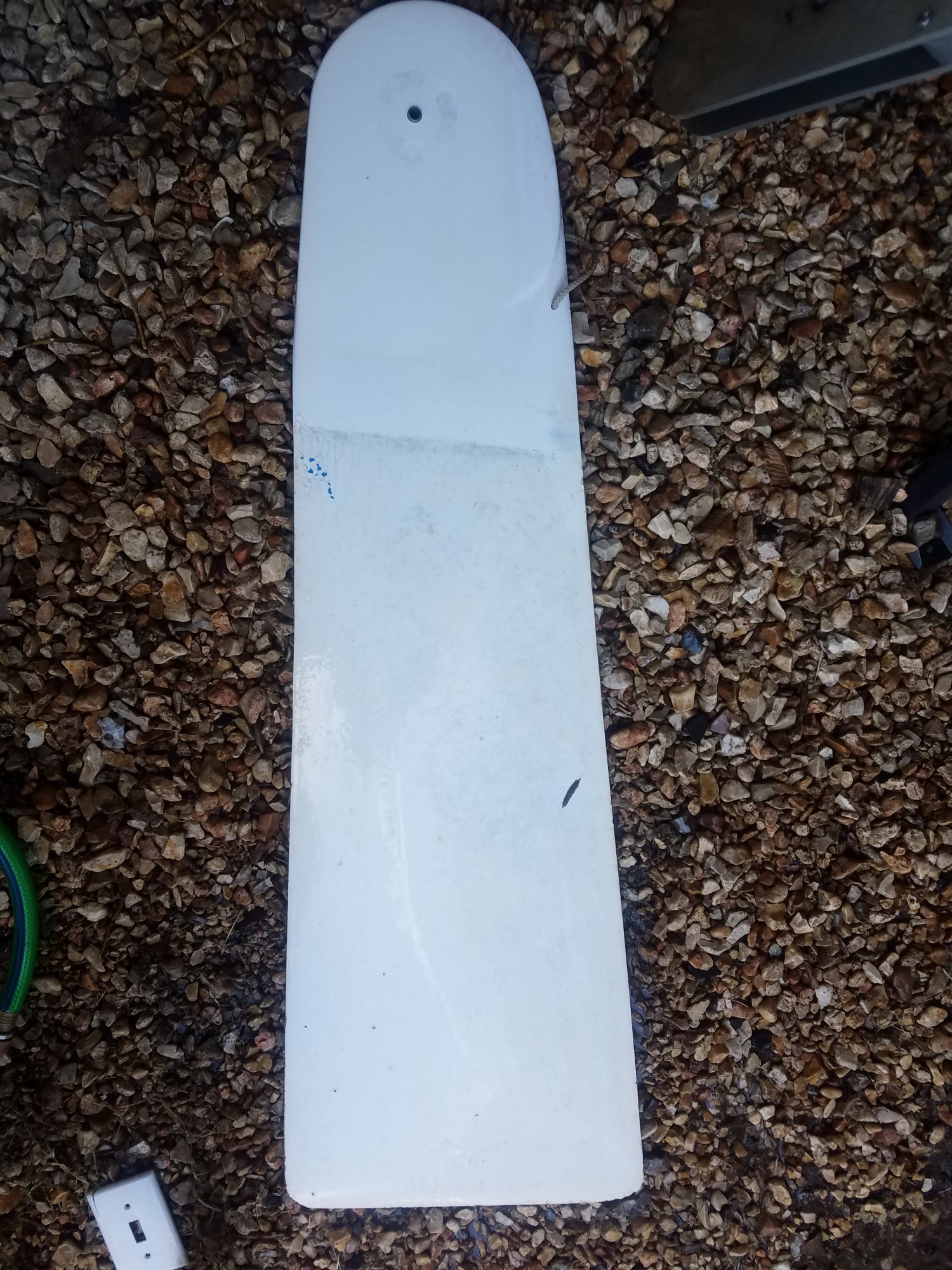

Take a look at your rudder too, if classic tilt up may not be holding all the way down which will give you a weather helm constantly.
I think it was 5% up last time I sailed; I noticed when we headed in- it just wasnt completely 100% down, a little kickedup, I am unable to find the picture. My club champion told me that would be minimal issue but I did wonder!

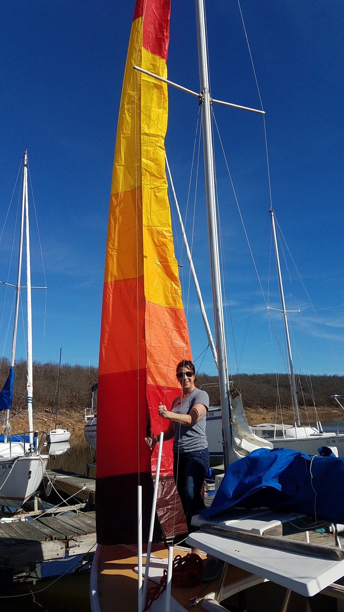

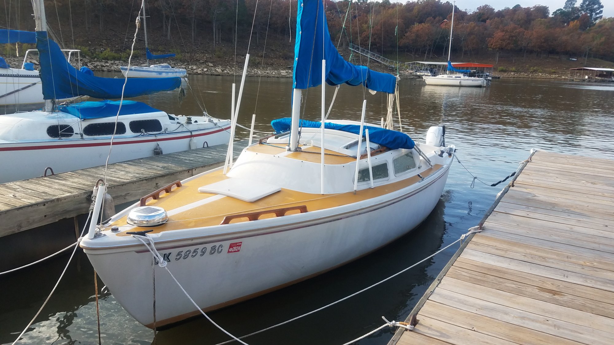

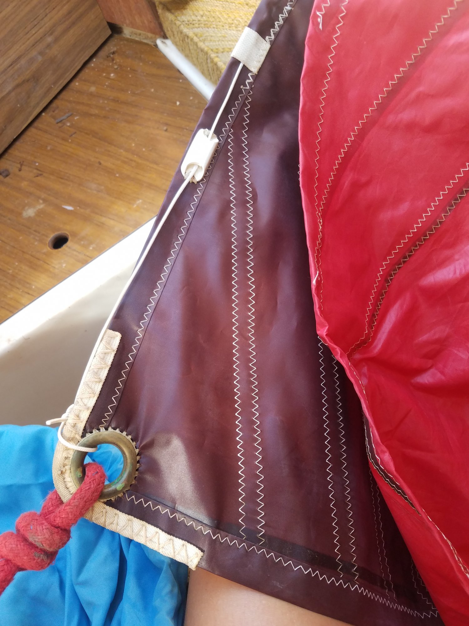

I also wonder is the rudder supposed lift 90 degrees to get the whole thing out of the water? Mine only lifts part way out of the water.(-pic3)

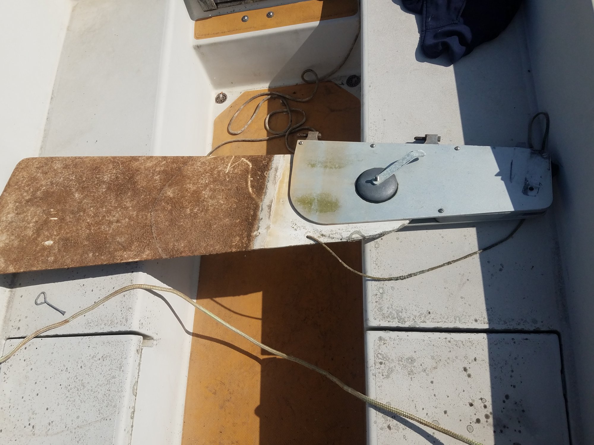

I think you should have spent some of the money that you spent on sailing lessons on maintenance. That centerboard and hull would prevent your boat from sailing well on any point of sail.

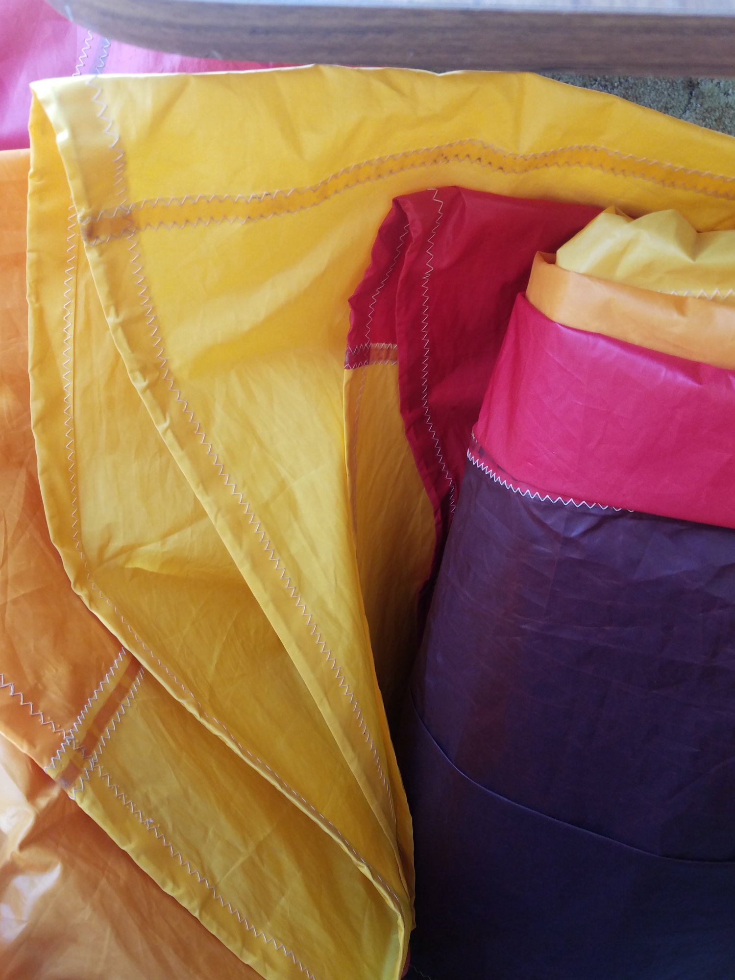

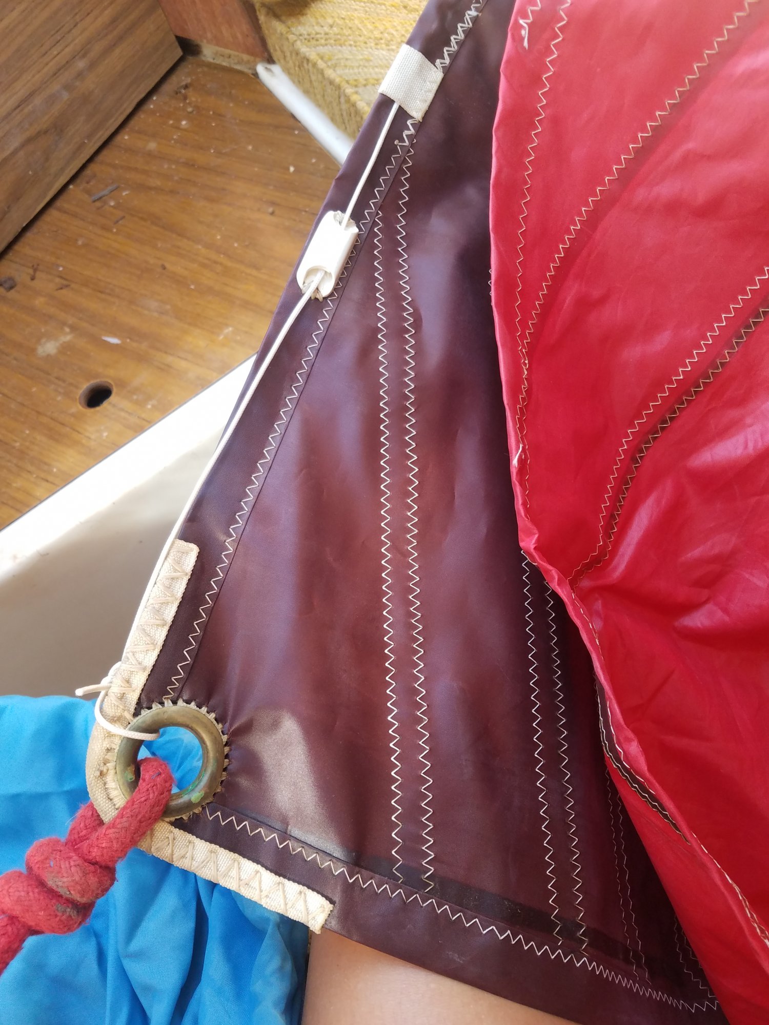

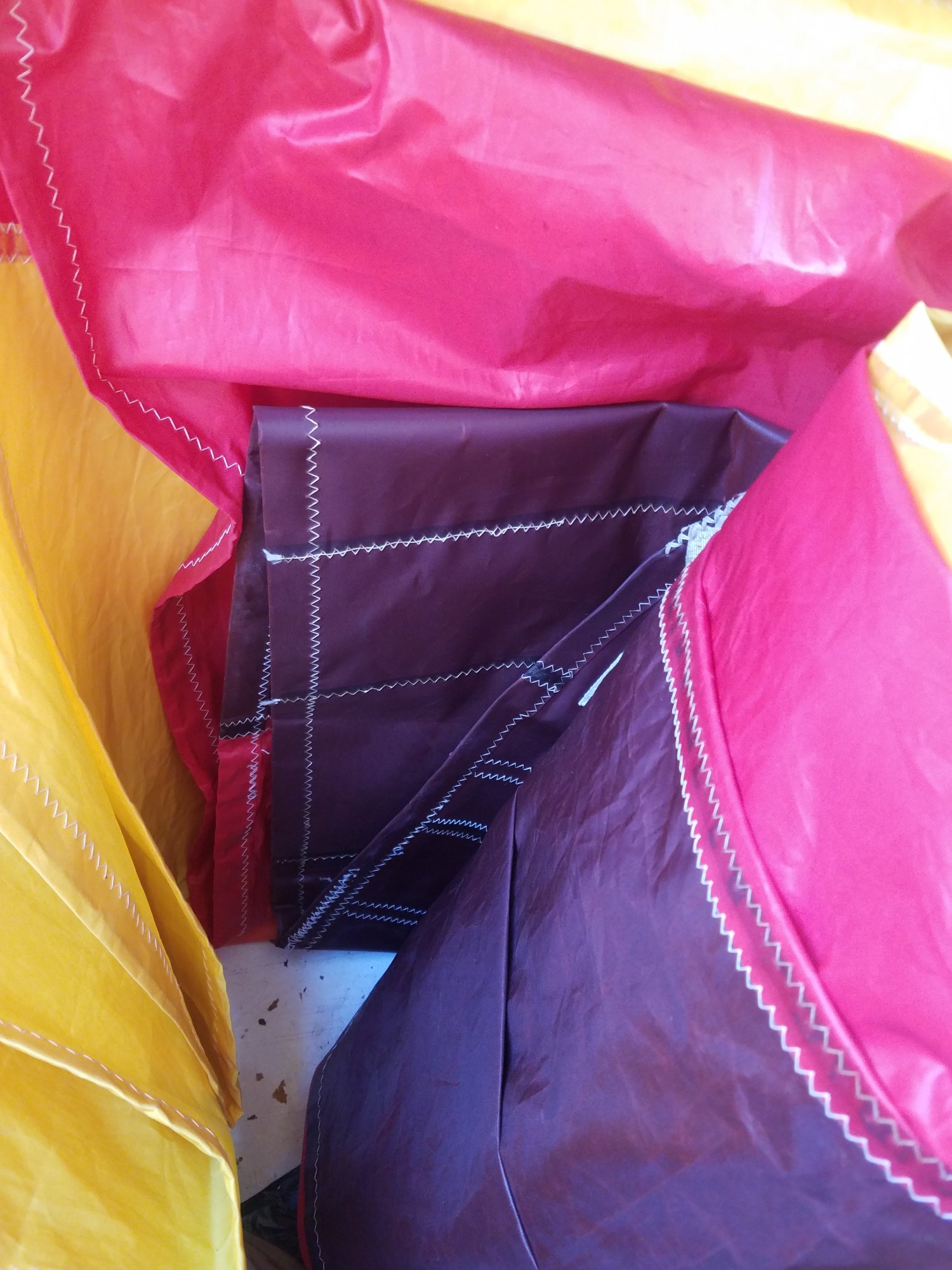

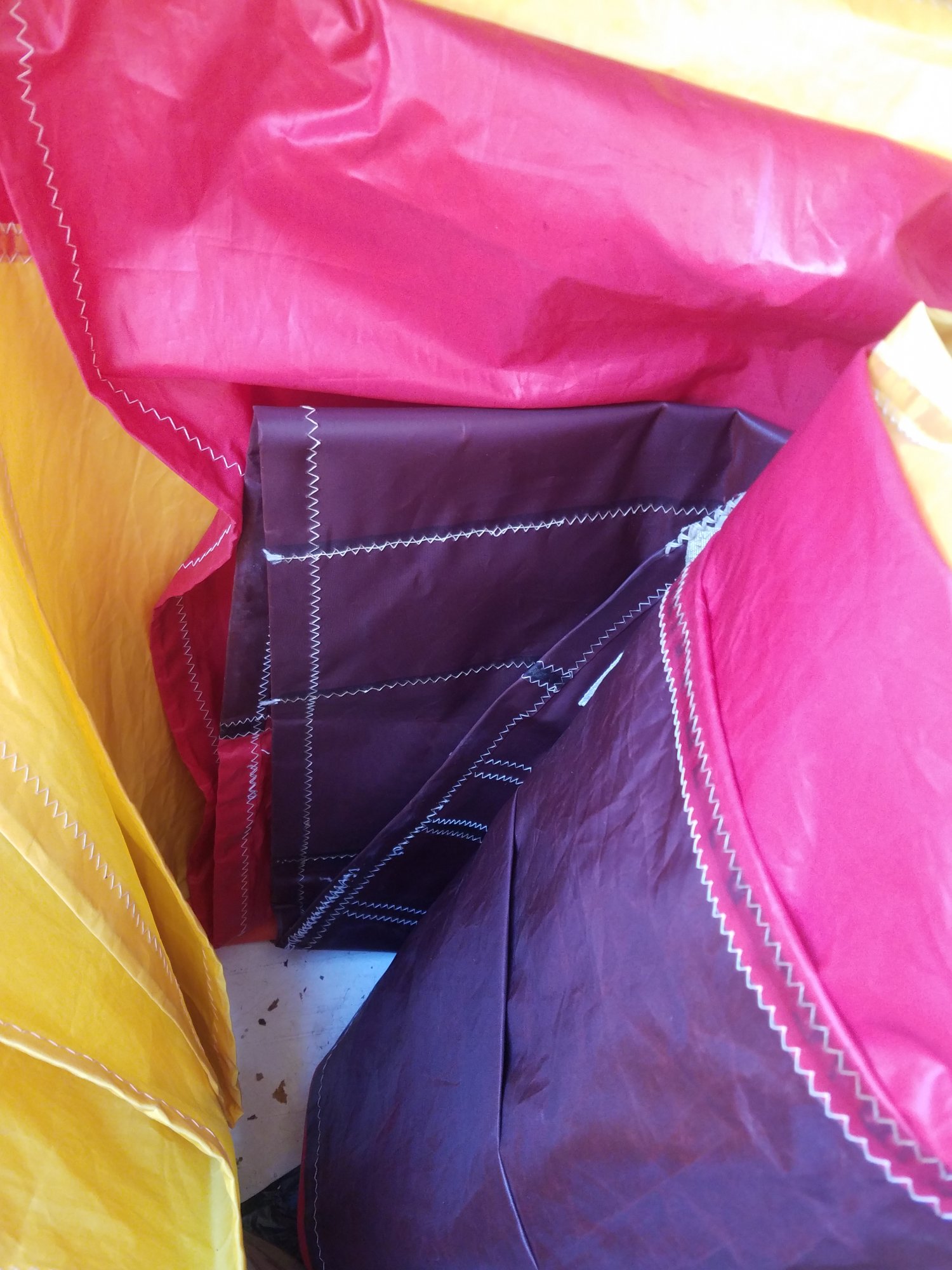

I took my main sail in to Kerr Sails, he cut the the main luff rope so the sail would lengthen as it should. Said it was okay. The jib I think is cripsy ? I wonder if you can tell from the photos.

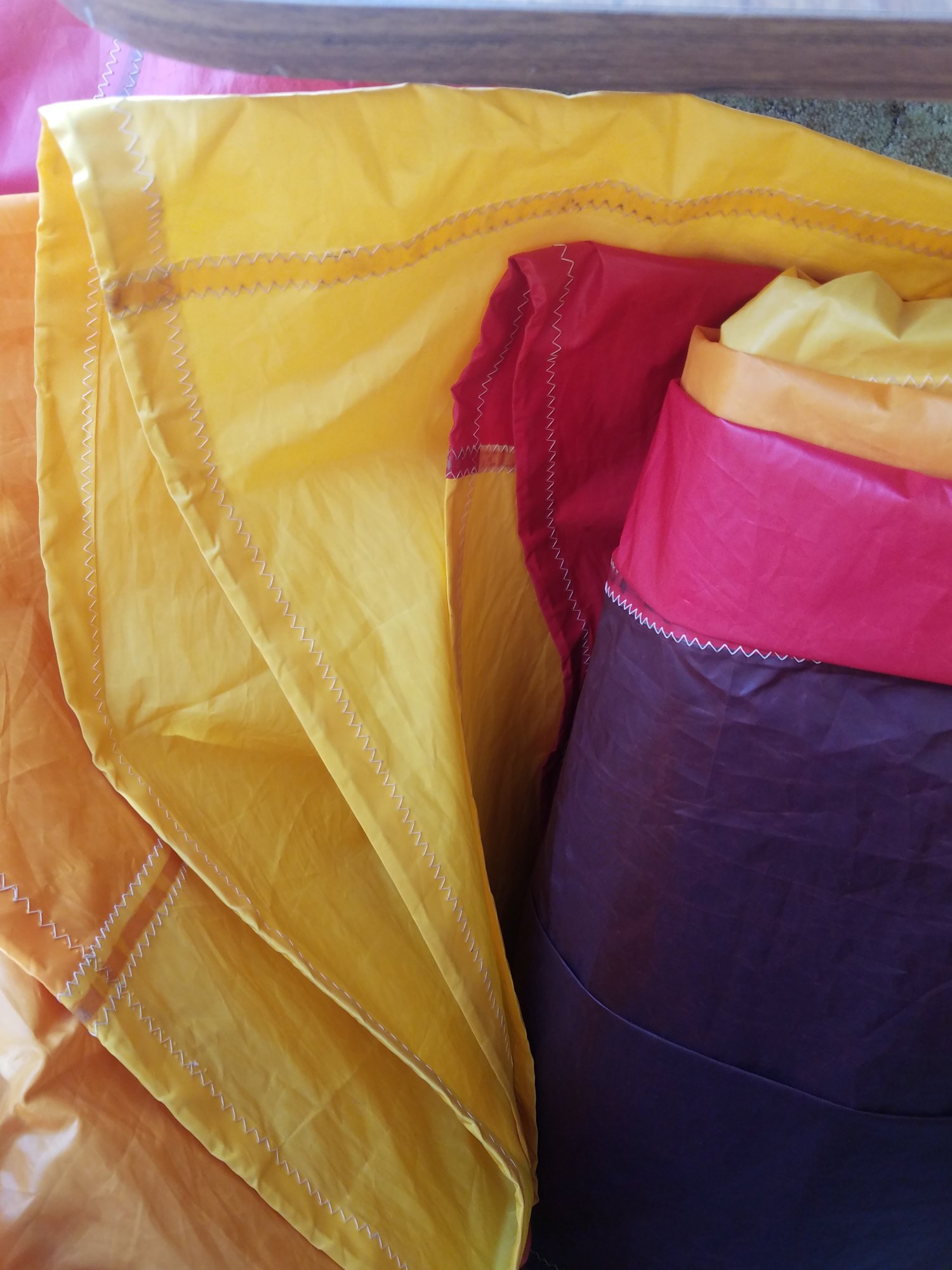

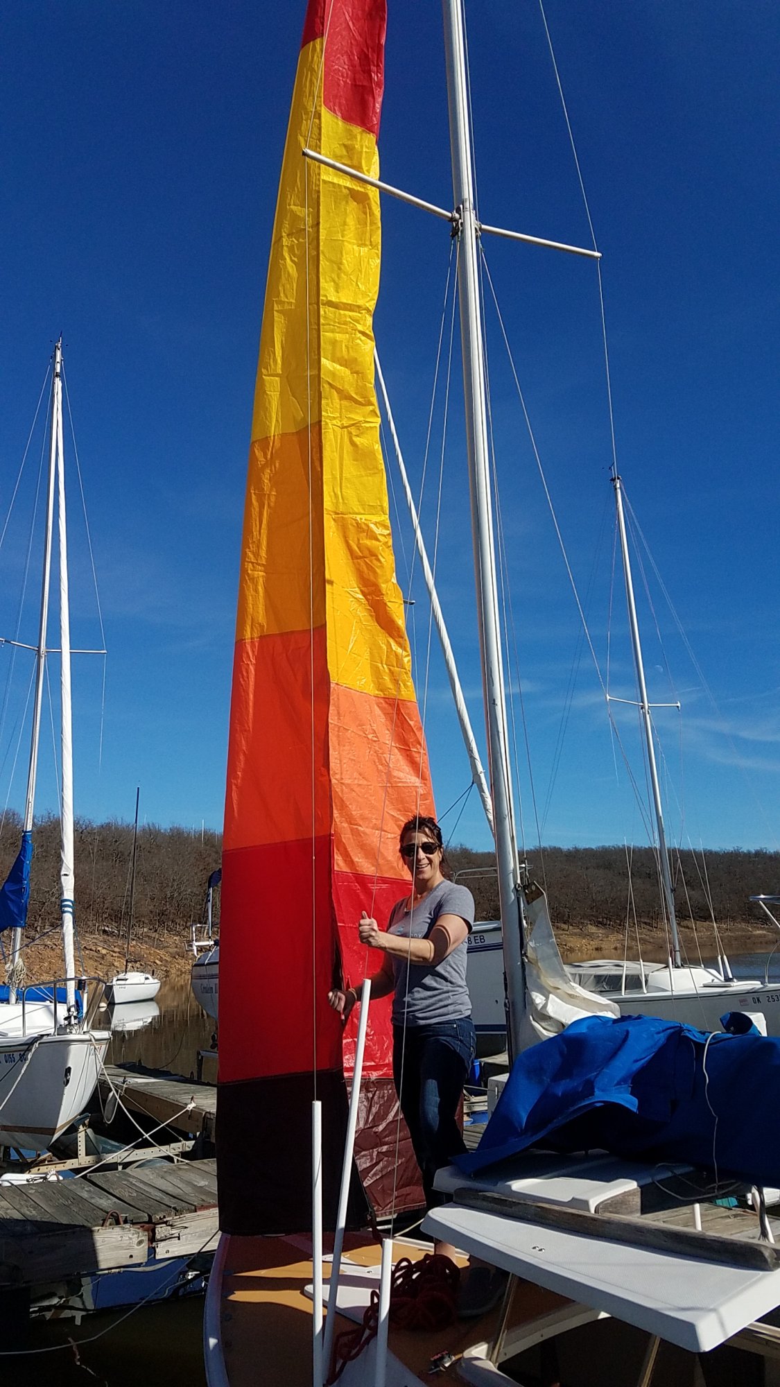

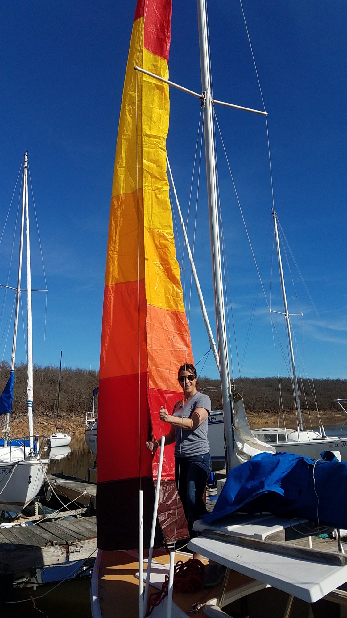

I also attached the size of my jib(4th pic), I guess it is the sail that came with it? The other sail is a storm jib. I wonder is my jib supposed to go all the way to the top? Currently I attach the tack of the jib at the bow of the boat and the sail allows for it to go 90/95% on the length forestay length.

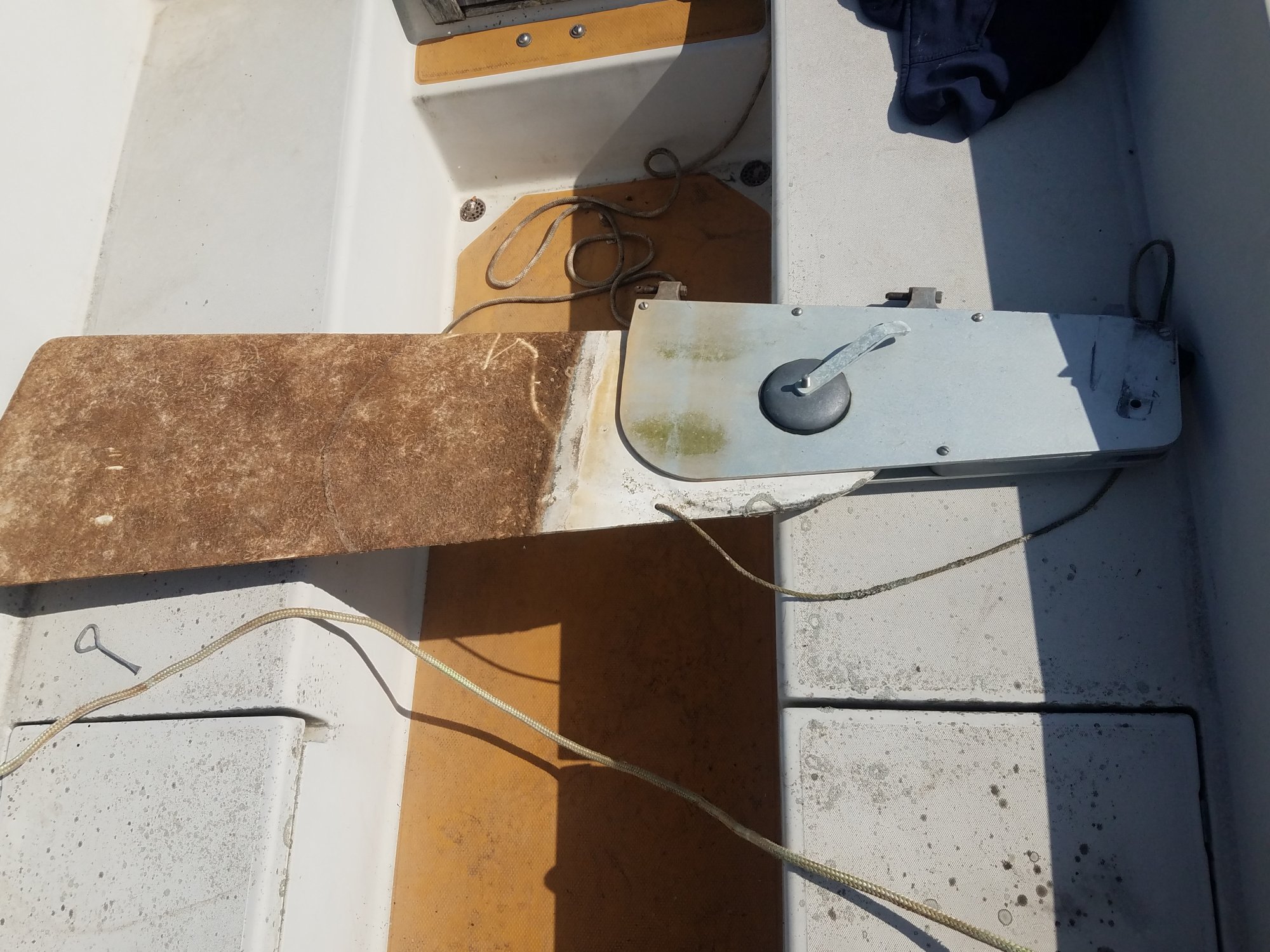

The bottom is beyond dirty. The centerboard is in serious trouble. To win races you have to start with a clean bottom and be on time at the start.
5% up make a difference? serious
