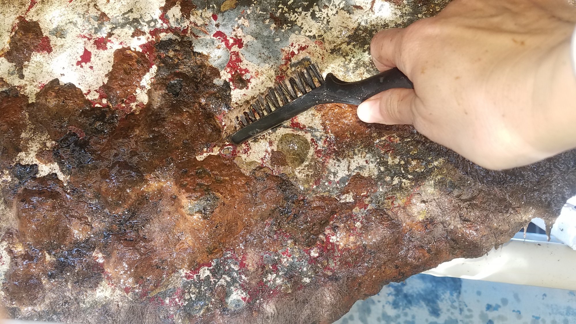

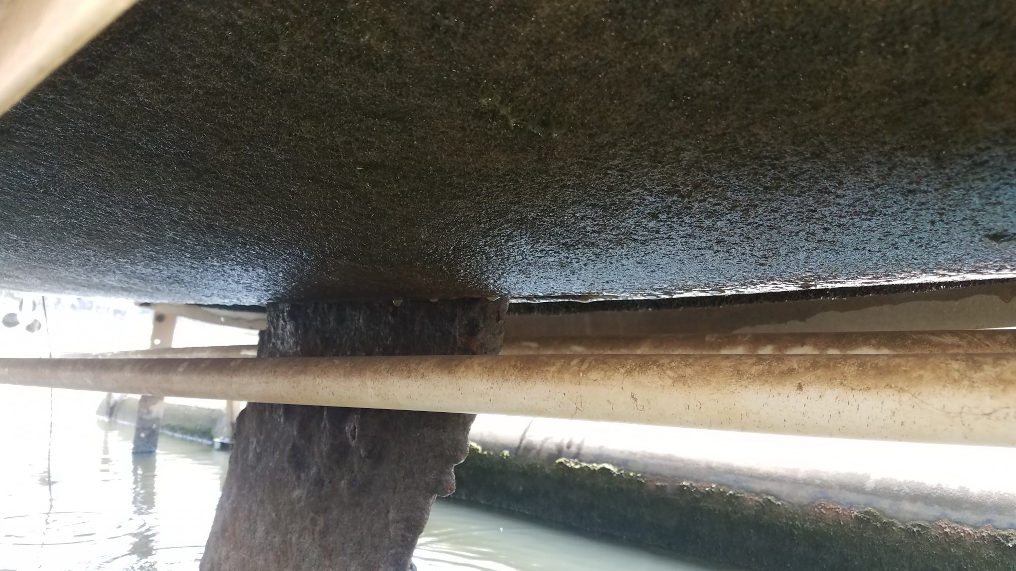

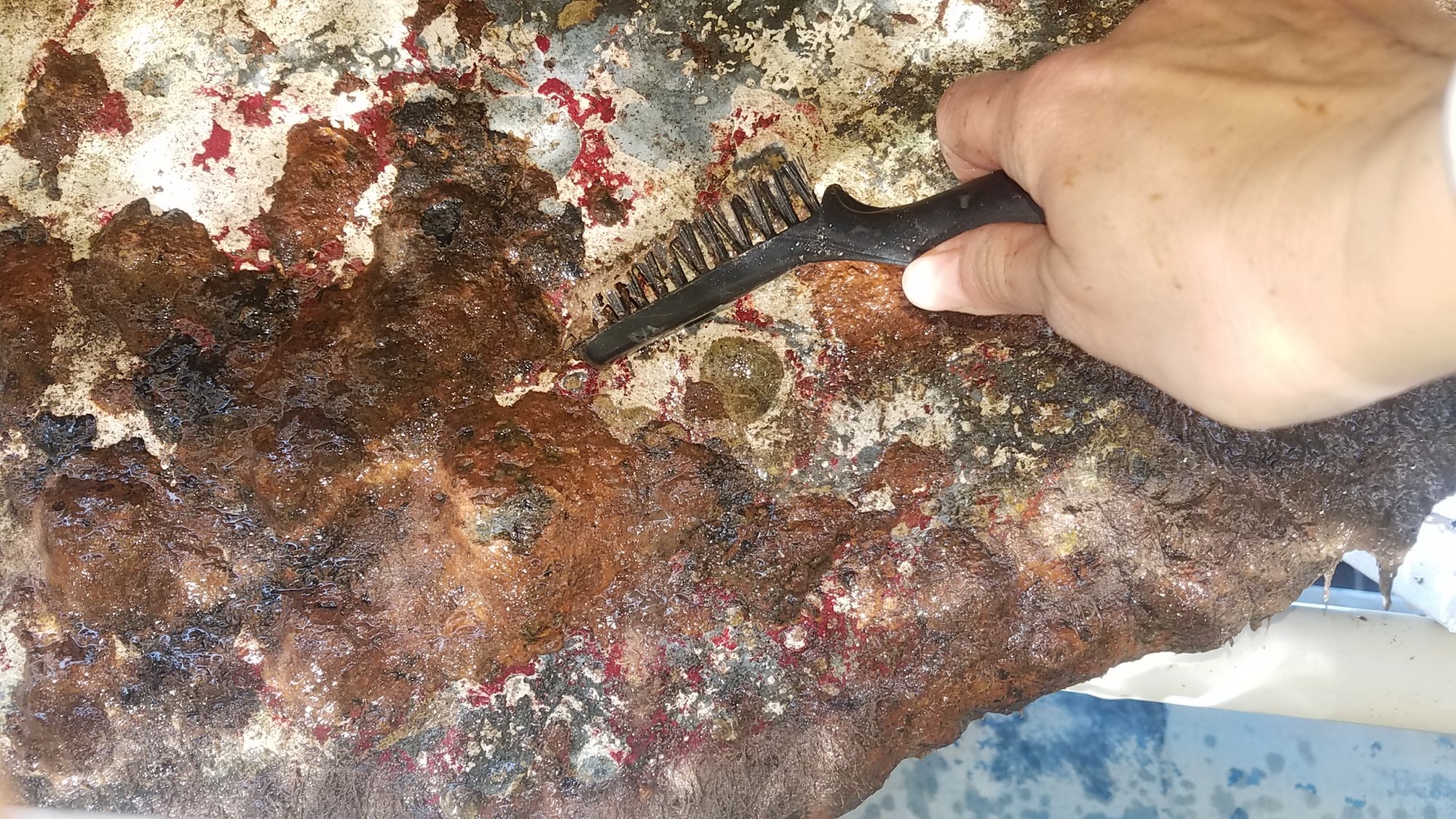

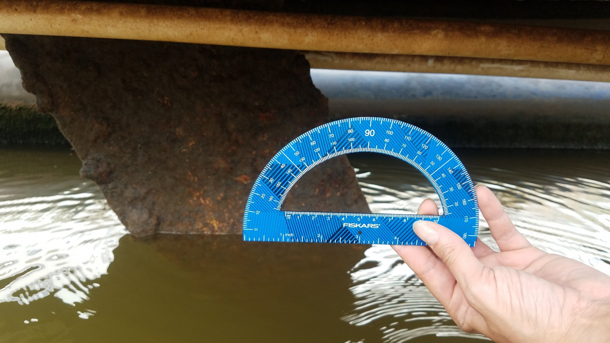

There is small cancer the size off a half baseball. I have pictures of keel angel too.

Heavens to Betsy. Everything that follows is secondary to the fact that the bottom and especially the centerboard of your boat are extremely fouled. The turbulence that creates will make it difficult to impossible to tune this boat properly. All this needs to be made smooth before you can hope to approach the finer aspects of tuning and balance.

I don't think that a bump the size of half a baseball is going to have a big impact on overall behavior.
My advice is to replace or recondition that keel and smooth up the finish below the waterline. Once that is done, find a Cat 22 owner/skipper willing to help you get your boat tuned. Offer whatever it takes - steak dinners, free lawn service, whatever - to get them to come sailing with you and help identify what might be affecting the tuning of your boat.

That keel looks in horrible shape. Probably the worst I have seen on a c22
It should work as a foil/wing. In that condition it will make the boat slow and won't work as intended. It would definitely affect handling
I would be worried that if the rest of the rudder is rusted like that, that the pivot pin and rest of the swing keel system is in bad shape. You don't want it to fail.

Leeward describes it very well. Just as an airplane's wings (and a sailboat's sails) need to be reasonably smooth, so do the hull and control surfaces under the waterline.

As others have noted, that fin is pretty gnarly!!

The bottom and keel need serious attention.

As for the bottom, board, get them cleaned up. Get to work!!

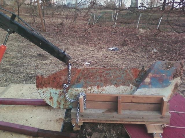

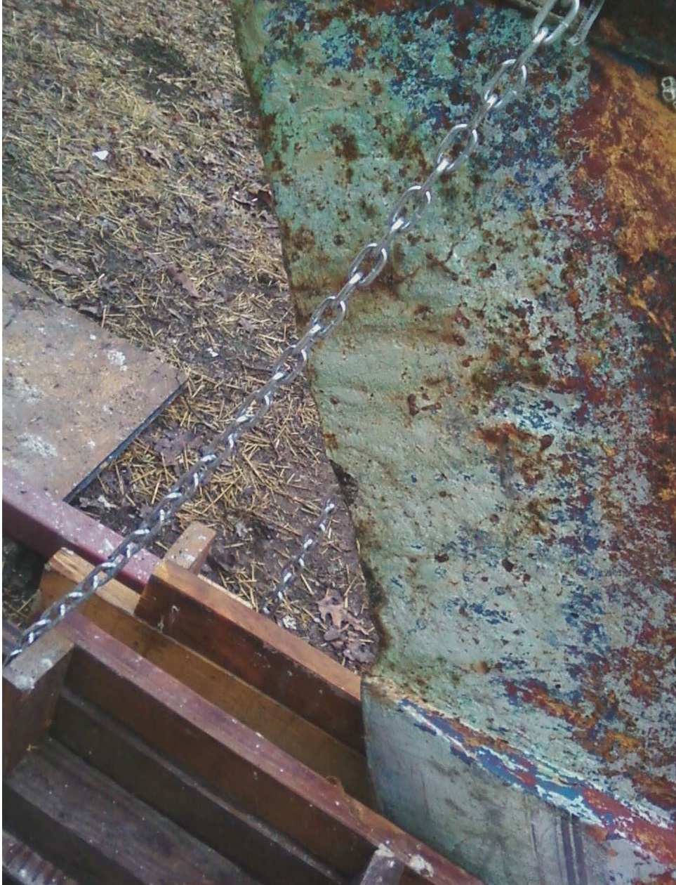

Yikes. Definitely gnarly. I wouldn't sail that boat again until after I'd removed the keel and thoroughly renovated it. There are videos on this process. Also, I'd want to know what the condition the keel bolt is. And probably replace it, based on what I'm seeing in the pictures.
So, I'd start with making the keel look like new, and then address the hull, and move on to the rig and the sails.

Nothing is going to help the problem if that bottom condition Isn’t fixed first.
Yep!

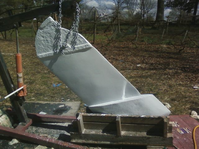

It is possible to restore your keel... If you go that route, there are several of us on this forum who have experience doing this. I've done four (two MacGregor V21s, a MacGregor V2-22 and a Balboa 26)
Before and after shots of the Balboa 26...
