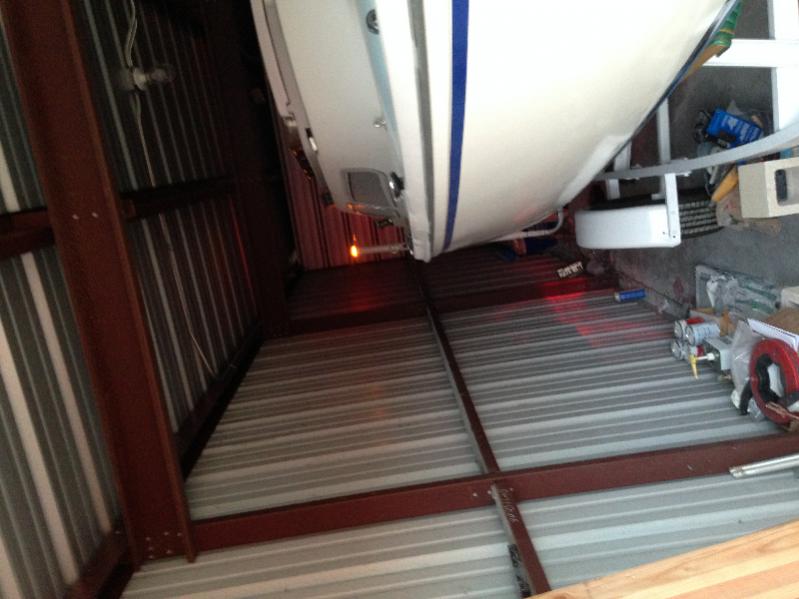

Well it doesn't help that I can only post one pic at a time!
Heading back now to finish the bottom coat tonight so we can keep moving forward tomorrow. Should be able to get it out and take some better pics tomorrow!!

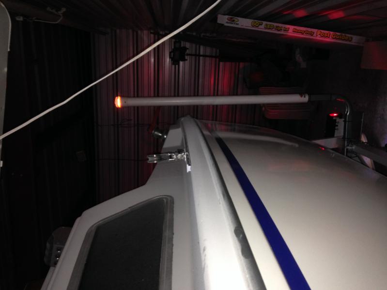

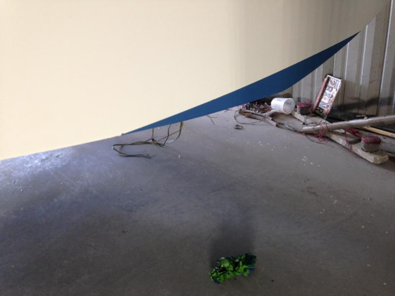

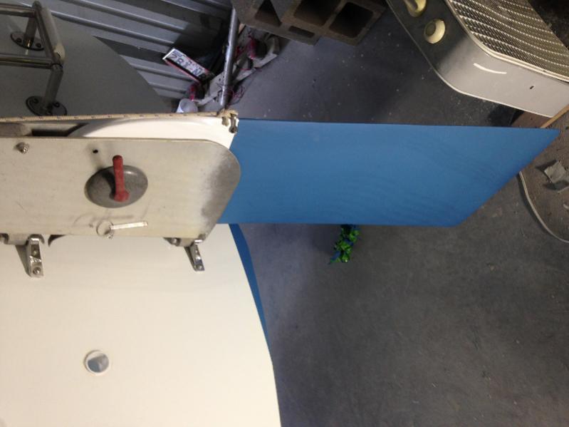

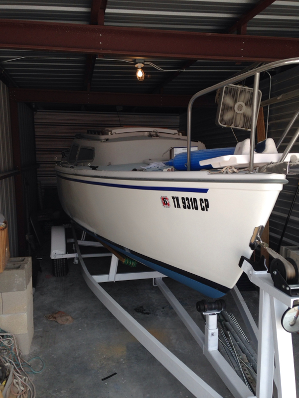

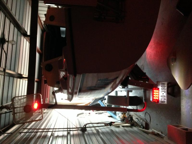

Made some good progress again today. Finished the bottom paint, painted the rudder, finished installing the lighting on the trailer, and got the new mast wiring pulled! Tomorrow the focus will be on the mast, and maybe the on board electrical system.
Should get some pics of Time Out in the sunshine too!
Not how I envisioned spending this vacation, but it's worth it.

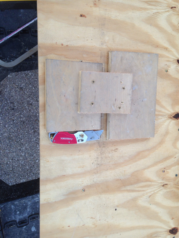

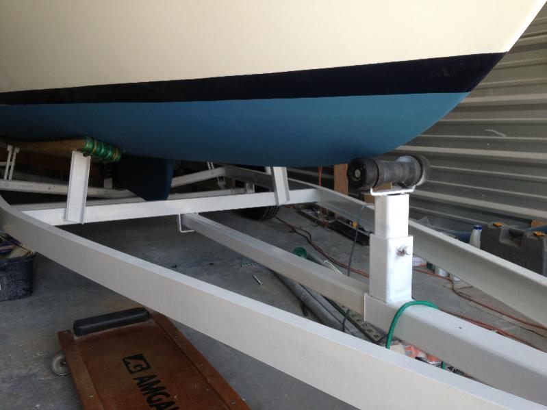

Maybe I missed it in an earlier post, but what are you using on your bunk boards? It looks like you have garden hoses instead of bunk carpet. Is that right or is it just me?
Boat looks amazing btw. Well done. Betchya can't wait till she touches water.
Mar 26, 2012
227
Catalina 22 Pflugerville
Hi Drinkmilk,
Yes I am using garden hose for the bunks. I got the idea from a couple of C22 owners when I visited the Arlington Yacht Club several months ago. I built a jig to hold a utility knife to slit the hose so I could screw it from the inside, with the slit on the downslope for drainage. It works great, at least it seems to be very well cushioned. I don't think I'll ever go back to carpet on my bunks after seeing the damage caused to the hull from the carpet trapping water, rotting the wood, which trapped more water, which started to cause osmotic blistering where the bunks supported the hull.

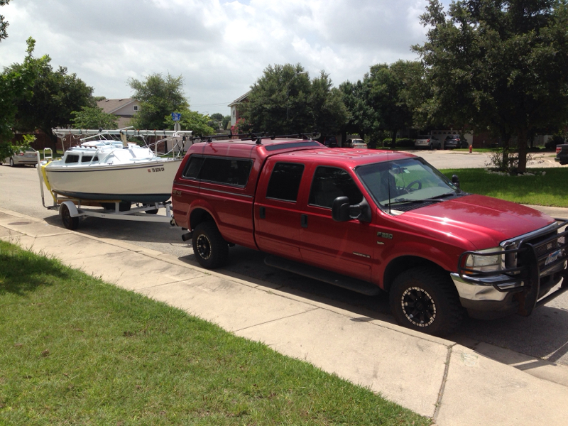

What a day! Fabulous sailing weather, winds 10-15, a little gusty, but that's ok. We chose Inks Lake in Texas for the launch because with the "little boats" our mini fleet of Sunfish and Aquafinns, we had been there a lot. It's a constant level lake, so it always had water even in the worst of the recent drought we saw here in TX. It does have some fluky wind patterns through the opening to the cove where the state park is, but we knew what to expect.
It took a lot longer than expected for everything! Loading, making the boat road ready, stepping the mast, rigging the boat, loading afterwards, everything! But seeing her float off the trailer, then at the dock waiting for us to board, cast off the lines and go sailing was absolutely wonderful! And the little 2.5 hp air-cooled outboard that came with the boat worked great! Started in 1-2 pulls every time, and was able to move the boat around just fine. I know it isn't big enough to handle it when conditions turn sour, and I'm planning to get a Sailpro soon, but it worked, and I was thankful for that!

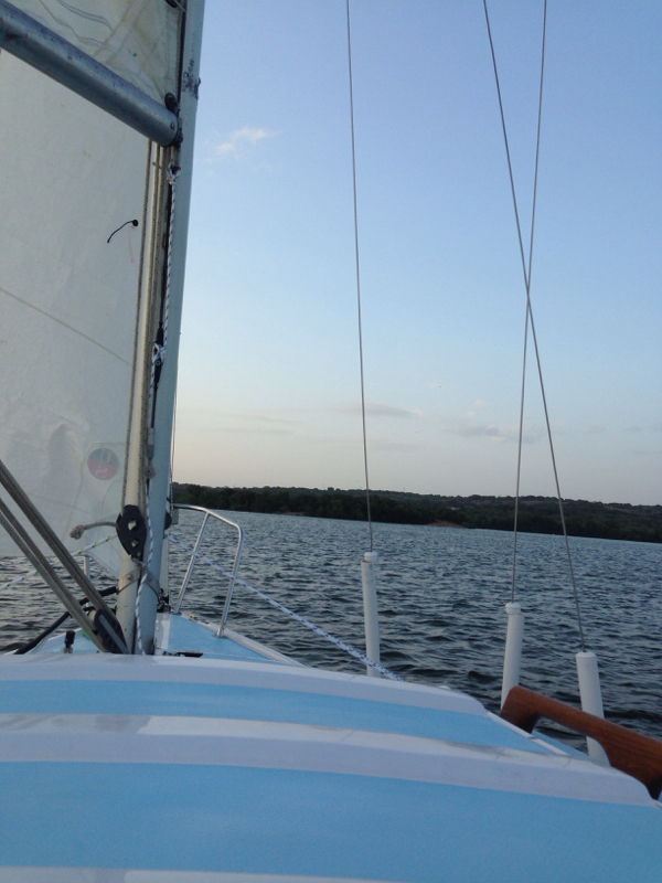

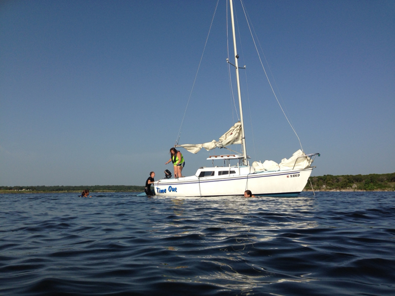

Yes, it's been a while again since I've updated this thread, but I have pictures that include water!
We have had Time Out to three different lakes now, and am loving sailing her as opposed to just being "boat slave!"
But I must say, it drives me crazy to see all the scratches she's getting.

Edit: Great photo BTW. I love the perspective.
