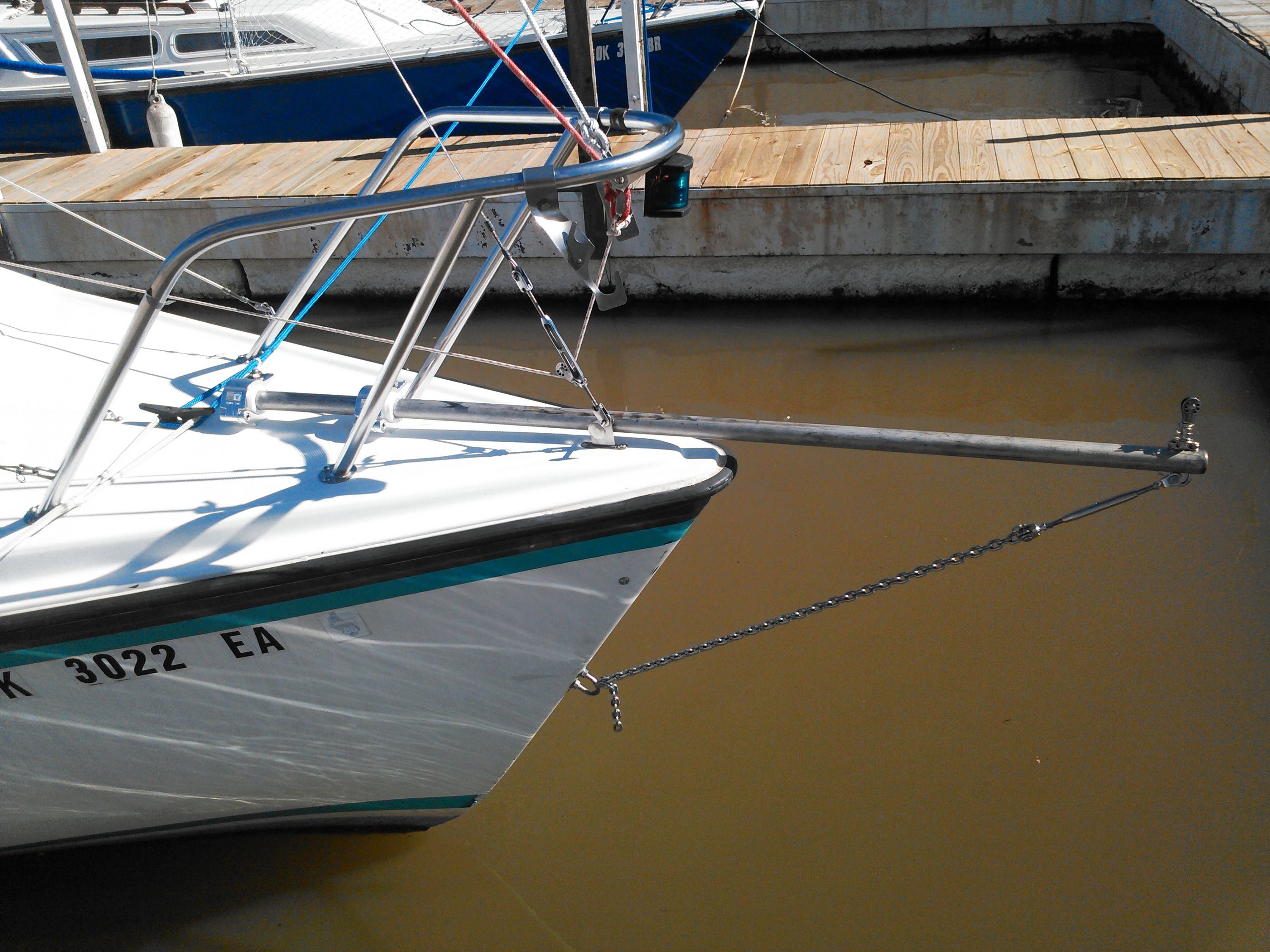

Added a bowsprit to my boat this past weekend in hopes of learning to use a spinnaker.
Today, I took advantage of the extra hour of daylight by stopping by the boat on my way home from work and went on an evening sail!

View attachment 120624 Added a bowsprit to my boat this past weekend in hopes of learning to use a spinnaker.
I've been considering adding a bow sprit to Miss Behavin'. I'm anxious to hear how it works.

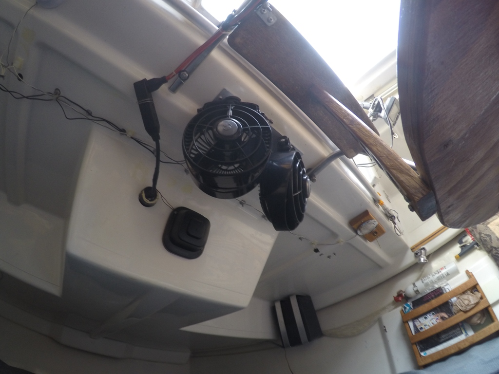

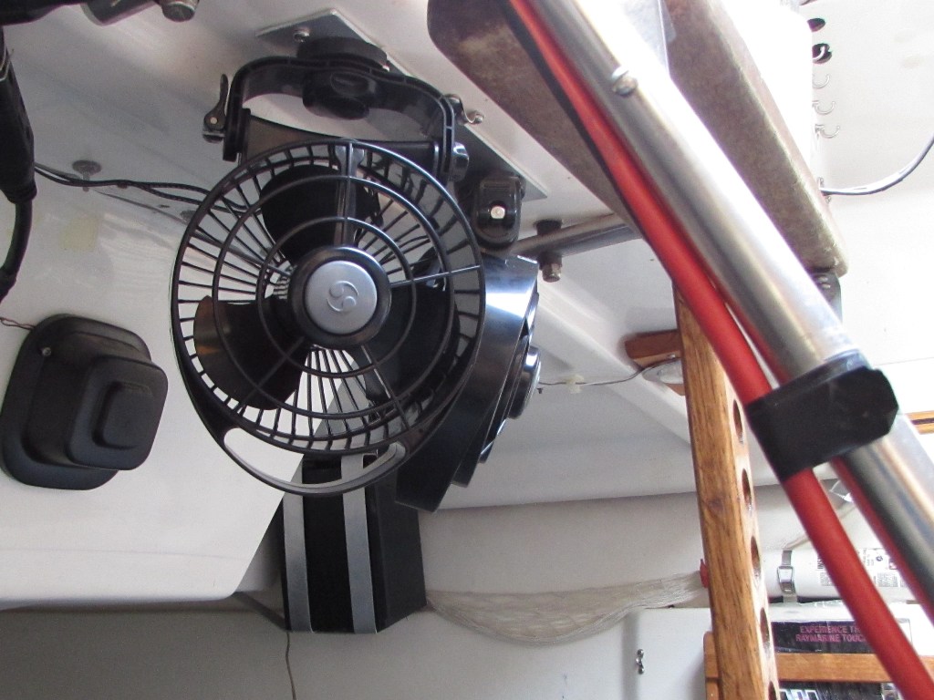

I receeived these fans from SBO http://shop.sailboatowners.com/prod.php?1209 and this is where they go. You can point these to either cool the seat location or point them towards the bed (2 axis of rotation). The current I measure matches the spec of .16 amp on low, .2 amp on medium and .27 amp on high. I think the low setting will be fine especially since there are two fans. Running both fans on low will consume 2.4 amp hours for an 8 hour night - or half that if only one fan is used. So my two golf cart batteries fully charged will last more than 41 nights before being half depleted. So far they seem to work well. I've been trying to keep that aft sleeping bed as open as possible (I need more room as I get older) and the fan location moves plenty of air plus they are completely out of the way for sleeping space. I still need to clean up the wiring but the pictures show where the fans ended up being located.

Very nice Walt. I've tried a few different fans but haven't been satisfied with any of them yet. I'd be interested to see how well they perform. Do these fans work quietly or do they vibrate and make a lot of noise?
Those look like nice fans that Walt got here. They also have Caframo fans here.....
http://shop.sailboatowners.com/prod.php?1208/Sirocco+Model+807+3+Speed+Fan
More expensive but I sure like them. Also extremely low amperage draw. I've used them extensively in Florida and the Bahamas and love them.
.. I have one mounted in the V-berth in the Mac and it cools both people and I've never had to run it on any speed other than low. I have another mounted in the V-berth of the Endeavour with the same results.
One nice feature they have that works very well and also saves the battery is that there are different timer settings where it will turn off after 2-4-6 hours which is hand as a lot of times after 2-4 hours it has cooled down to the point where you don't need the fan any longer. I use that feature about every night.
With the gimbal mount they point in any direction you want.
I also have a couple of the ...
Caframo 2 speed fans that I use in the cabins of both boats....
http://shop.sailboatowners.com/prod.php?1211/Ultimate+Direct+Wire+Model+757+2-Speed+Compact+Fan
They work well and I just move them to where I need them. The base is a little different than what is shown above and they sit about any place you set them. Not sure if the ones here are for permanent install only??
The Caframo's seem to be the fan of choice of most full time cruisers. I haven't regretted buying any of them and have more about them here on my site...
http://purplesagetradingpost.com/sumner/macgregor2/inside-31.html
Reasonably quiet and they dont vibrate. I can hear them running but think they are completely reasonable and I should sleep fine. Unlike the last small space heater I bought.. so loud that I cant use it.
.. Sumner, I dont know if you missed it but he Bora 748 (that I just installed) is also made by Caframo. Been running it more today and comparing it to an old fan, the Bora 748 puts out more CFM for lower power and noise and is a lot smaller. Seems great so far..

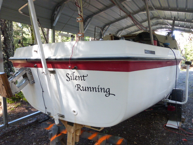

And she was christened "Silent Running" today as well.
Greengas. If you look back a few pages here you'll see several of my modifications, but I'll also take an overall interior pic for you here shortly. We love our "new" 25 and I'm sure you'll love yours as well. great boats!!
