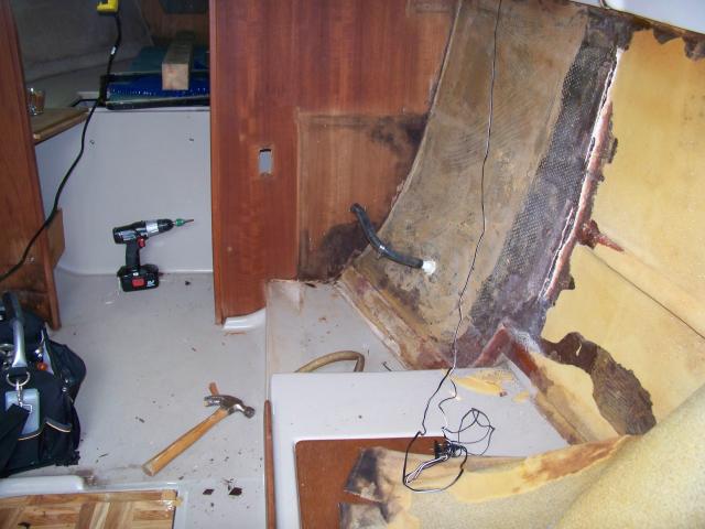

Ed, do you think i need to drill so many holes, or just remove all the stanchions, chainplates, etc, and allow to dry? Then should i fill with epoxy, or gitrot?
I have just about finished removing shelves and bulkheads. then I will grind off the remainder of the bulkhead tabs, and the liner backing. then, once the interior is tore out, i will remove all the through deck hardware. then carefully inspect the deck and repair or fill as needed.
I carefully label the origin of each part removed and attach the hardware to it's part in a baggy, also labeled in case it gets separated from it's part. I intend to get my cabinet maker to reproduce the wooden componients for me, saving me a bit of time on the reinstall. Also his finish work will be much better. I may laminate the bulkheads, but must keep in mind the width limitatioins, I may have to settle for paint on those. But I will trim with the teak wood, This should look nice: white bulkheads will brighten the interior and make it feel larger, giving it a classic look.
We shall see....
Oct 2, 2008
1,424
now with forward bulkheads out. At first they wouldn't budge. But i noticed that they were wedged in by the trim pieces once i removed the trim they slid out easily!

Keith,
I just saw your pictures. I will reply in more detail when I get a chance.
RBone is offering good advice. A 26 is essentially a modified 25, 10 inches longer. So if he solved similar problem then his advice chould be good. I have no recent experience with that volume of the problem. My problems were always much smaller. But now I will go back and re-study past issues. Your discovery is making me take second looks.
Yes, I used a sharpie pen with baggies to label everything that would fit in them. Then blue tape with labels for bigger things, even if they were obvious. It expidited reassembly.
Is top of boat under tarp? Get heaters going in cabin today. I see you have electricity. I used two small space heaters at moderate temps for weeks on end.
Take all hole plugs out to facilitate air flow.
Appleman is a great resource. Does anybody know the other guy who gutted and rebuilt a 26 before Appleman. You need all the advice and directions you can get.
When making the new port bulkhead, since you have damage where you need accurate template for bend in hull, unless you can get exact measuremtents make a template to prove fit before cutting plywood of new bulkhead. Go to paper store and get big pieces of hard carboard to make prototype.
I cannot make a recommendation of the cabin top issue that I am comfortable with at this time. RBone and Appleman would offer better advice. All I can say is kill mildew and dry out. This may be achieveable without too many holes. I do not know answer.
Does anybody know of other internet list that have experience with solving this issue? In the degree and volume presented here?
I have a friend who does this stuff for a living. Just saw him yesterday. May be a week before I see him again. I will try to pose question at that time.

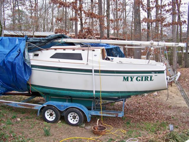

Good info, I have mygirl under a good tarp and is keeping the boat dry. I have removed all the inner liner and ground and scrubed the inner hull. It looks good. i will add detail and pix to that task and post it later when it quits raining. MY next step will be to turn my entire attention to the deck and fitting. I will start at the pulpit and work back, addressing deck-issues as I go. Now that i have the interoir cleared out, many task should be a little easier as i have few obsticles to work around. Later i will go back to the enterior and refinish and refitt. If you could ask your friend about the project, and drilling holes vs cutting skin to dry the deck that would be great.
One website among many i have found helpful is: http://t30makeover.com/id7.html
I am thinking about begining a new thread involving the makover of my oday 26, I would start with Pix of the problems that prompted the makeover, then post some sort of periodic updates of problems encountered and ways they were solved, tools used, detailed pix, etc. Hopefully getting lots of advice and counsel as i go. Then anyone later doing the same thing could come to the posts and follow the threads and get some help. Do you think this is a good idea. or should i just keep it in this thread?
