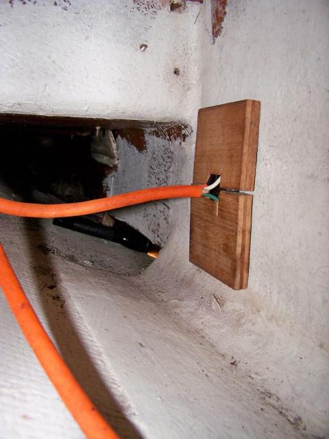

Hi ed K
I got all under the bins but just cant see into the area. i can see that there is a gap there. in the pictures you can see how small the space is. The pic is made with the camerea sitting right at the area. However, my hunch is that the floor sits on a reinfored area that runs athwartships. That area is solid. the sole may be alittle soft. I took another picture of that along with pics of the bulk head. there is some rot in the bulkheads where the bolts for the shroud stays attach. I thing the bulkheads have to be replaced completely. Dang...

Hi ed K
Here are the pictures i took the last photo is the deck, at the mast, with the tabernacle and mast plate removed. not the sunken in area

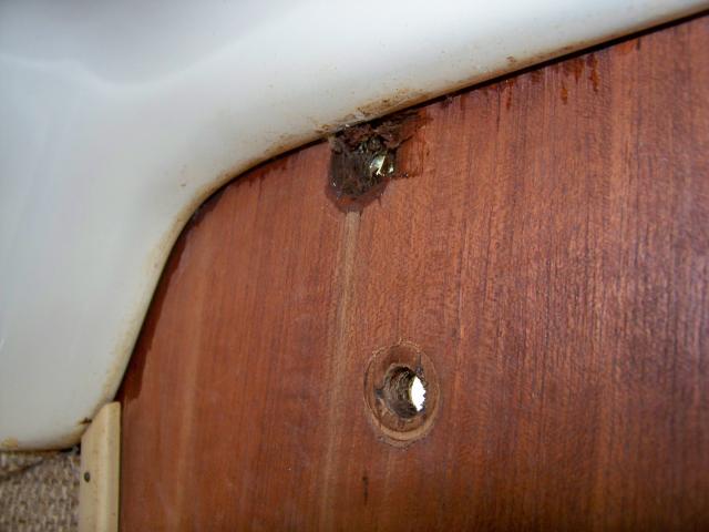

I am very encouraged about the boat. :) I took the port chainplates loose yesterday and it appears that only the first two bolt holes are soft, (second phot) the rest are ok. also along the base is almost completely solid. I will get a plate made for the bolt heads on the aft side of the bulkhead (last photo). After I get the wood dry, what do i do to make the wood solid again? I have heard there are ways of doing this. I will search the archives for that. Or if someone wants to comment.
What are the recomended ways of reinforcing the bulkhead?

Oct 2, 2008
1,424
thanks ed, good info. Can the epoxy be applies with the bulkhead inplace? how do i keep it from running down?
Your are right about the area under the chain plate covers. The wood in the core in that area is rotted. I got out what i could with the drill/nail. the rott probably extends beyond that area. I plan on filling that with epoxy. How do i cut out the area for the chain plate when the epoxy dries. there. since it is rectangular, i cant drill it. Do i use a saw? Or is ther something you put in there then remove when the epoxy filler is dry?

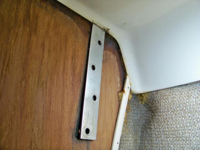

I just want to point out that I never had rot in my bulkhead or any of the problems that you need to address, but I do have the same chain plates on my O'Day 222 as you have on your 26. What I did was beef up my main bulkhead with oak, and had stainless steel plates made up and welded to my chain plates to keep out moisture. The oak is bolted to the settees, and each of my welded chain plate covers is bolted through the deck with backup plates in the cabin.

Joe, the chainplate weld is a geat idea!
Is the first picture of the cabin made before the oak was attached? The modification appears very strong.
My 26 has a small plate that the chain plate passes through. it is just attached with screws to the fiberglass. And it is sealed with some sort of caulk. It peeled off easily. This appears to be a difficult area to keep sealed.
I believe that i can reinforce the bulk head by having larger steel plates made and attaching this to both sides of the bulk head, similar idea to the oak plates you had made. Have you heard of that being done? I would like to see more pics of different ways to reinforce a bulkhead. Hopefully others will bring up ideas as well
